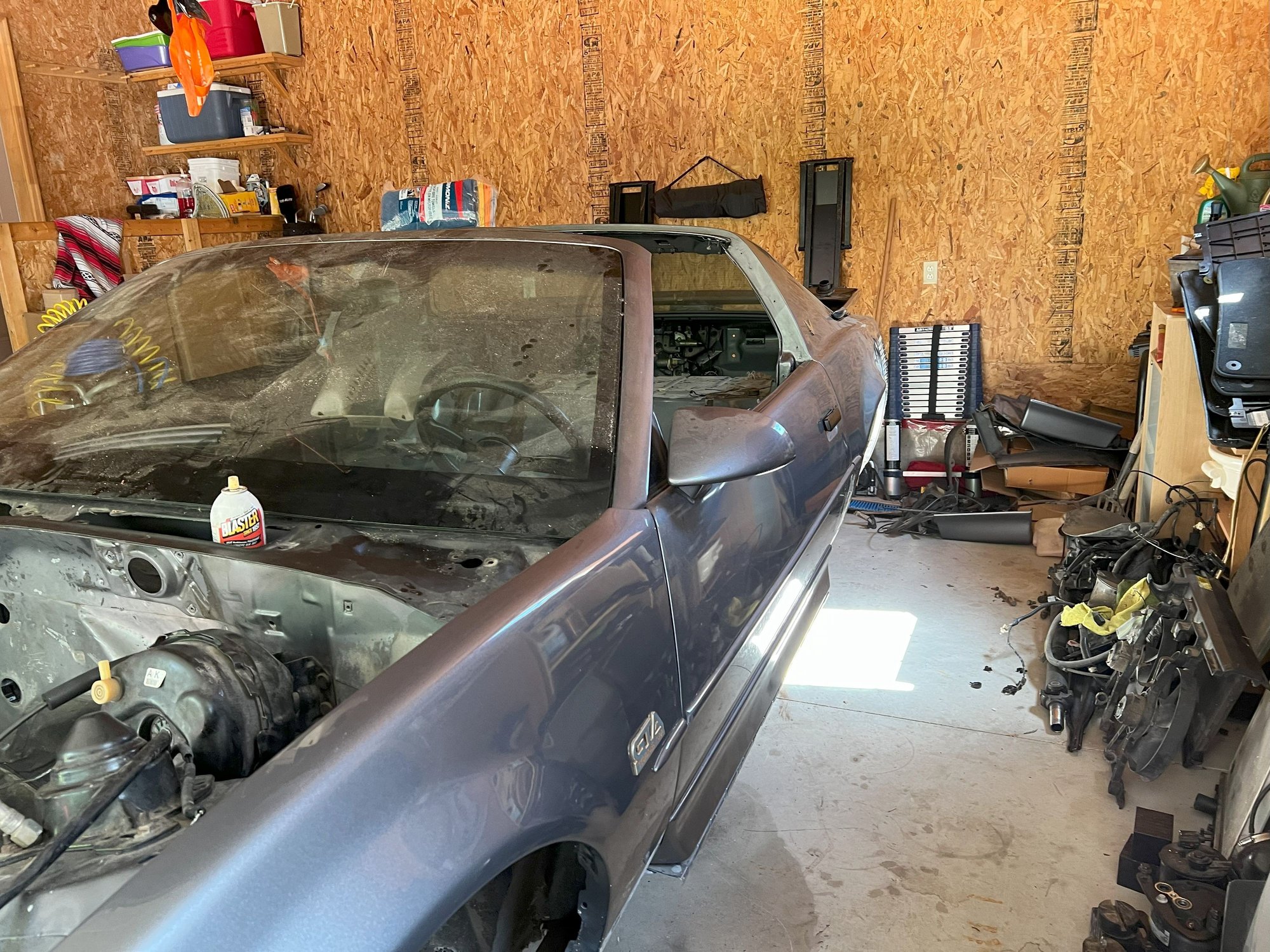

Warning, - Picture heavy...
It's been a long road for me to get to where it is today.
I've owned a firebird since 2004 and this was the third one I have owned. This will be the last thirdgen I own so I figured I would do it right before I dig into a 78 Y88.
This one has been almost 5 years to get to this point with work, life and money getting in the way.

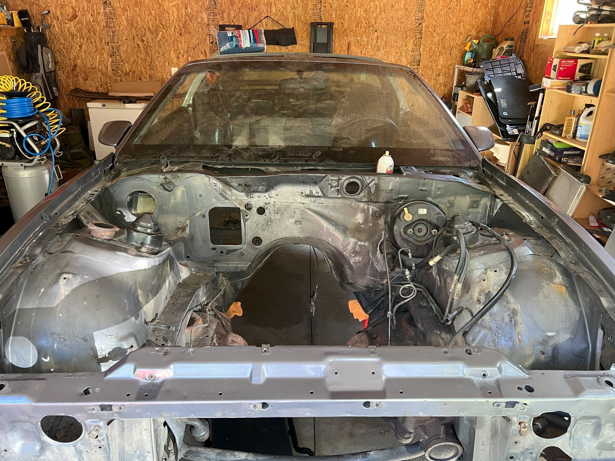

What I would like to ask is what are the next steps?
I am thinking that getting the rest of the metal work sorted out before I move into some sort of paint work is the right step.
Looking for recommendations on what to do next.
Pros and cons for doing the paintwork in pieces (underbody, engine bay, interior) then starting reassembly to get it mobile again before going to finish paint.

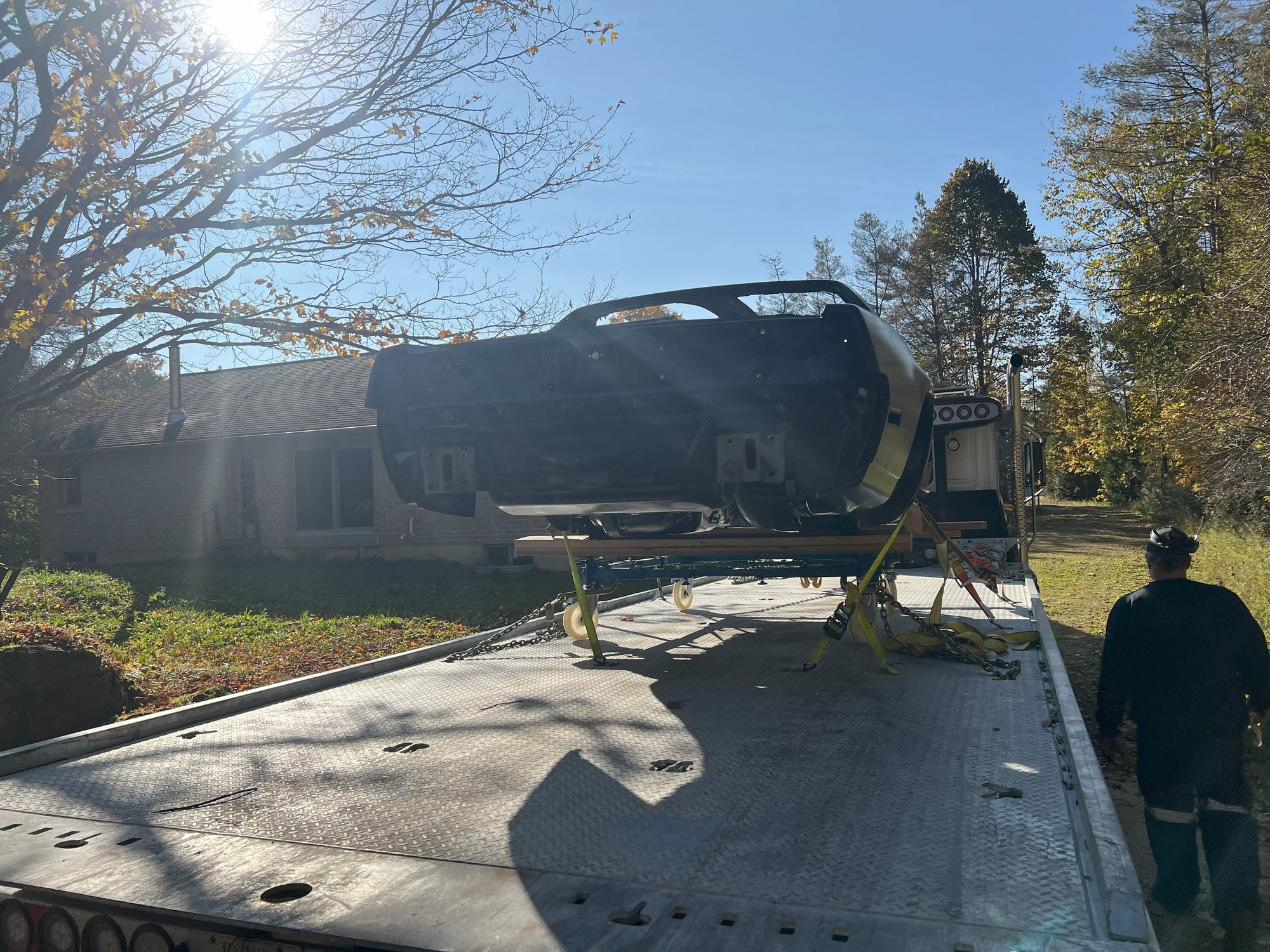

More in the next few posts. Picked up the car in late fall of 2019 for 6500cdn.  Had 10 previous owners and at least one garage paint job.  T-Roofs were leaking so I decided it was time to start replacing the old weather stripping.  At which point I was not ready for what I was going to find...

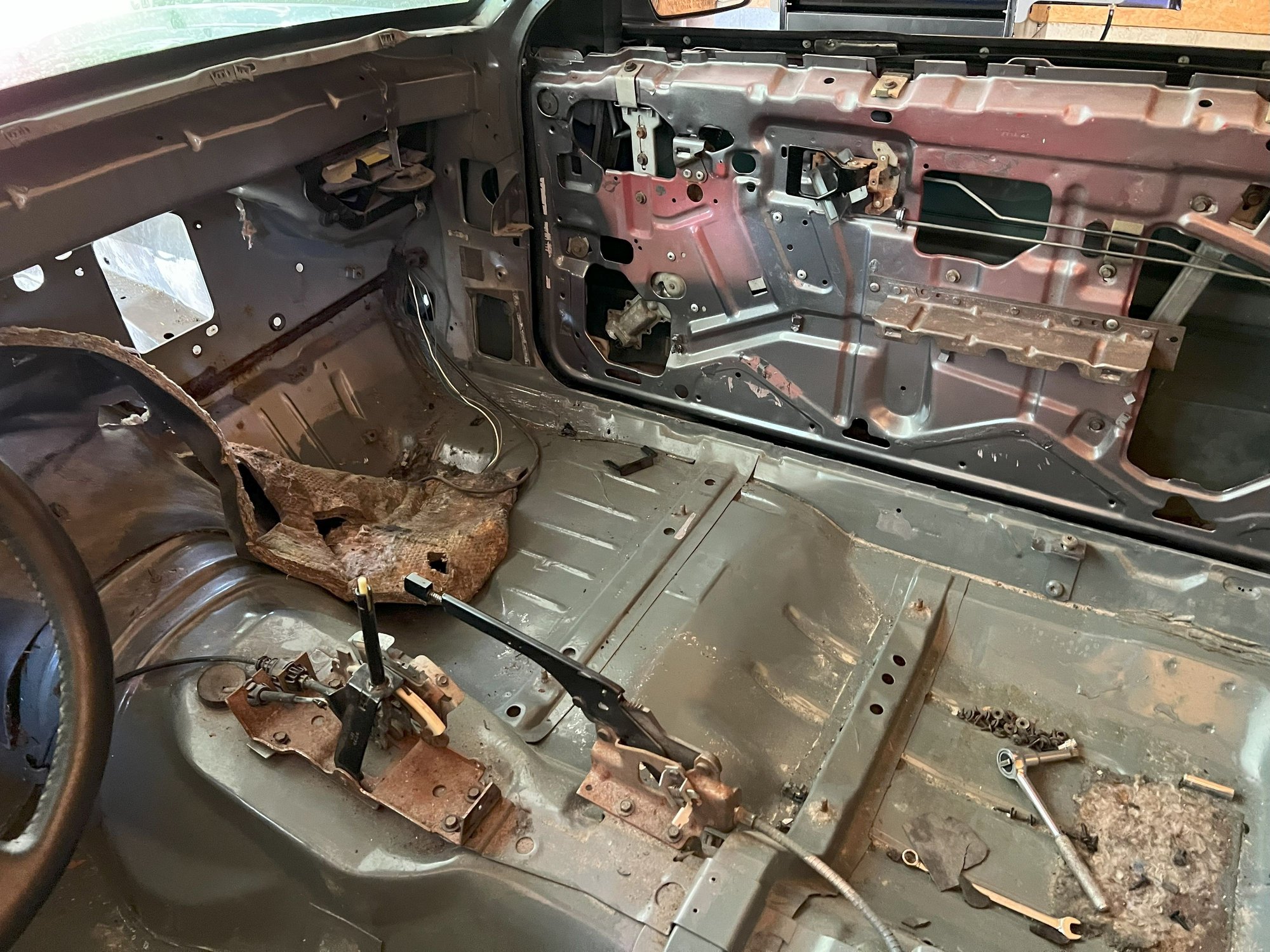

Tearing everything apart to find all the rust and other corruption thats happened to this car over the years...
Tearing everything apart to find all the rust and other corruption that's happened to this car over the years...
One of the many patch jobs done on the floor that was now visible after removing the transmission.

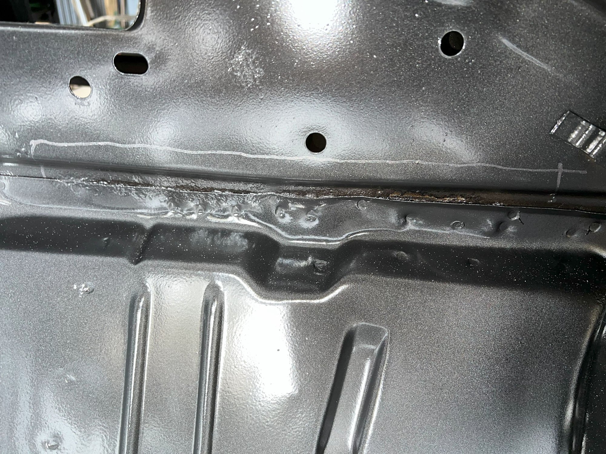

Overall metal work is in great shape.  However after blasting, it revealed that the front upper fender braces were replaced and numerous other
Overall metal work is in great shape. However after blasting, it revealed that the front upper fender braces were replaced and numerous other "backyard" patch jobs were done over the years.

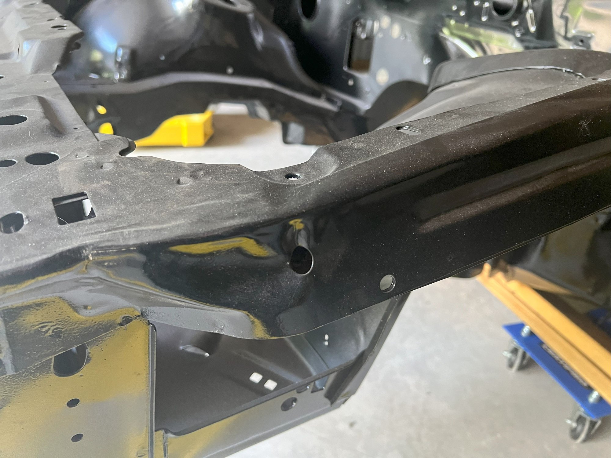

Once it was blasted, returned to my shop with a fresh coat of epoxy primer.

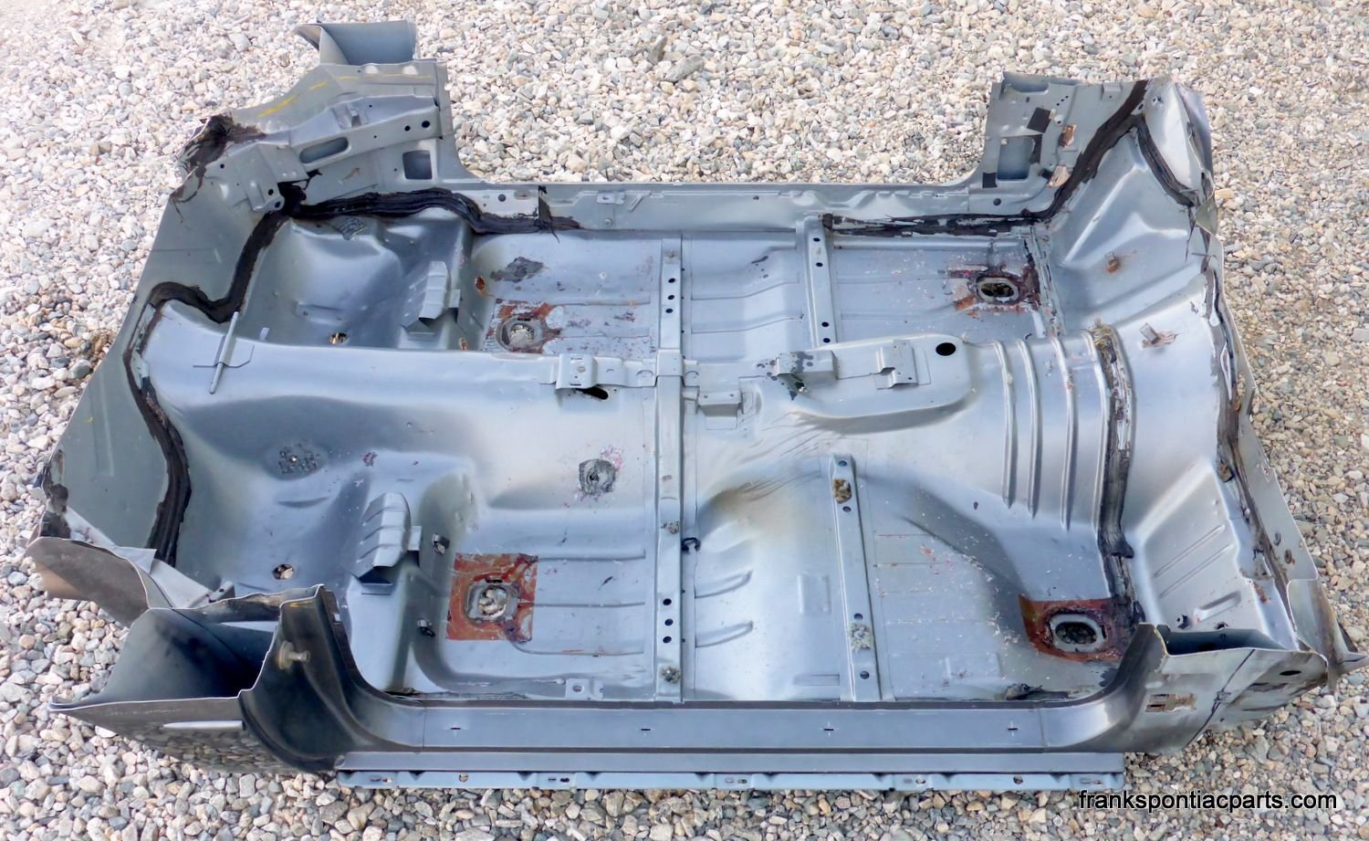

Ordered a floor pan from an 88 GTA, (gunmetal grey too!) from Frank's Pontiac Parts.  Great people to deal with.

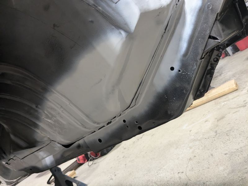

Some weird damage in this area.
This is what the previous owners patched in.  Whoever did this, should have their tools removed.

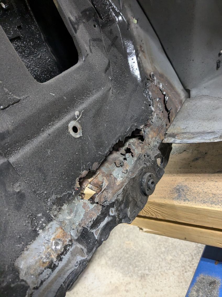

One of the rockers (pass side) wasn't looking too good.

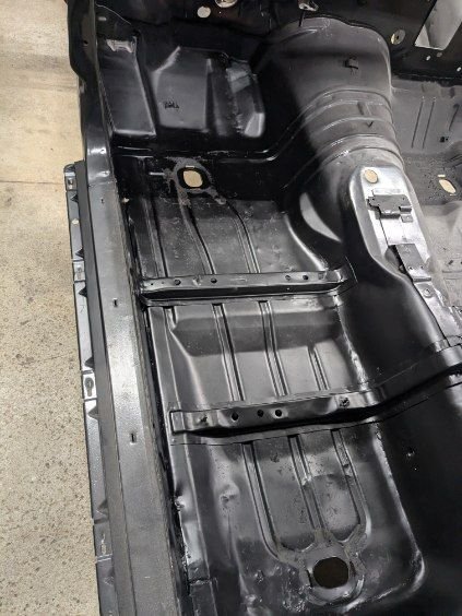

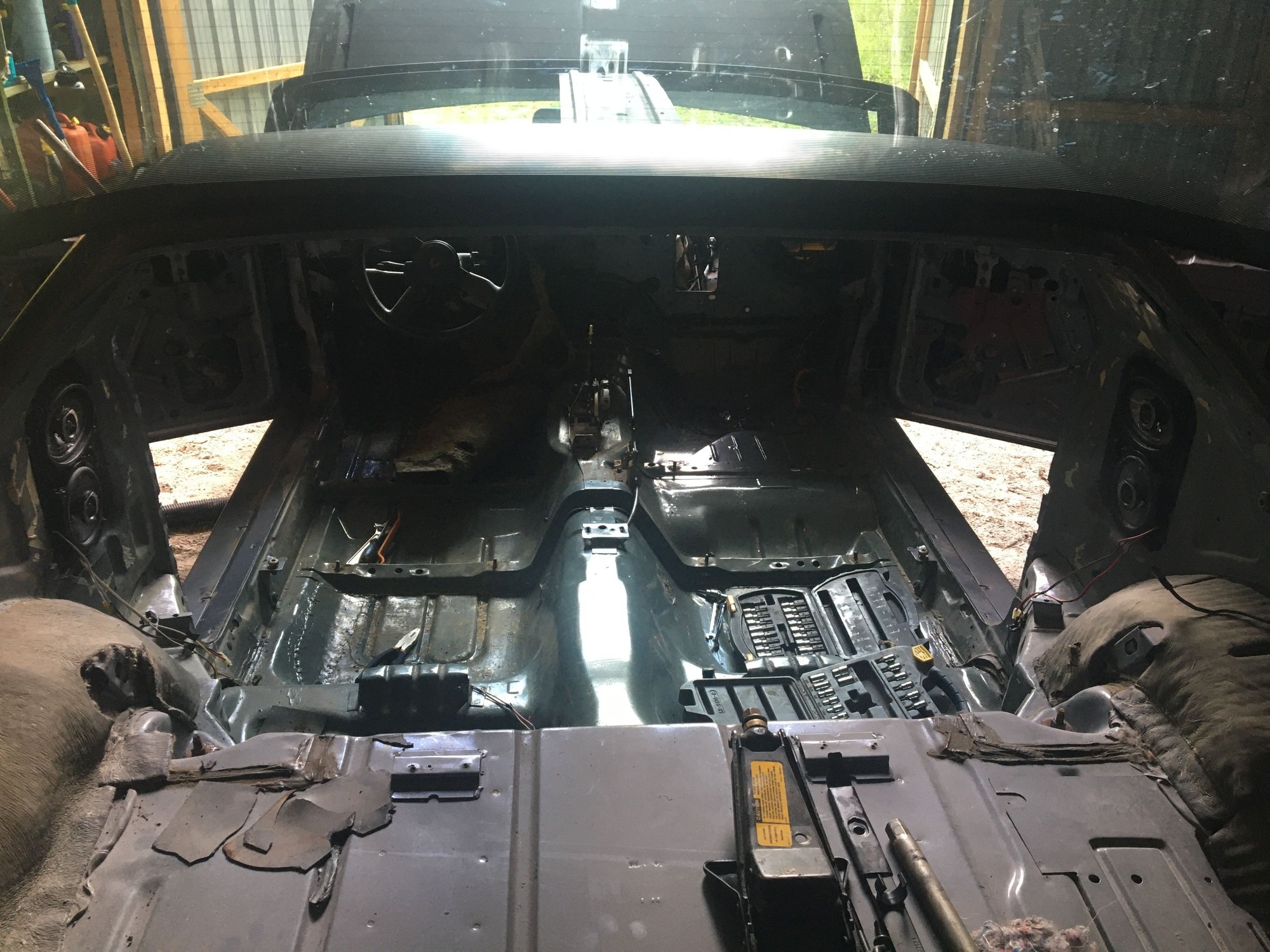

This was the condition of the patches that were done on the original floor.  Whoever did this should have their tools taken away...
Rather than try to individually patch each section, it was better to just do the entire floor.
While digging into the floor we found that the inner rocker was also heavily damaged.
This was likely due to the front of the rocker being eaten away and allowing moisture and other junk to get in.

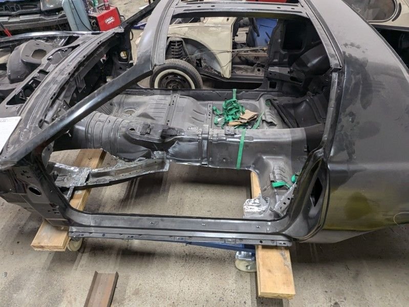

"new" floor pan prepped to go in.
Test fitting.  The rear seat rail made it very difficult to fit the replacement pan in, so it had to be removed in a section to make it fit.
Tacked in.
Tacked in.

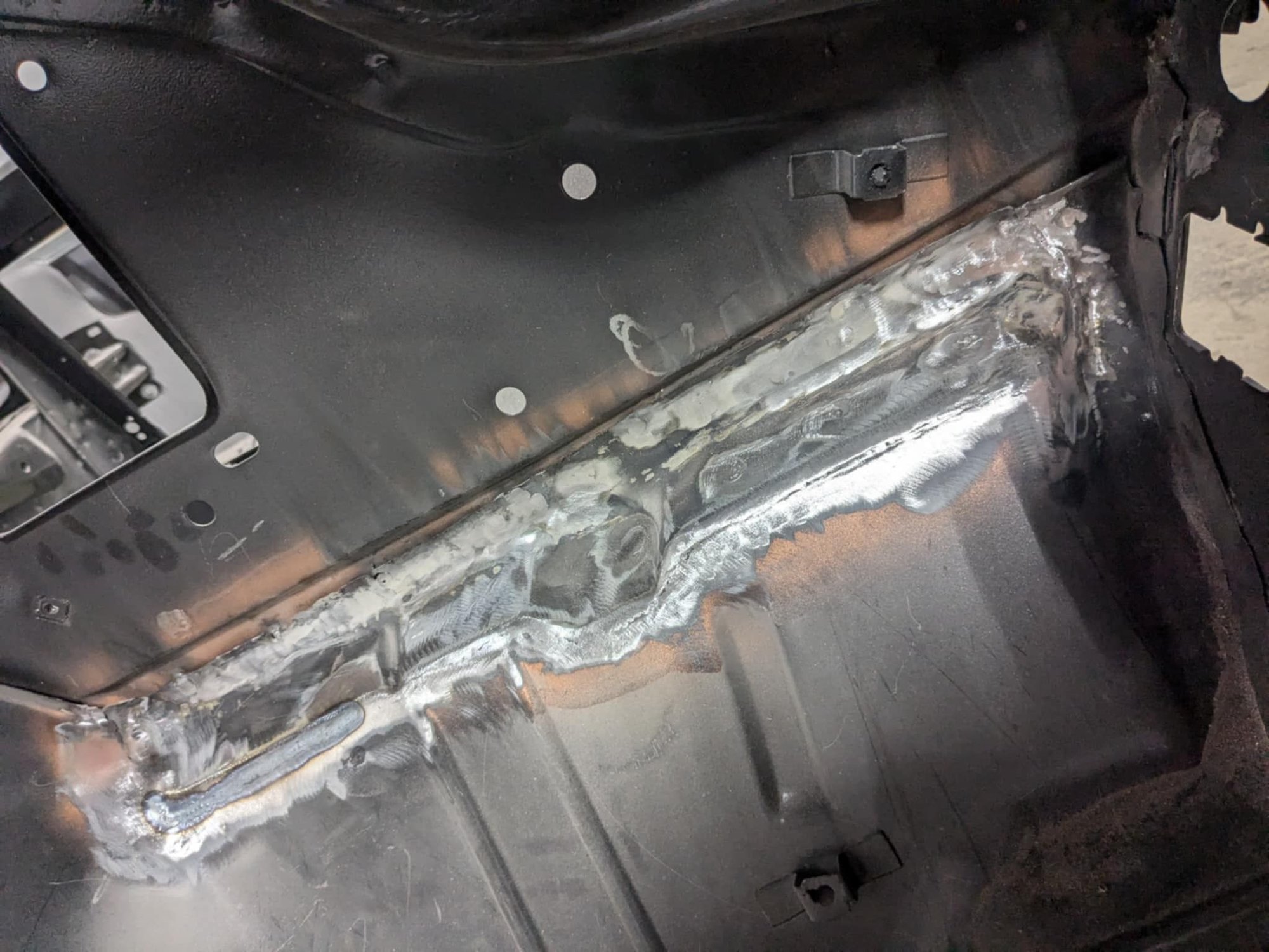

Welded and cleaned up.

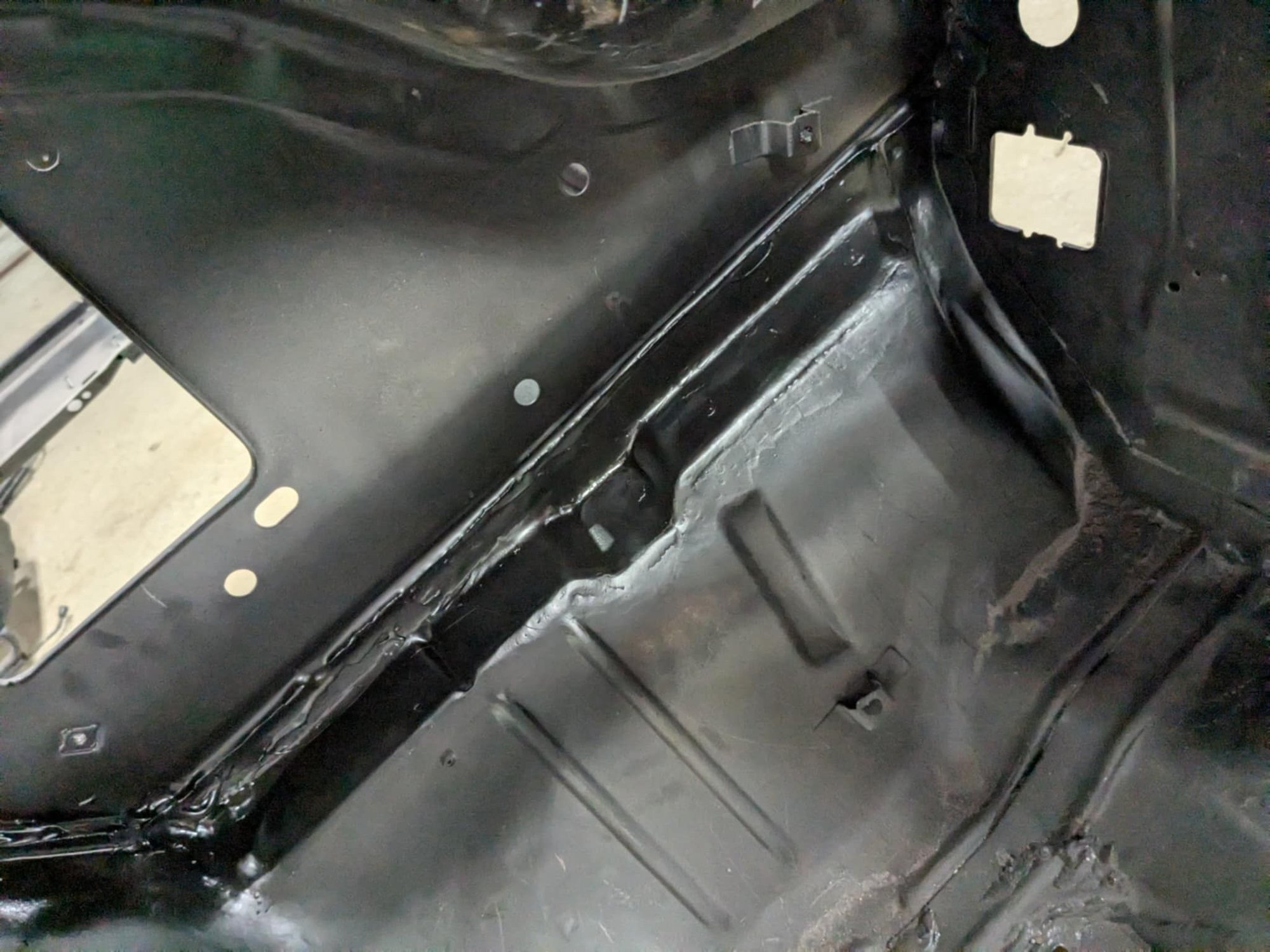

Fresh coat of epoxy primer over top.
Pass side toe board was pretty crusty.
Replaced it with new metal after cleaning up and removing any bad metal.
All finished up.
All finished up.
Old Dec 18, 2024 | 11:18 PM
merc3065's Avatar
Joined: Apr 2004
Posts: 177
From: Owen Sound
Car: 87 GTA
Re: 87 Gunmetal GTA - New to restoring

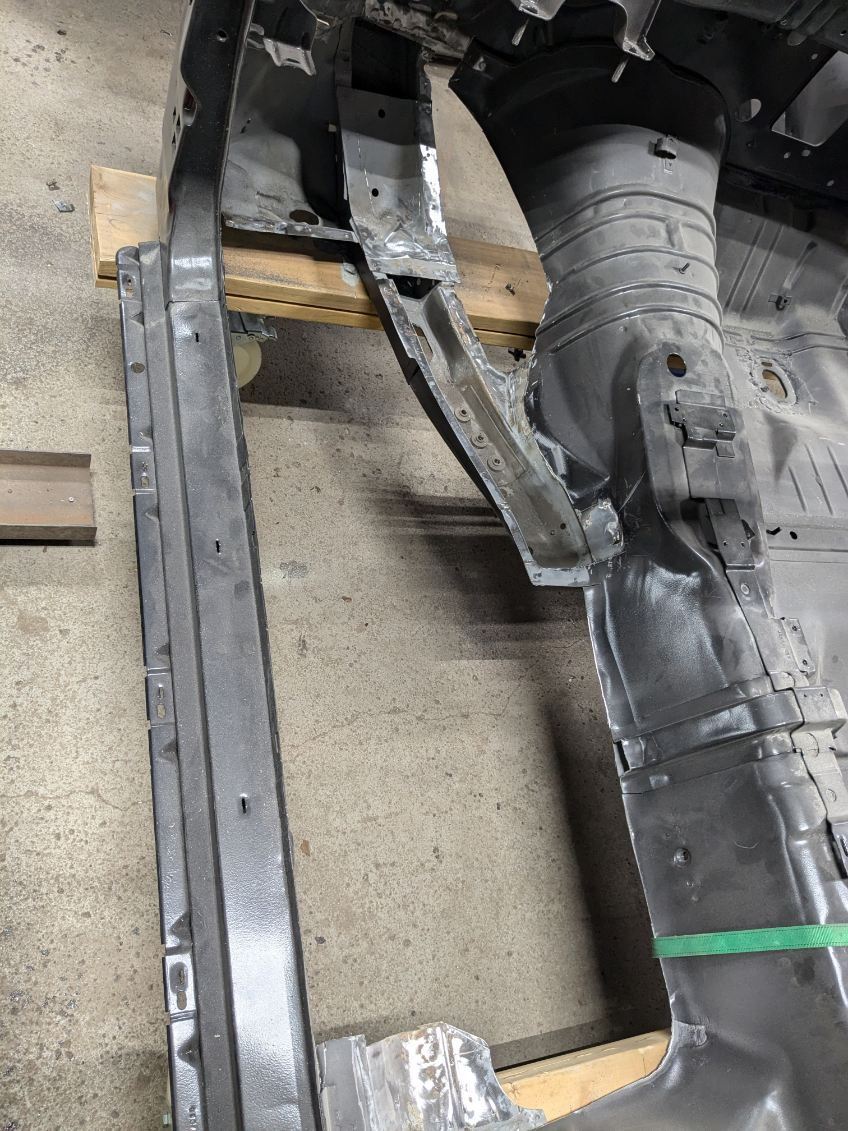

Driver's side rocker got patched up and replaced with a part from the donor floor pan.  Worked a real treat.
Decided it would probably be easier to replace this part of the rocker since we had all new sheet metal in good shape.

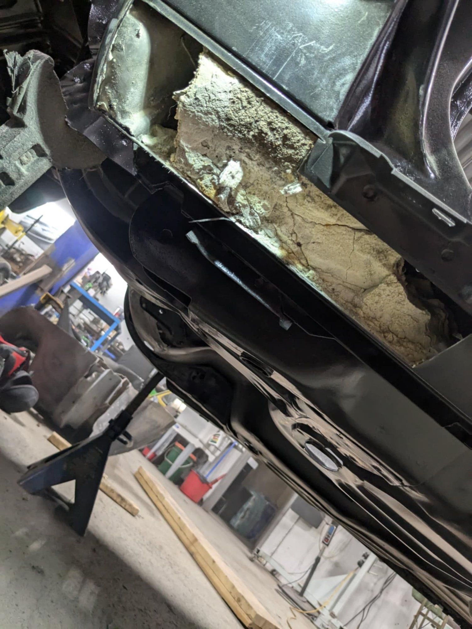

Except we found about 20lbs of blasting media.  Be aware that this kind of thing could happen for anyone that gets their car sand blasted...We figure when the car was being rinsed, the sand and water drained into this part.
All patched up.
All patched up.
THIS HOLE IS WHAT STARTED THIS WHOLE MESS!  This was a hole in the T-Roof area on the back of the pass side.  It was filled with about 2
THIS HOLE IS WHAT STARTED THIS WHOLE MESS! This was a hole in the T-Roof area on the back of the pass side. It was filled with about 2" of body filler to hide it instead of repairing it properly.
At least now it's all cleaned up and patched.

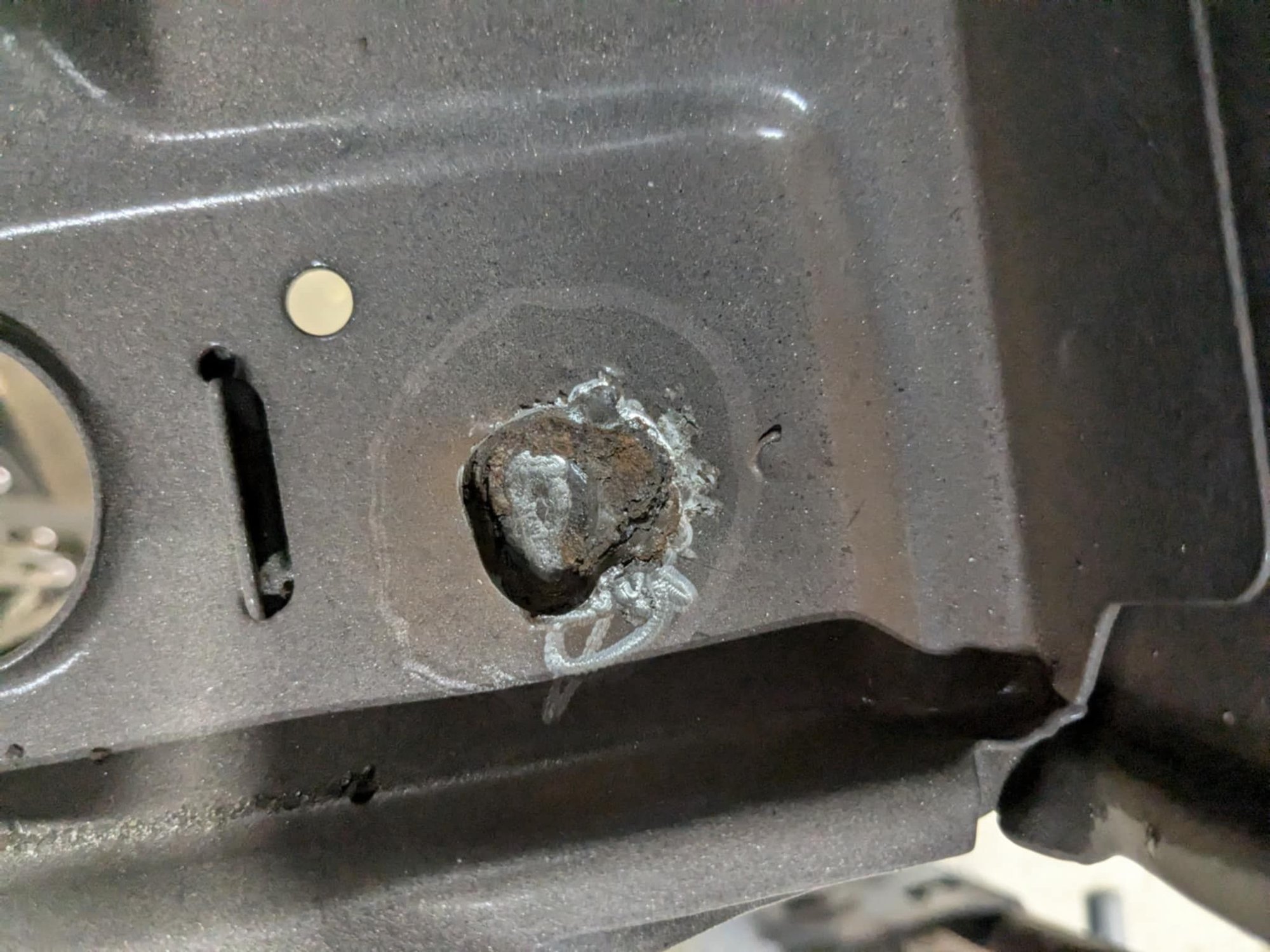

All cleaned up underneath where the welds were ground down.
More cleaned up welds.
Will be very hard to tell that it was replaced.

I think you are on the right track so far. Stripped down to the bare shell, repair all of the rust damage before going any further. It's the right way to do it. My car was very similar to yours. Looked good on the outside, but lot's of hidden rust underneath once you get it taken apart.
Assuming all of the metalwork on the unibody shell is done, there are a couple of ways you can proceed. If you are going to be painting the car yourself, you could keep the car on your rotisserie and complete all of the body and paint. Install the drivetrain from underneath after body and paint, then interior. That's pretty much how the factory did it. Don't know if you have access to a lift or not. It can be done without a lift, but with a lift a lot safer and less risk of damage to the body.
If you are going to send it out for body and paint, then you will likely want to get it to the point that it is a shell with a working drivetrain in it (this is the method I did). I stripped my car down to a shell, did all of the metalwork and painted the underside and engine bay in my garage with quality urethane paint (BASF). I didn't want to do the exterior body and paint, so I installed the driveline and got it running/driving so it could move around under it's own power. The bodyshop I am working with wanted it running so they could move it around their shop easier. I brought the car to the bodyshop at this stage and brought them all of the body parts loose. It's there now and the car will come back to me with an assembled body with bodywork and paint completed. Once it's back home, I'll finish up the wiring harnesses, interior, exhaust and misc stuff.

The driver's side rear 1/4 has some weird rippling that likely can be worked out by a PDR specialist.
The pass side 1/4 by the back of the door also had some metal work done to it as you can really see where the body guy cut hard into the metal with a sanding disc. All of that was revealed with the dustless blasting.
Underbody rockers and frame rails had some odd ball dents from incorrect jack points being utilized, I plan to fix that best I can with a slide hammer and some time.
Driver's side rear seat is pushed in a bit on the replacement floor, likely due to shipping/storage but should push down pretty easy with a few good hits from a dead blow hammer.

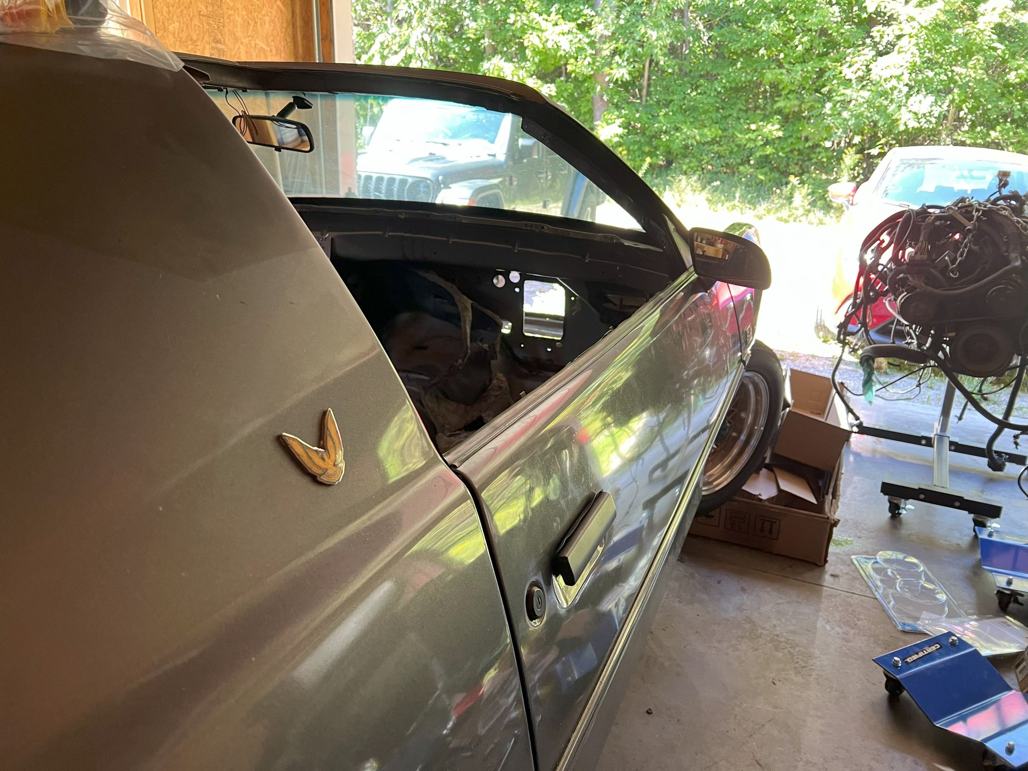

The main reason for starting any of the exterior work was the T-Top weather stripping being old and leaky and me wanting to get that fixed first. This "little" part led me to find a rusted out T-Roof bar and light surface rust in the T-Roof channels on the rear side of the roof line. I used a wire wheel in those channels to clean it up so I could treat it with paintable rust converter and then mask/spray paint everything. This is what led me to find the hole in the roofline on the pass side. This issue then snowballed into me pulling up the carpet and finding the poor patch job on the driver's side and finding more and more issues as I went through the tear down. This included everything from left over wires, to really weird choice of fasteners for several interior pieces.
After sandblasting and getting rid of the (what looks like) basement paint on the floor pan to hide the pinholes and "seal" everything, the blasting revealed a ton of pinholes everywhere along with the rotted out rocker panels.
Thanks to @TransamGTA350 - that was the answer I was looking for.
I will be working towards painting the interior, underside, inside the frame rails and engine bay. Then I can get the car mobile and then final exterior paint at a body shop nearby. There will be a ton of other prep work before I even get to that stage which includes things like headline brackets, crash bar, fuel and brake plumbing and so on.
I haven't got the skill to deal with metal work or paint and I am not ready to try (no shop air) so I will be farming it out to someone who knows what they're doing. The final colour I am likely going with is likely going to be the hypersonic metallic grey from a 2023 corvette. To me it's an update to the original gunmetal grey and I think it looks amazing.
For the engine bay and underbody paint, I would recommend using quality bodyshop grade materials and you will need an air compressor and paint gun. You can use collision grade paints vs. show car grade to save some money. Most brands offer multiple lines. I used RM products and used their Limco line for the engine bay/underbody, which is their lower cost line that collision shops use. The outside will be done with RM Glasurit line, which is their higher end line and more expensive. Epoxy primer for all and then base/clear for the engine bay, same color you are going to do for the outside (unless you just want to do a black engine bay, then single stage black is fine). Underside can be single stage, no need to spend the money on clearcoat.
You say you don't have shop air, so I would recommend buying a decent compressor. You're going to need it for the metalwork anyway. Lots and lots of grinding welds with an angle die grinder. I got a away with a 26 gallon Craftsman upright diaphragm type for my whole project, including the painting. It was a little small at times, but it did the job, and need to rig up a good water separator setup. You can get a decent paint gun set (full size and detail) that will do what you need for a couple hundred dollars. You can spend a lot more that that for professional level paint guns, but no need for what you are doing here. I use a Devilbiss 2-gun kit that I bought from Eastwood and it has worked out well for the amateur level stuff that I do.
