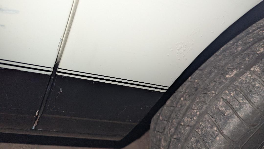

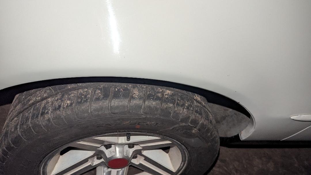

Oops! Sorry I didn't see this. My car isn't really "rusty" pre-se. The quarters are just bubbling up a small amount. It's a T-top car so I need to do a small, maybe 3"x3" patch under the driver rear seat and a small patch in the footwell. The fender I want to replace simply because it has a very weird vertical dent I can imagine happened when it got very familiar with a vertical obstacle and has obvious body filler in an area near the top. I imagine buying a new fender would be easier than trying to hammer out and straighten out the metal, but I am inexperienced and may be wrong. I do suspect my car isn't as solid as I would like to believe because the left frame rail has been rewelded but after essentially taking my entire car apart inside and out 2 times at this point (shoutout crap wiring jobs by the PO) I am hard pressed to find anything but dust on mostly everything that can rust apart from the doors. The driver side door is shot at the bottom (just going to buy a door off of a different car). My genuine main concern is the front bumper, I am unsure how, but it looks like it went through hell lol. To be clear, I don't want the car to be perfect, it never will be. I just want sometime that doesn't look like total garbage and is slowly dying of rust.

Pictures? If using patch panels, those AM units may be okay to cut from. The curves will be close enough a good body shop can move them around to fit while welding them in place. That's what they did with our SVO. BOTH rear quarter panels were beat in, one side twice. While I provided take-off rear quarter panels, they only used one, and got an AM patch panel for the other side that they worked onto the car for a perfect fit. Your favorite body shop will probably need to be consulted on which direction to go. Same with floor pans. The aftermarket will be close, and good enough to cut small patches from to weld into place, but large areas are best done from a rust-free donor, or doing completely new fabrication from sheet steel.

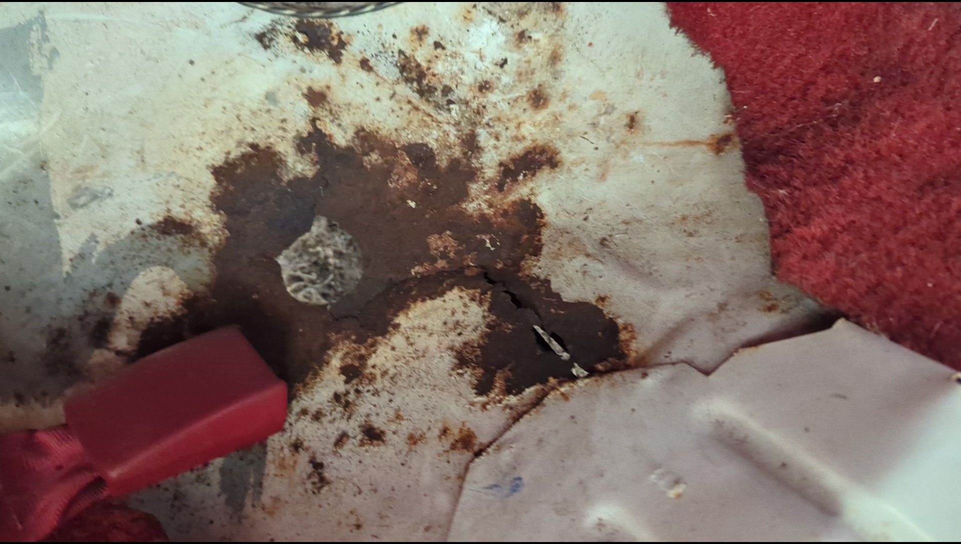

For the floor pics, both are on drivers' side, on the is the footwell and the other is the rear seat area. Not sure why the rear seat hole going up looks so bad, it isn't that bad in person.
From what I am getting from this thread is that I should get as many factory parts and panels as I can. Except the carpets, the newest original is 14 years older than me and I'm just gonna bite the bullet. I appreciate all the help so far in the thread, here's the pictures (passenger, driver, passenger, drivers)
-Shroud
And for the fllors, here ya go too

No expert, but it kind of looks to me. like you're going to need a body guy who can do metal fab. The outer panels may be done with patch panels, but I'm thinking that floor work is going to need some work you won't be able to replicate with patch panels.

Very interesting. Why do you think the floor needs custom metal work over the body? I do have the exact pieces of metal for the floors from another car, but I could be missing something her.

If you have good pieces from another car, that's great. The metal will be shaped better and of the same thickness and metallurgy as OEM, which reduce the work some, vs. aftermarket. Getting hard to do these days, though.
