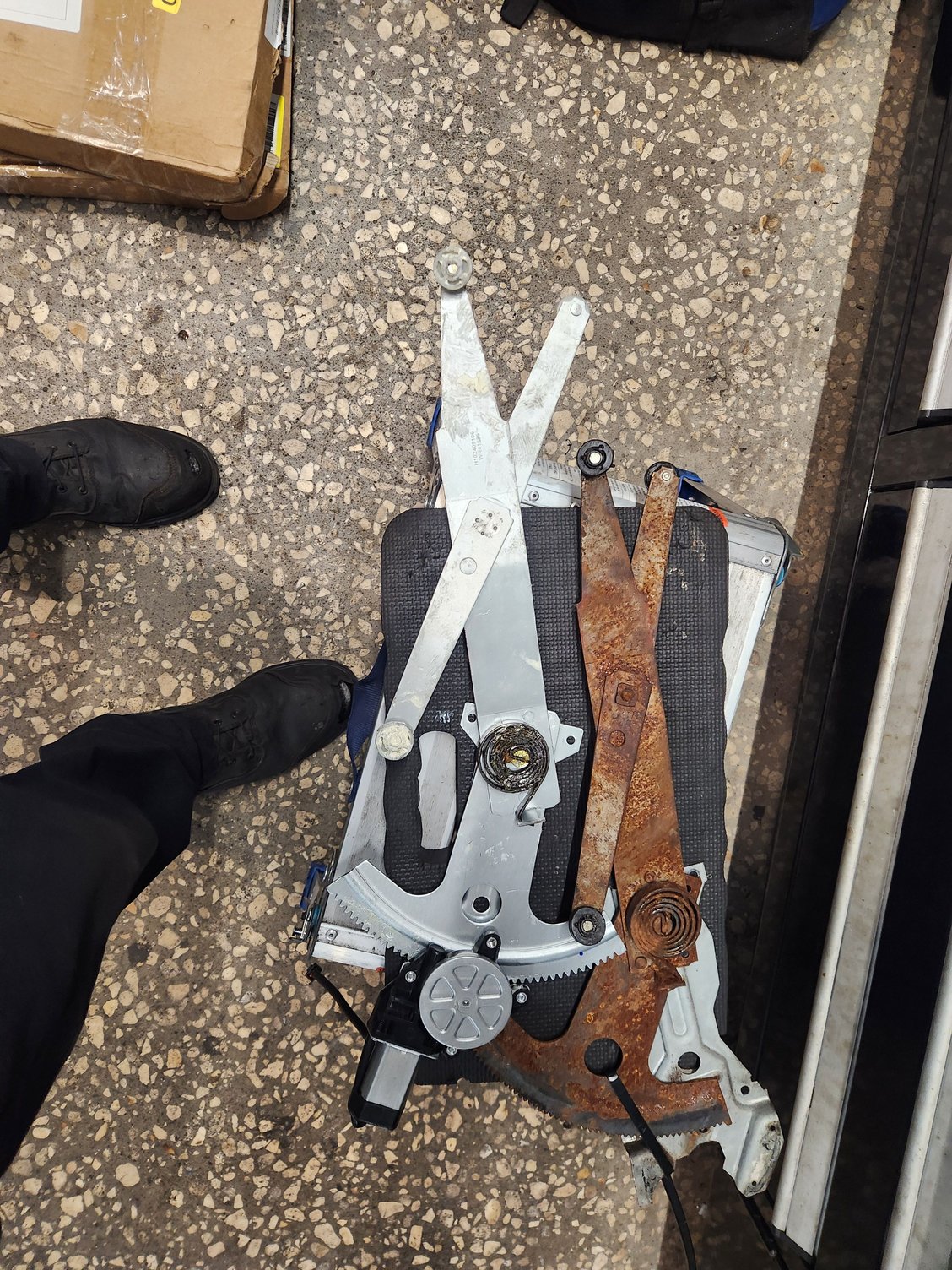

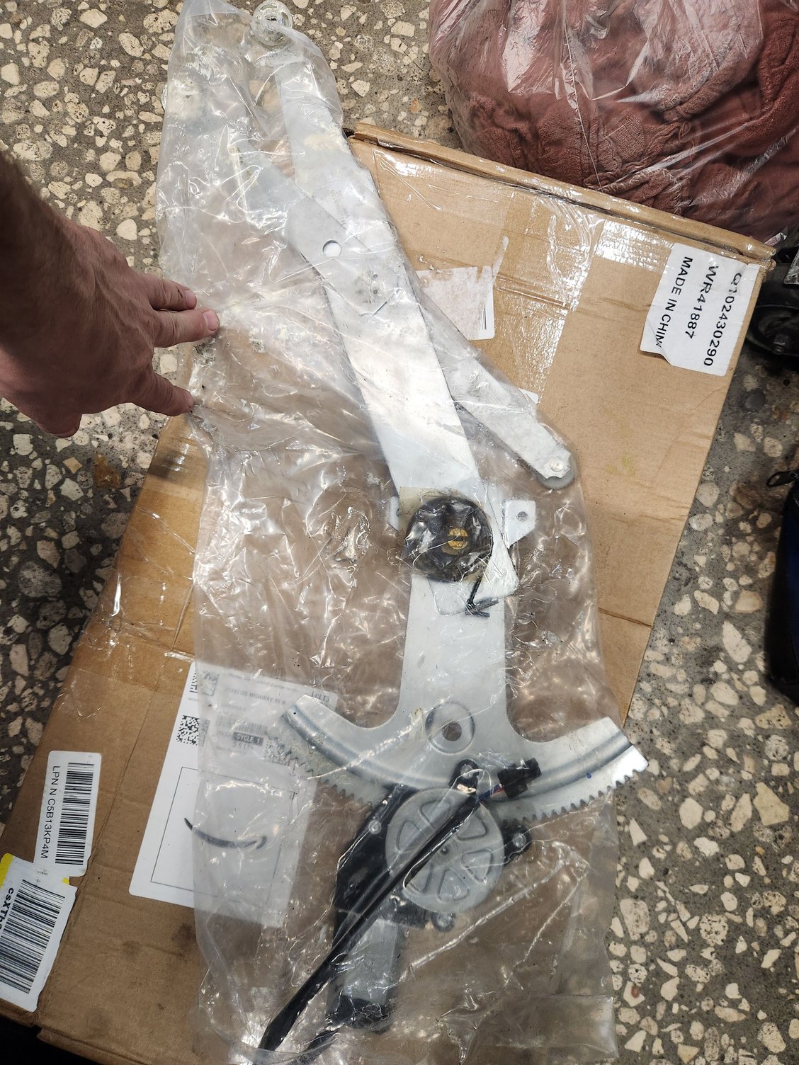

This is is the right side regulator old and new. Note that the spring is reversed out of the package.
Installation is exactly the same as the original.

Looks like the tooth count may be different between the 2. Think i noticed that when i was looking up motors. IiRC, They have different part numbers.

The tooth count is different, and to be honest, I'm not sure what application you would order replacement motors for considering the pancake style were oe.

You're welcome! It's a great benefit at such a reasonable cost. It doesn't really help with serviceability as the motor fasteners are inaccessible with the regulator mounted, but still worth it.
I mounted the regulator arm in a vice and used vice grips to unwind the spring. It requires a reasonable amount of force, but it isn't difficult. The tang locates in the relief in between the raised portions. Once you have it in front of you it's pretty self explanatory.

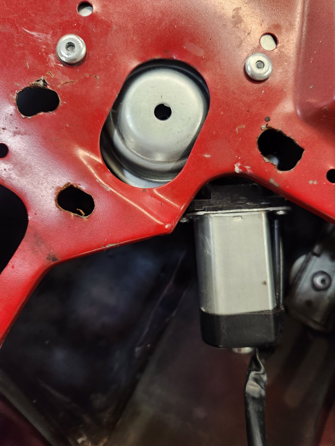

So the spring needs to be reversed, but do you also have to drill new mounting holes for the regulator?
I ask because it looks like there are some added holes there, or are those from the removal of the stock stuff?

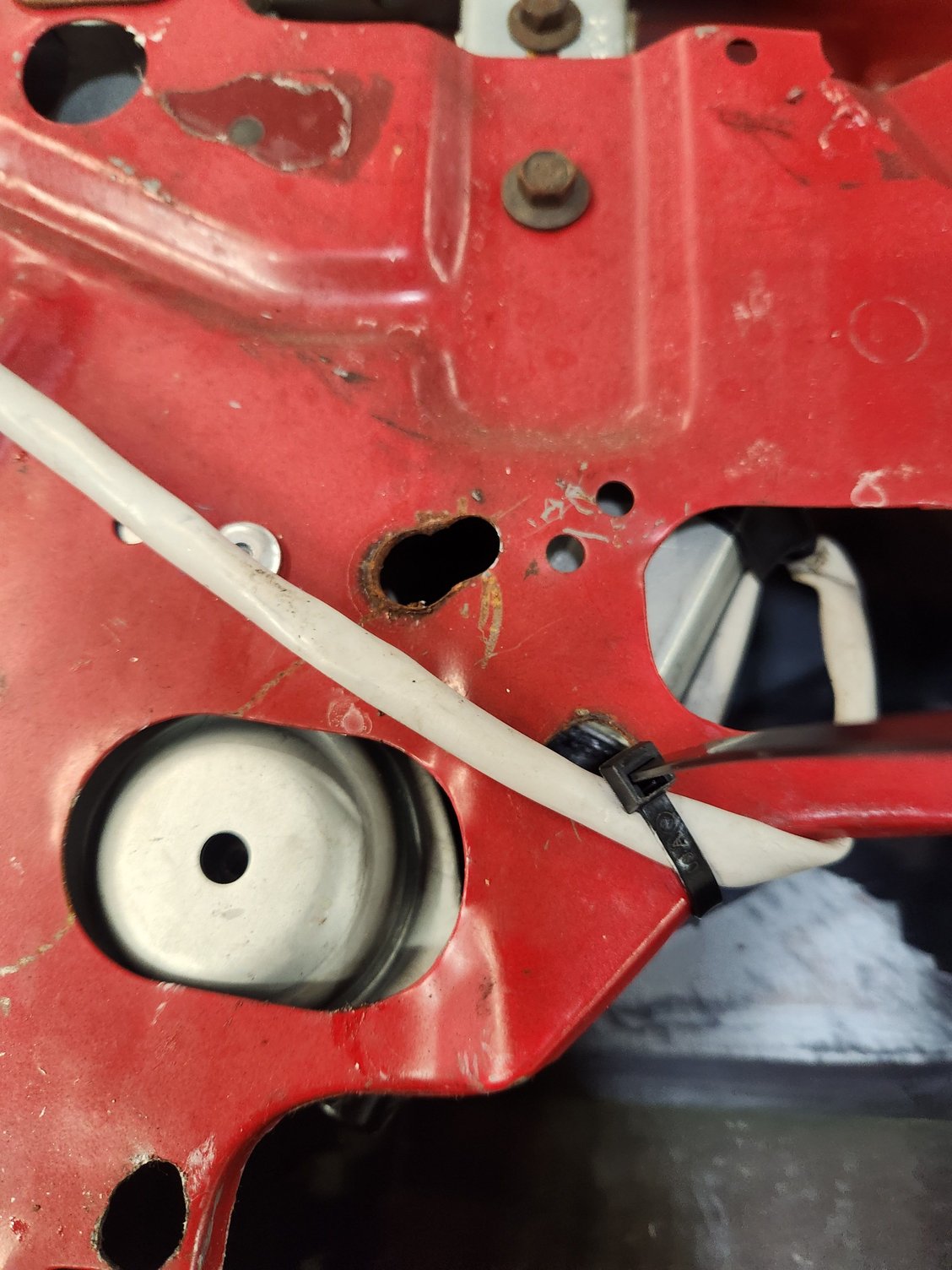

The additional holes on the door are courtesy of whatever hack replaced the window motors last in this car. The regulator mounts to the factory rivet locations without issue.
The electrical connector is exactly the same, just with a wired connection that has to be zip tied to prevent interference with the window glass.

Is that spring you need to reverse under a lot of pressure?
Like does it want to unwind very much?
From your description it doesn't sounds like it was hard. I just can't imagine it in my mind exactly.

It's a stout spring with pressure on it regardless of position. It can be accomplished with vice grips though, so it isn't terrible. Once you have the part in front of you I think it will click

No idea what is "best" but the prices swing from $45 to about $70.
There are two distinct designs:
1. Ones that look like stock where the connector is on the motor
2. Others that look like there is a new style motor with some sort of gear box and the connector is on the end of a wire.
Price doesn't seem to define the style.
Something to keep in mind is that these units need to live in the elements.
Getting humid and a bit wet from condensation. Some of the units on RockAuto look to have a zinc coating for corrosion resistance, others don't.
Maybe that is a reason for some being higher priced, no idea.
I also noticed that the rollers on the end of the arms look different on different models. Some look like stock, that are sort of a hard rubber wheel.
Others look like cheap hard plastic wheels with no rubber at all. This could be another source of cost difference.
Just wanted to throw this all out there for other's consideration. I will post here what I eventually buy.
I'm curious why the clock springs were mounted opposite. They serve the very same purpose (assist with raising window, to offset the weight of the glass) in a 4th gen and iirc, the regulators are oriented the same way in a 4th gen. Perhaps it is just a manufacturer error?

As much as I'd love to say I'm observant enough to have noticed, it was a one off comment in a thread I found on here that mentioned it and sure enough, it was backwards.

Not home to look at my own OE parts, but does the regulator get attached to some other bracket that has small grips that hold the glass?
Maybe a stupid question since I know there is another bracket that has the down travel bump stop on it, but I don't see that in any of the pictures listed here.
At work now, and question popped into my head, how are people attaching these 4th gen regulators to the bracket that holds the glass...

There is a provision for the rollers in the window channel.

Right. Thanks. I took a look last night and I didn't realize it has a separate bracket that holds the glass and that it has its own roller.
