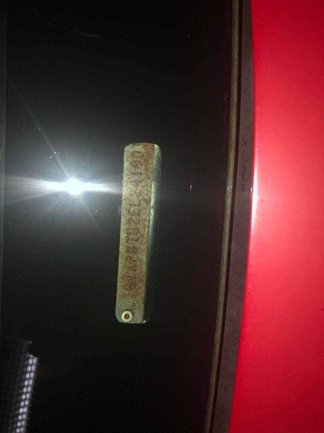

Right; if original to 84, it's a 10-bolt. Might have 3.73 if it was a L69 (VIN code G).
AFAIK the first use of the 9-bolt was in the 85 L69 Firebirds. Would have come with 3.70 gears. Same crappy Saginaw brakes. Camaro didn't start getting the 9-bolt until 87 AFAIK.

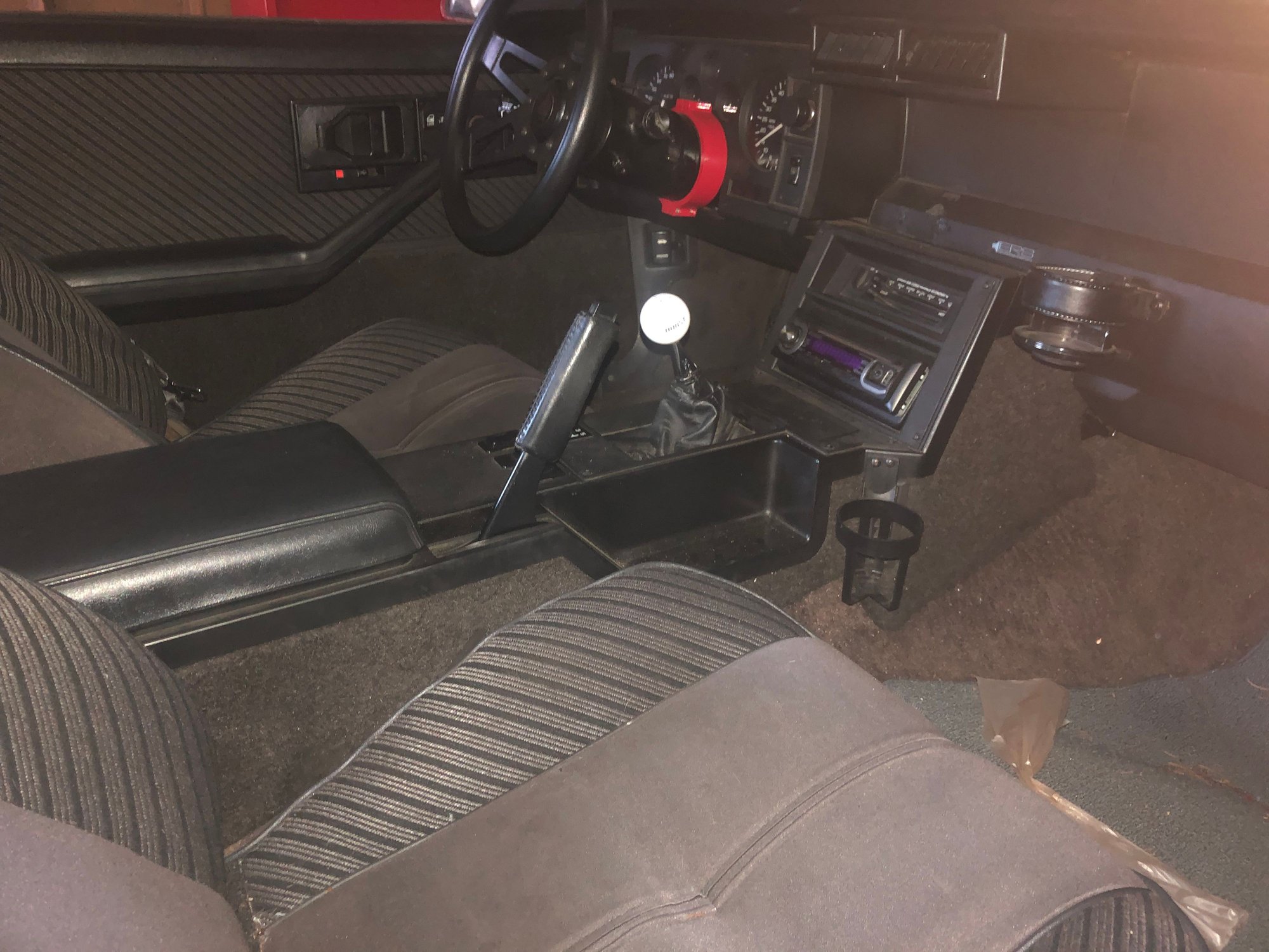

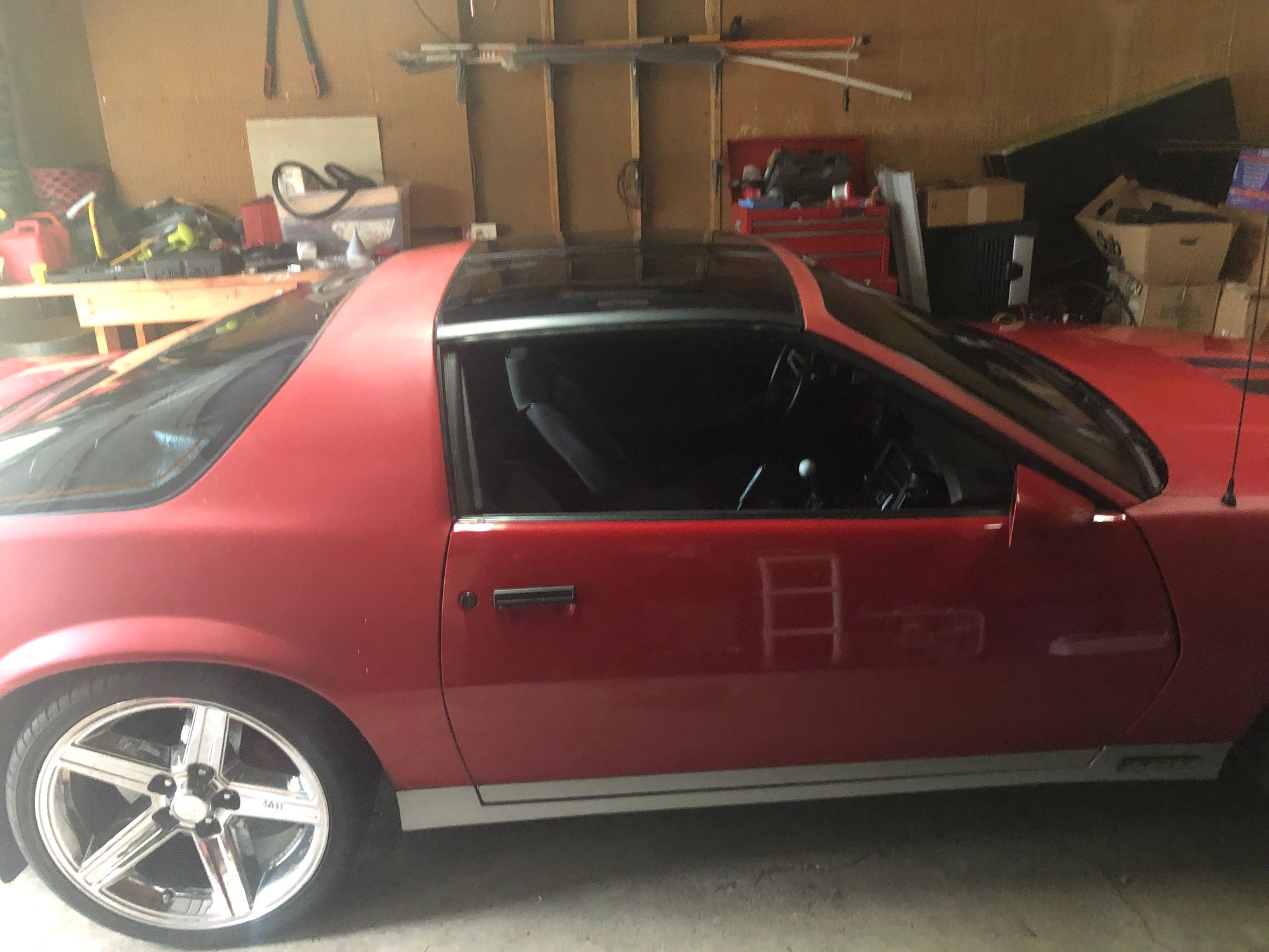

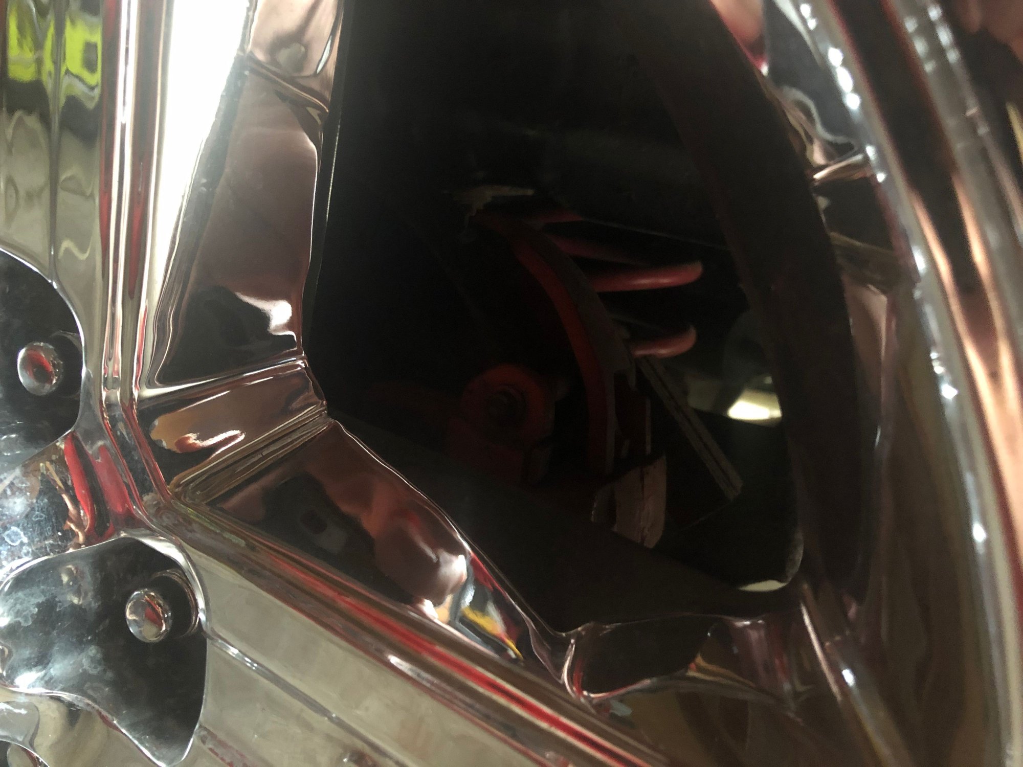

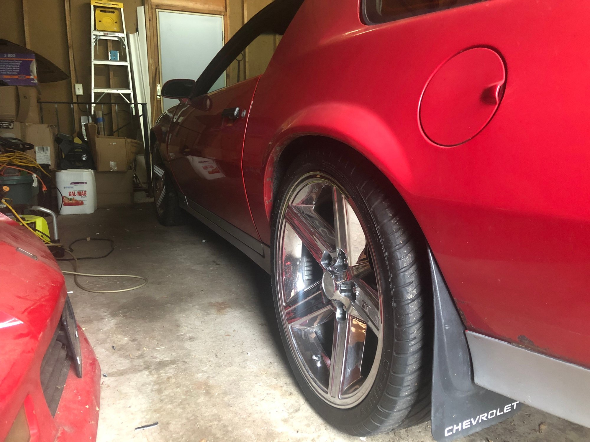

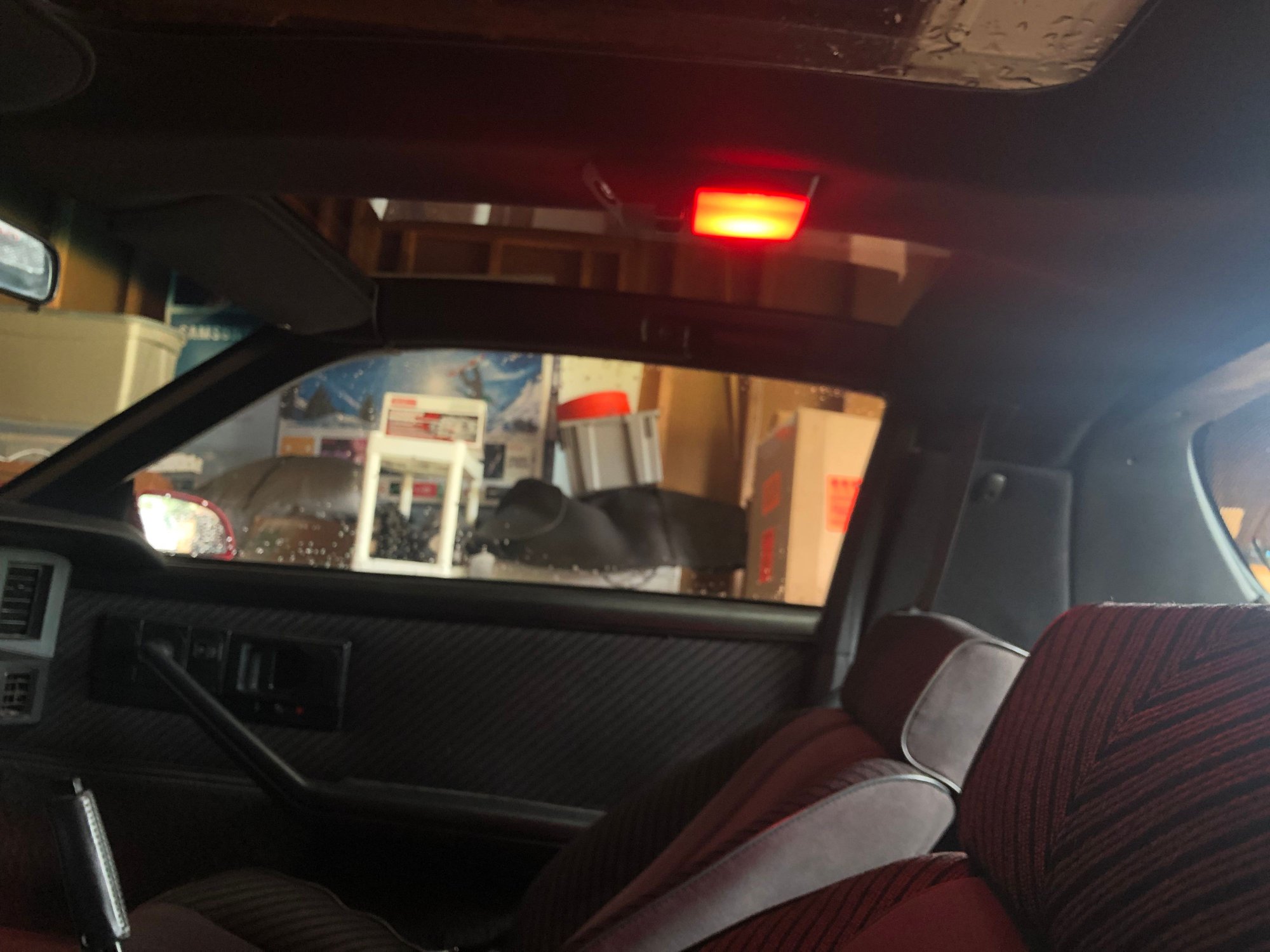

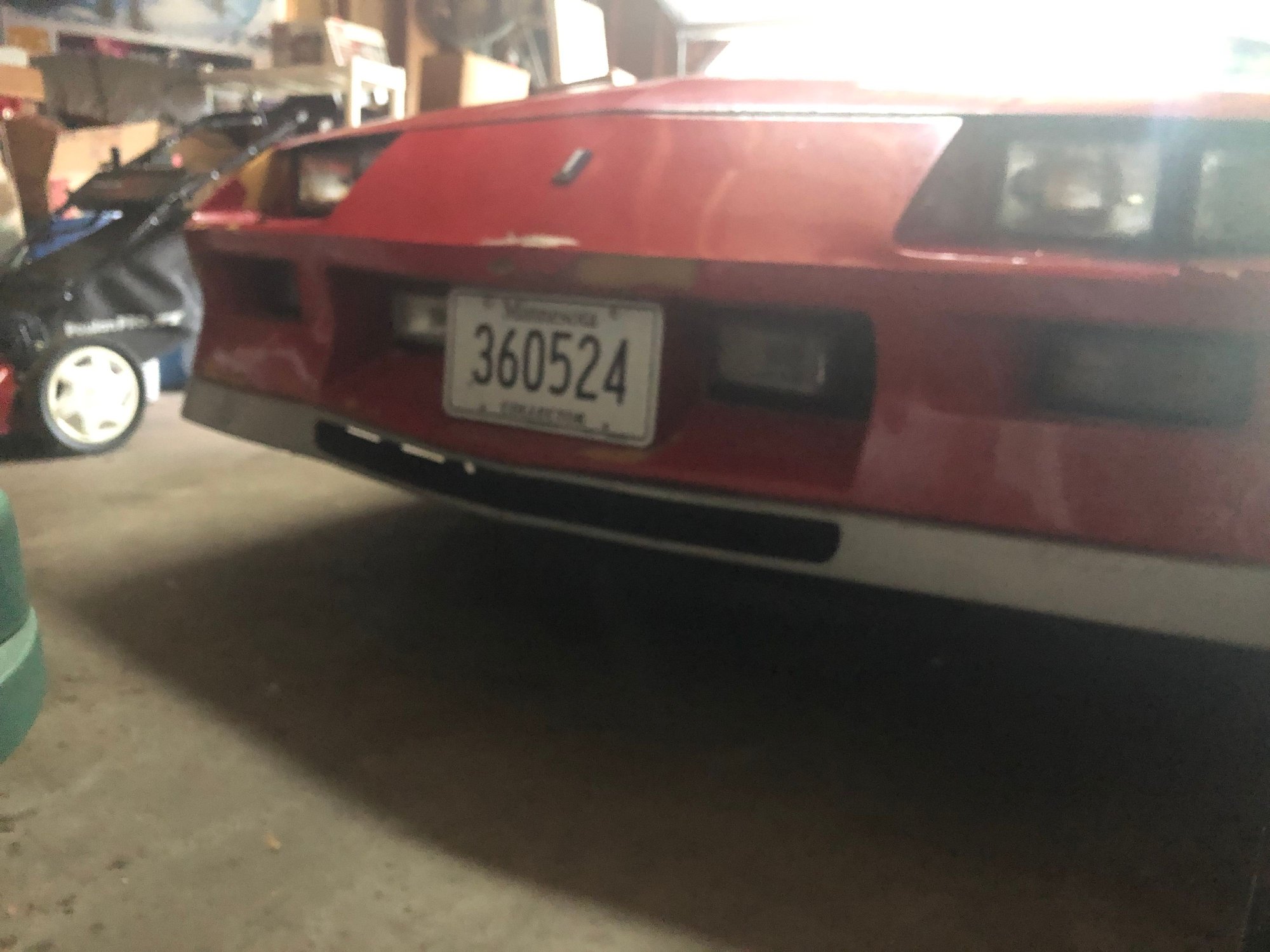

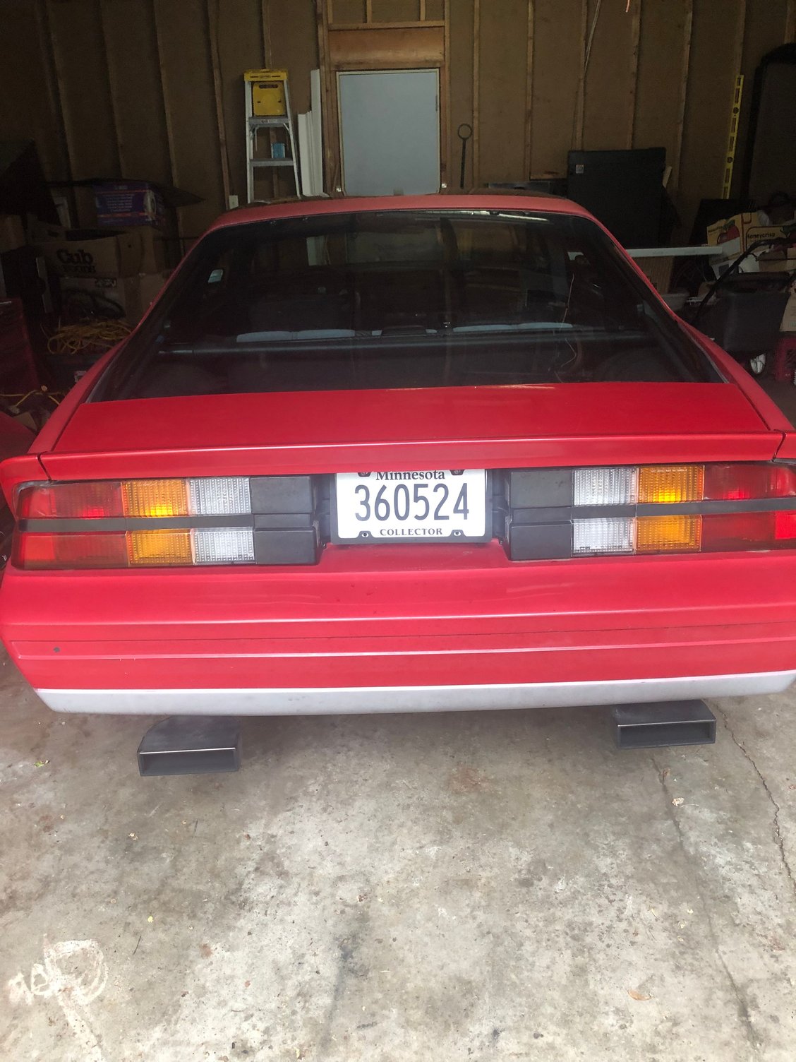

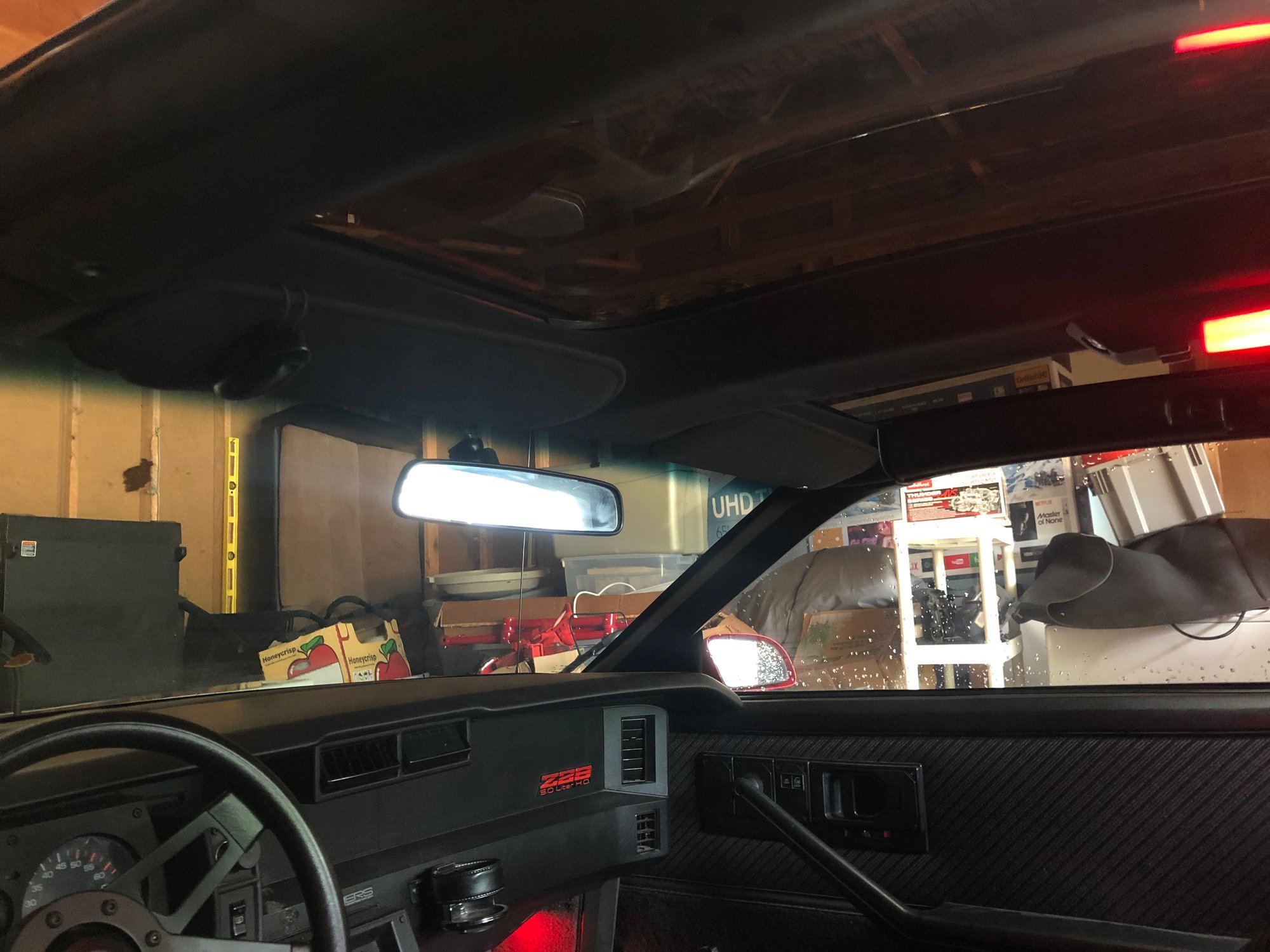

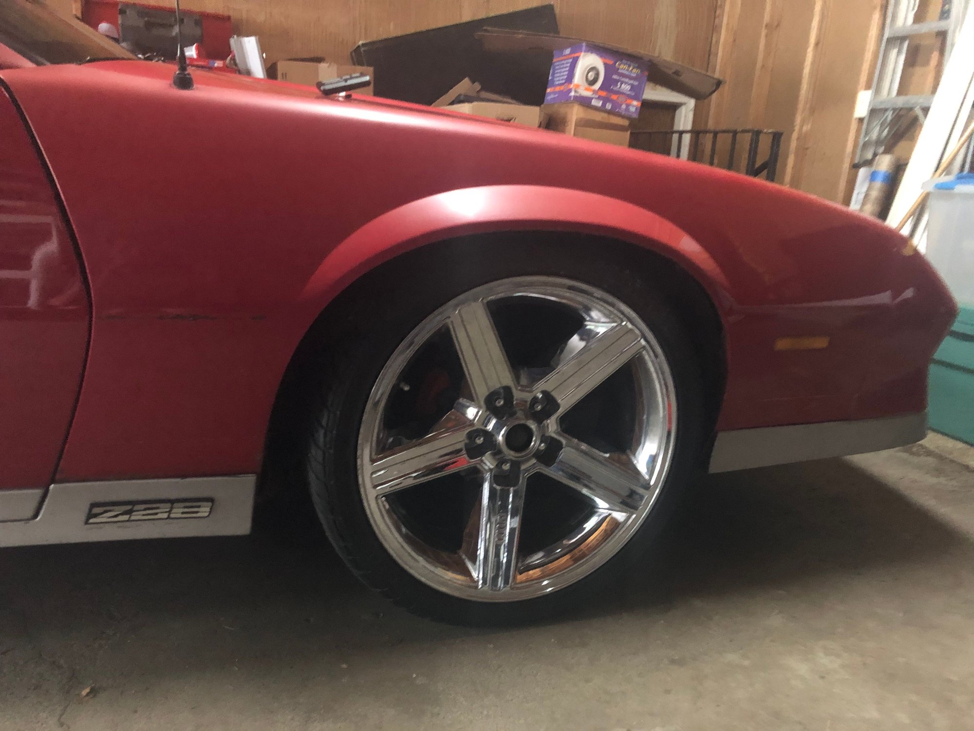

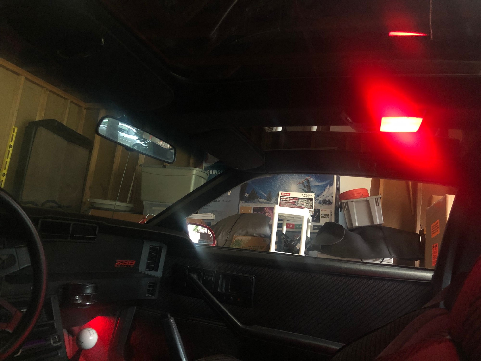

Looks like a fun toy to have around. The pictures I was referring to was of the actual axle and brakes.

Oops I didn’t mean to post all them pics on this thread lol.
I’ll take some pics of the rear end and brakes this weekend.
