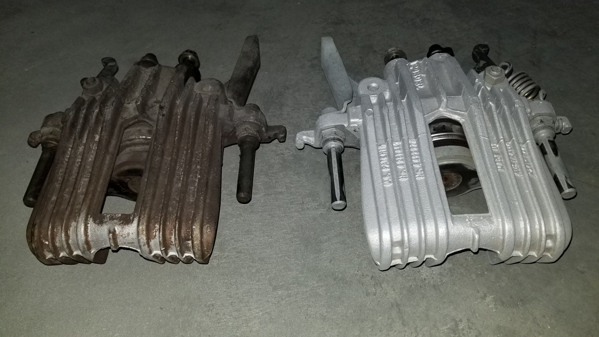

While they're disassembled, clean the aluminum calipers with this stuff, and they'll look brand new again. It's a blend of acids, for aluminum only. Don't use it on the steel hardware or iron brackets. Clean those parts with your preferred degreaser. Of course, if your calipers have been painted, then nevermind this stuff lol.
Here's a before and after with that Aluminum Brightener. These are off of a 95 C4 Corvette. Same calipers as 3rdgen, but not quite 100% interchangeable, due to the configuration of the e-brake hardware.
