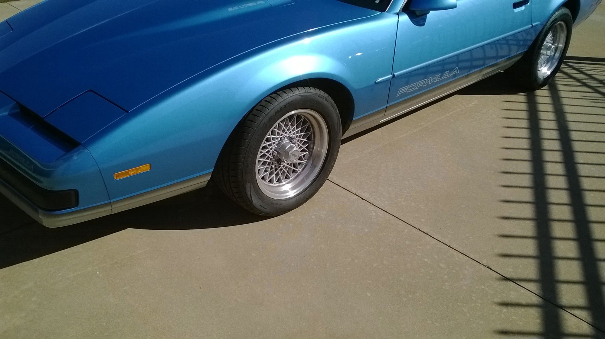

I have four rear wheels and LS1 front brakes. Had to use the factory rear spacer (my car came with rear drums, so there was a spacer there from the factory) up front for clearance. FWIW, the way it sits now, the front and rear track are the same. Here's a current pic:

Let's not conflate issues.
On the BACK. You can run FRONT wheels on the back. Fairly common. They stick out an extra 16mm, which is about .25". It's no more than when guys run the new 17" reproduction IROC/GTA/Firehawk wheels. Easy enough to test fit. Ultimately a personal preference.
On the FRONT. rt66er said it best. Spacer up front with factory REAR wheels. Same wheels you got, some brakes ya got!

Man that looks good!!
Sweet! thansk guys! the pics help a lot!! (Ive never seen that color GTA rm) and if anything i can find some extra rear GTA rims if needed 025is not really much at all.
I got the factory spacers.. so i'll just run the backs up front with spacers and throw the fronts on the back... . I doubt that 0.25 wil lbother me.. i can test fit it on back too!

I had the wheels refinished to match the silver two-tone on my Formula. You'll love the LS1 brakes... best mod I've done to date.
