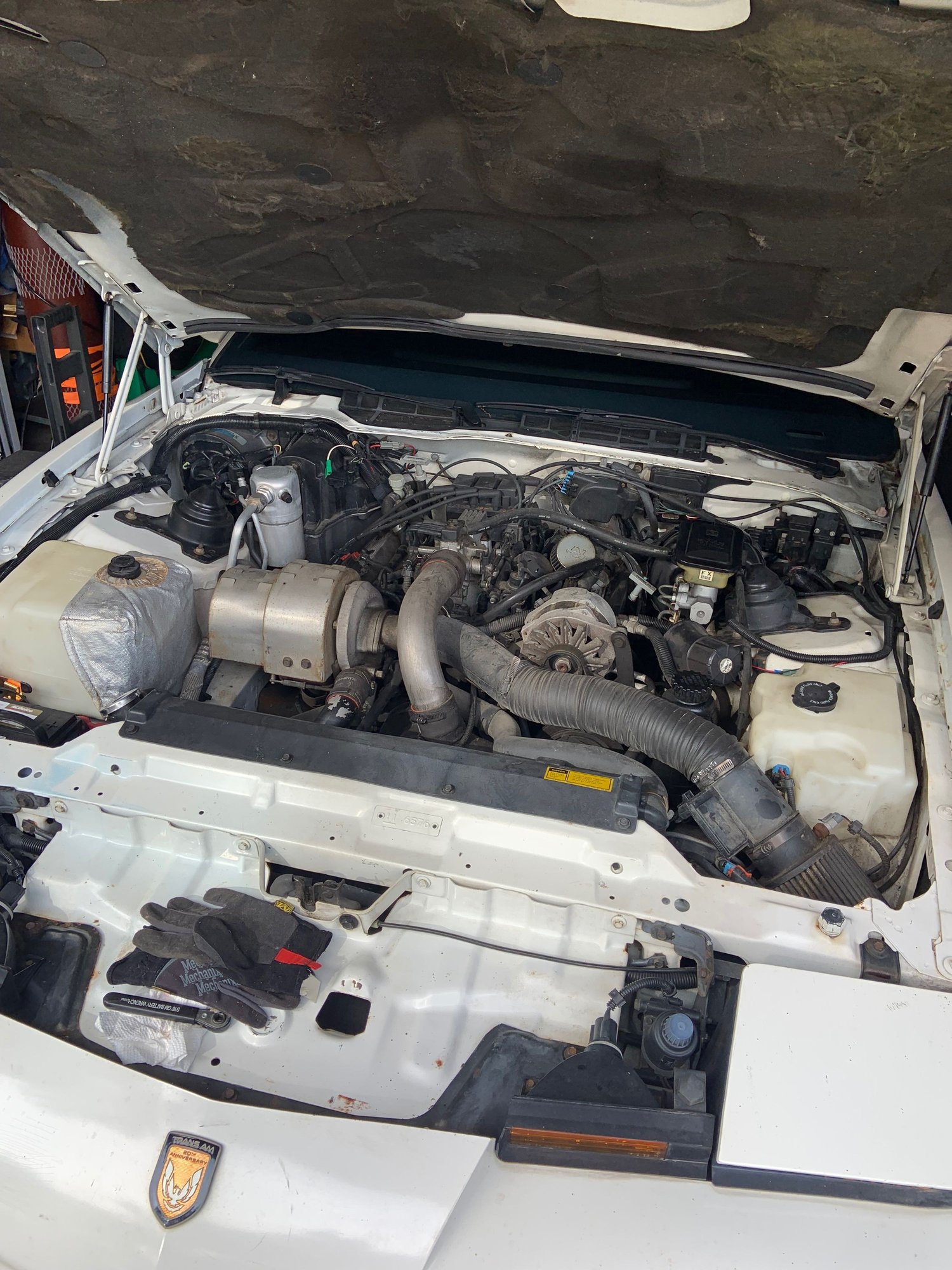

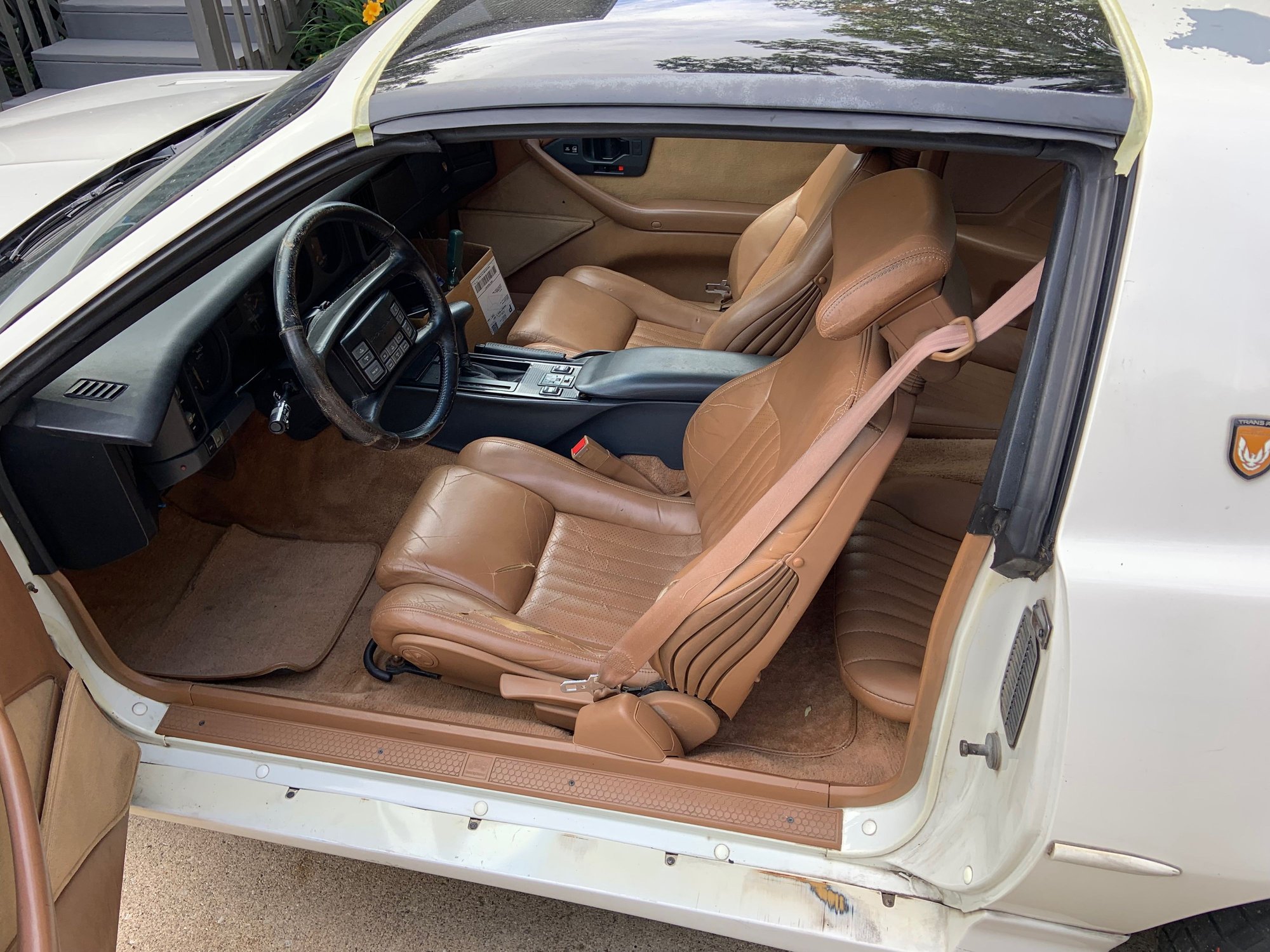

Sure! It's no show car. It was a daily for about 10 years mostly spent outside for almost 50,000 miles, has some hail damage, paint delamination on the roof hoop, and the interior isn't awful but it needs some help. I'm touching it up, because I'm ready to enjoy it. I'm aiming for mid 11's then I'll get it painted and install the door decals, but I'm probably going get the Hawk's wing and 17" wheels before then. My father bought it new in late '89 for $29,000. It sat on the showroom for a long time before he bought it as a company car. The trans locked up the governor almost right away and was never quite right until a shift kit and small stall were installed, and the gas tank started leaking when it was a year or two old. Everybody says it's the same size tank, but the car lost 30+ miles range when it got the warranty tank. Maybe the sending unit got bent? He bought it from his corporation for $7,000 three years later. Technically I'm the third owner, but have been driving it since it was new. He had a GN as a corporation car before that. I had talked him into buying both when I much younger man. He died in 2003 from lung cancer at 67, I got the TTA and my brother got the GN, which was worth more than the TTA at the time.

Thanks. That don't look bad at all. It looks very similar to mine; definitely a driver too.
