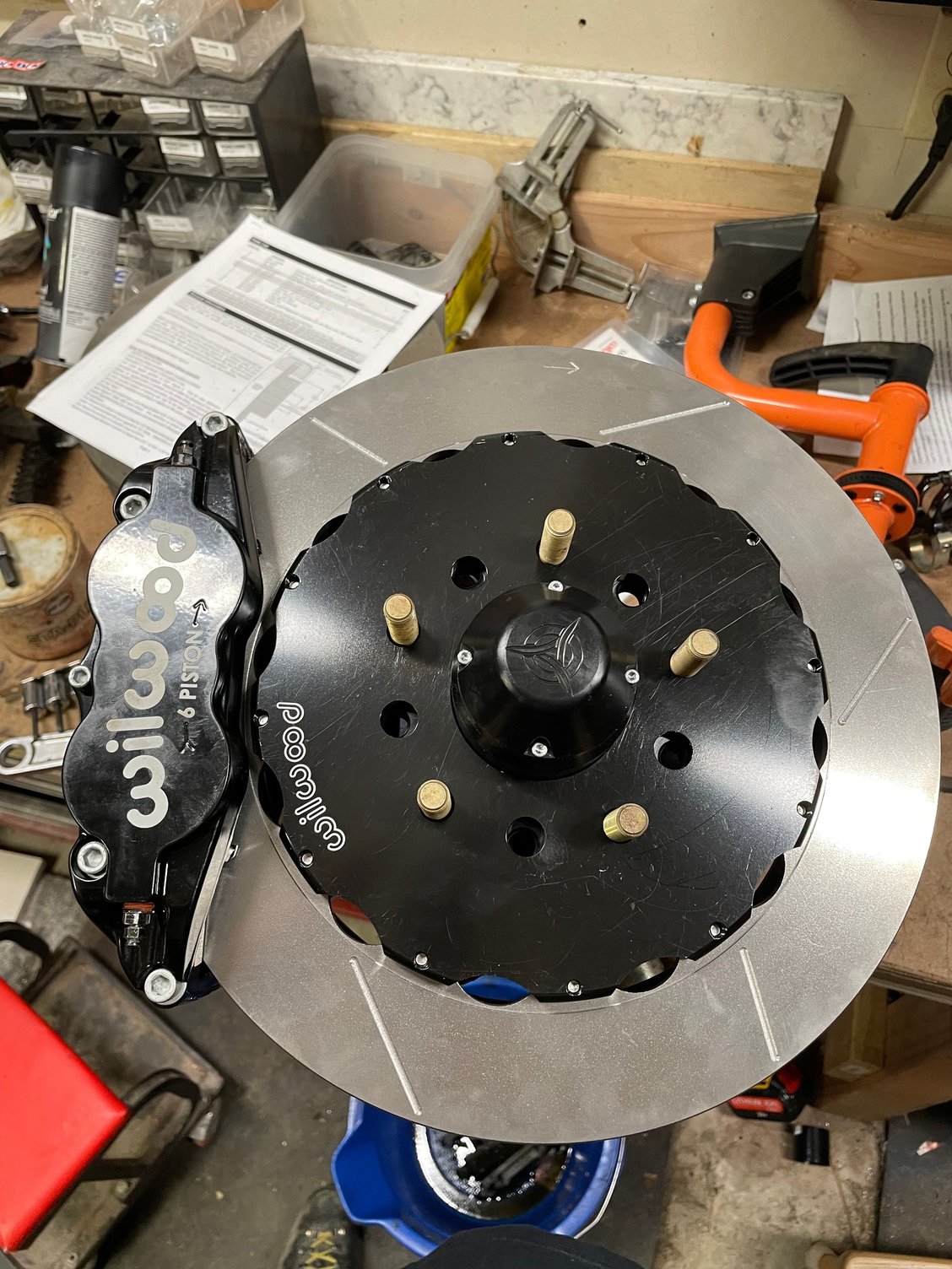

I think both baer and wilwood make kits that will fit under 16 in wheels. All of the upgrades will require spindle modification. Its not hard or expensive. The stock brakes are pitiful. Especially if you have a faster car. I think you have lots of options. You can also look at hawks and big brake upgrade. There are kits for better 4th gen caliper/rotor upgrades. You can use your stock MC and just swap the front components. The car will be much safer.

agree the later 4th gen ("LS1") conversion is something a hobbyist could do (I did) with the turned down rotors and brackets from bigbrakeupgrade.com - i.e. modifying your spindles and sourcing the calipers and 4th gen rotors locally
Not cutting edge, but good bang per buck and serviceability
I went with C5 calipers and had to do some minor clearancing to the calipers and thin wheelspacers for the 16" mesh wheels to clear. Been absolutely fine for the 5 or so years I've had them
