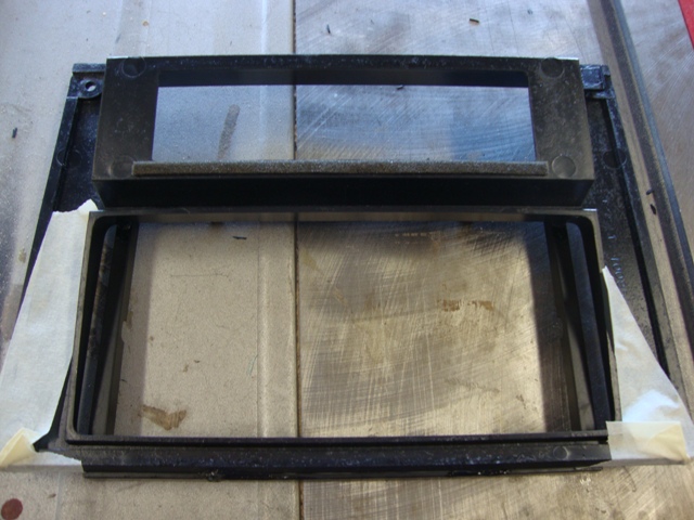

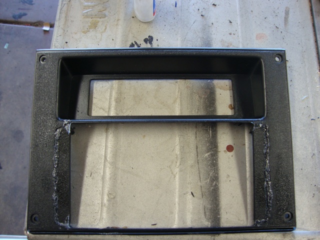

Pic 1 Attached trim ring temporarily with tape and CA glue. Routered out top and bottom of dash to correct size opening or deck. Pic 2 dash cut. Pic 3 is filling in sides with ABS plastic and attaching with CA glue

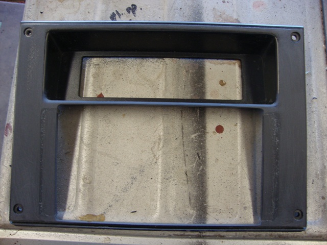

Pic 1 both sided filled crack between ABS and dash kit with CA glue Pic 2 is the back side. Pic 3 is sanded down level

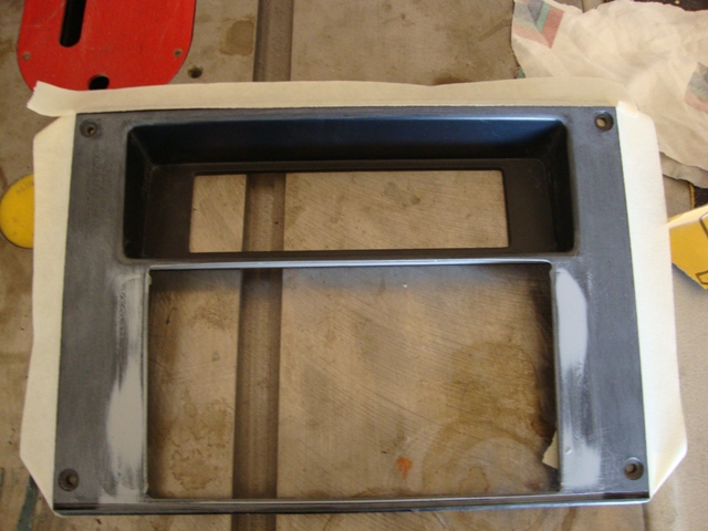

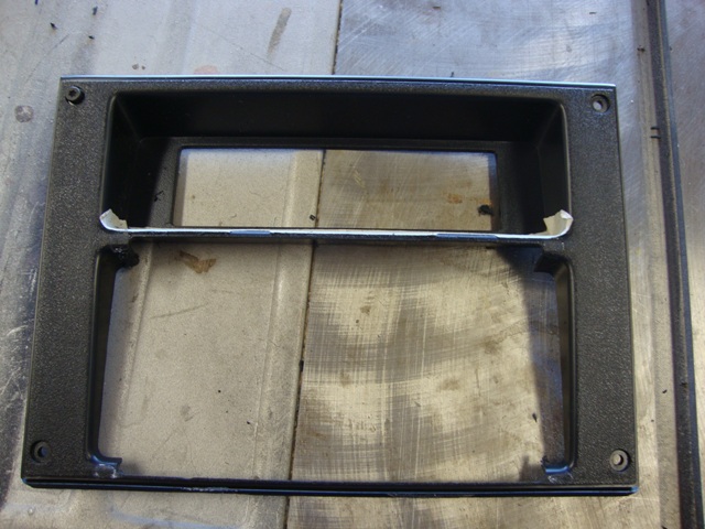

Pic 1 Is test fitting kit on deck. Pic 2 is light body filler to fill in any gaps that may have been missed and masked off where i don't want any texture coating like the inside where AC controls mount and the outside edges of the dash. Pic 3 Is texture coated to match original texture and painted with SEM Landau black paint.

sem black texture spray and sprayed a mist about 18" away then top coated with sem landau black
