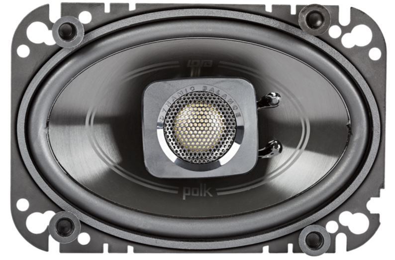

What he's talking about is a 4x6 plate speaker where it has a separate woofer and tweeter. The Infinity has a "plus 1" woofer that is closer to a 5" speaker when compared to the typical 4".
The Kappas are a little on the expensive side ($130 ebay), but do have a built in crossover that balances the woofer and tweeter better than most coaxial designed speakers.
The new model KAPPA 64CFX has a pivoting tweeter than can help "tune" the sound a little. You can move it around to where you think it sounds best, which will be helpful considering how close it will be to the windshield.
Now, Polk makes a plate set (DB461P) with a nice soft dome tweeter that you can get for a little over $62 from Amazon The way it's designed, you could add on a separate crossover later for around $20-$25 if it sounded a little blaring in the 5Khz range.
Both the Kappa and the Polks above have soft dome tweeters that in general shouldn't sound as harsh as the hard dome type tweeters that most reasonably priced coaxial speakers have.
I haven't heard the Polk plate or the 4X6 below (DB462), but they both have a soft dome tweeters - the DB462s are running around $55 on ebay

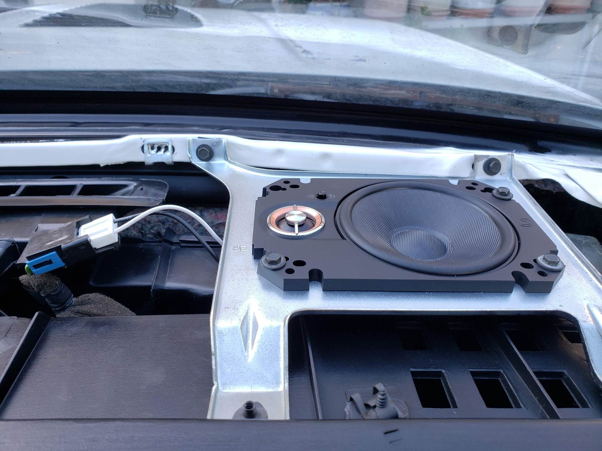

I have recently put the Polk Audio speakers mentioned above into my dash. I think they sound pretty decent for what they are.
Fit was a little tight into an 88 Iroc, but they look nice and sound pretty decent. I figure when I have an amp setup, they will come to life a little more.

Fast Life, did those 4X6 plates require any modifications or are they drop in on an Iroc?
Old Sep 2, 2024 | 08:57 PM
FAST LiFE's Avatar
Posts: 221
Likes: 11
From: SF, CA
Re: Recommend me a 4x6 speaker
No mods needed to install. They fit without issue.

Old thread I know, but I just wanted to confirm the Kenwood Excelon KFC-463C 4x6s fit in the Camaro dash. Had to space them up quite a bit on the driver's side, but they do fit under the dash pad.
The Kenwood Excelon KFC-X694 also fit in the sail panels, but they are definitely at the maximum depth.
