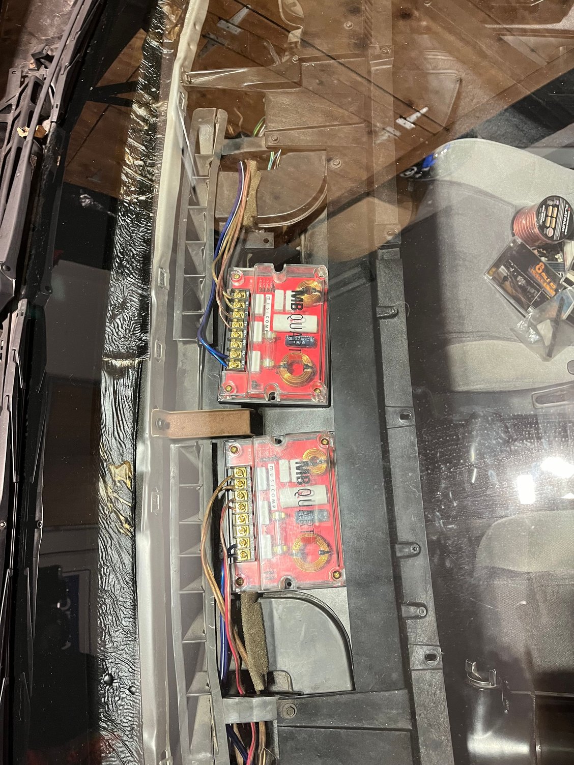

I added some Infinity reference series 6402cfp speakers to my dash a few year back. Details here, including trimming the cluster housing, and the driver's side dash vent duct.
https://www.thirdgen.org/forums/memb...ml#post6053111
thank you, did those infinity speakers sound good enough to warrant the hassle to get them installed? I would assume the newer versions of the infinity’s would sound just as good if not better since they are newer and the kappa series

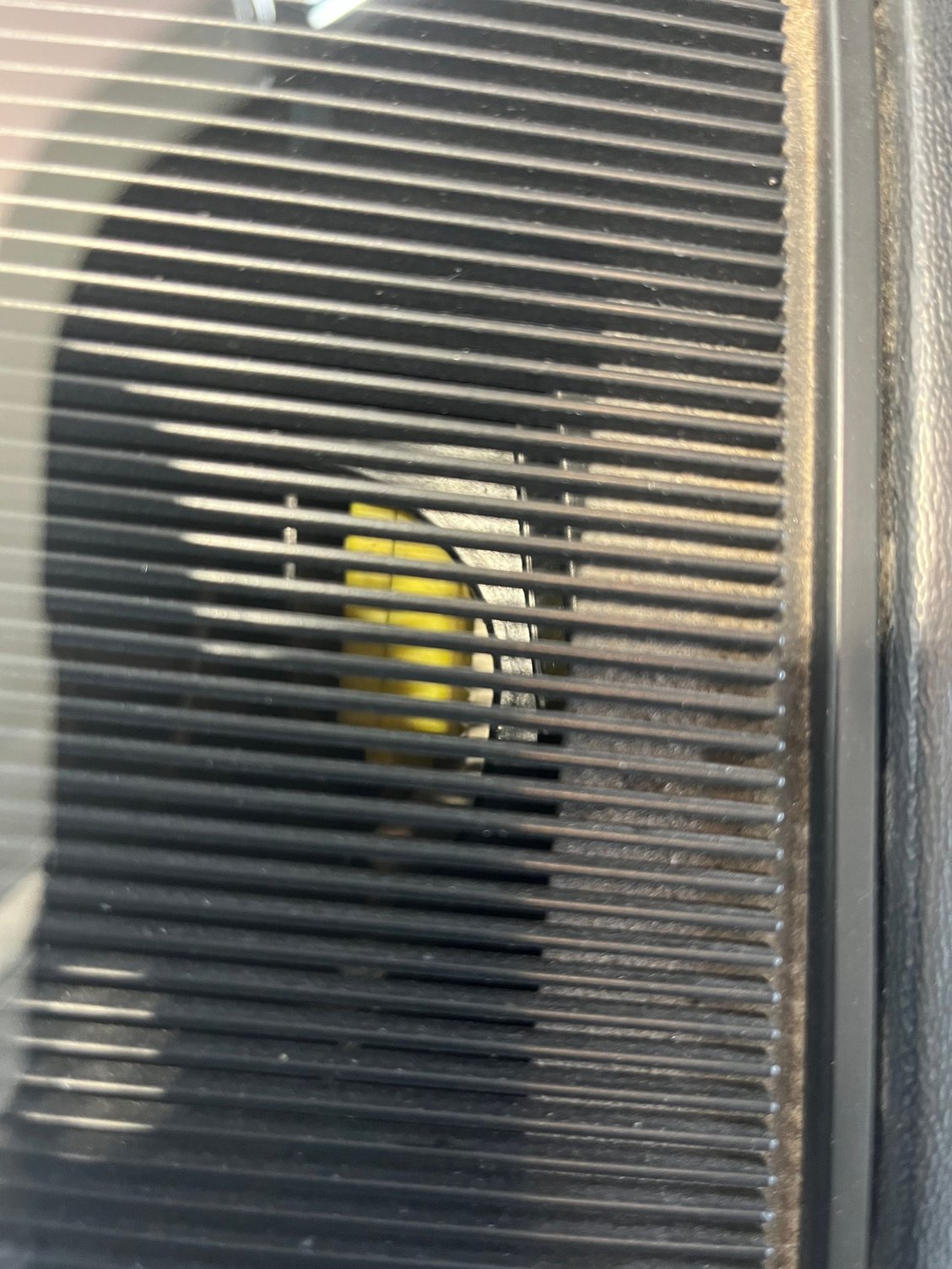

Throwing this potential spoiler out there just in case... but for Firebirds, a Performance Sound option (with a GAIN switch on the dash, a small amp behind the dash and 5" factory subs behind the sail panels) was available and common in 1987, and if you have that, then your rear speakers are 4x6, not 6x9.
The dash requires a shallow speaker with a small magnet and a tweeter that doesn't stick up and out of the cone (much). Mine are Pioneer 4x6 3-ways (not plate). A plate would require the same characteristics. If there isn't such a plate available, there used to be and could probably be found through thorough searches of the net.

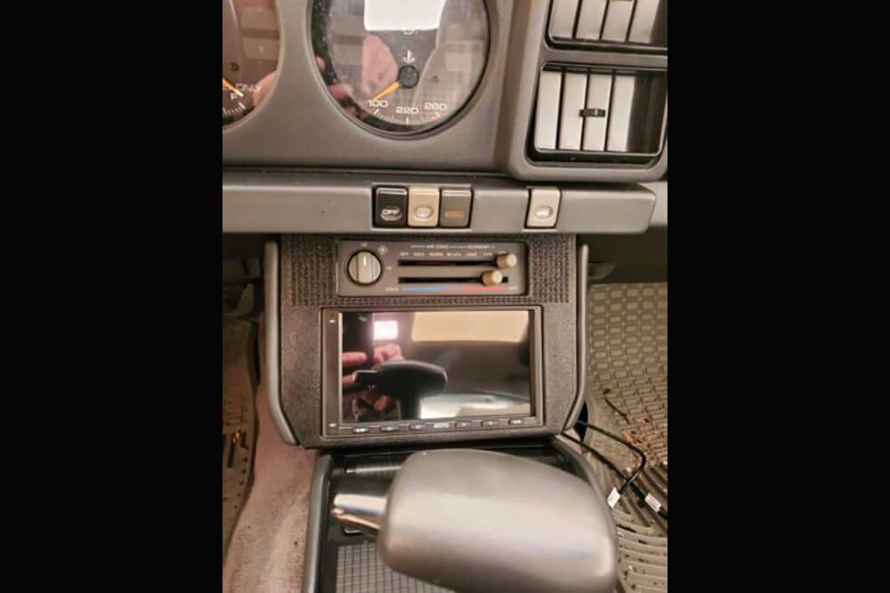

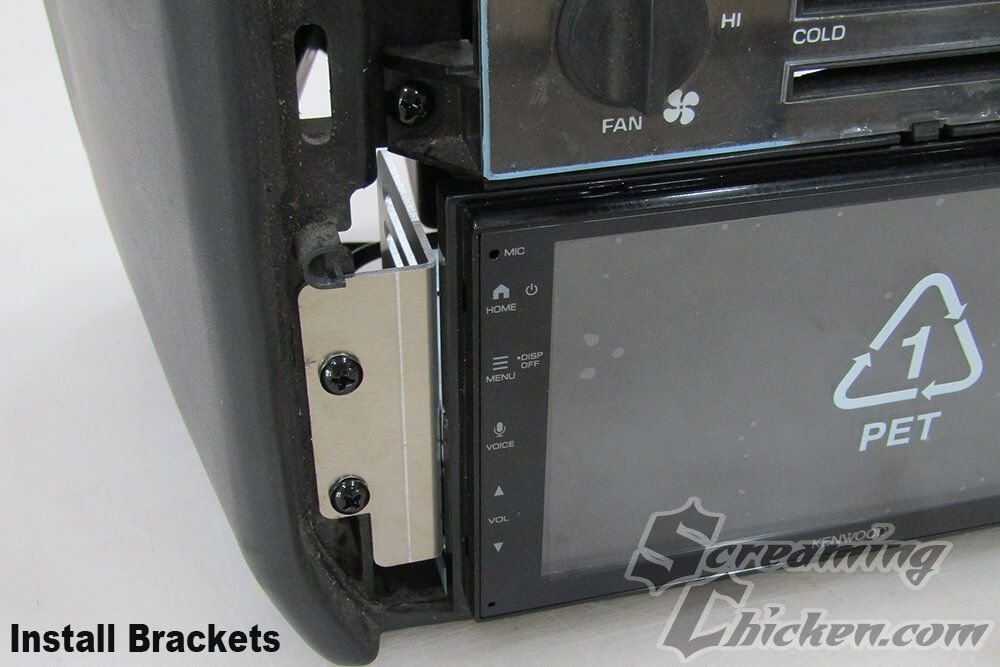

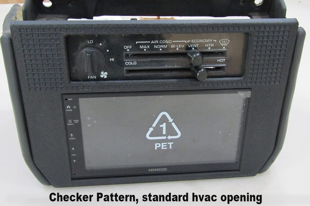

Thanks for update. are you guys unable to replicate the factory checker pattern?
Old Oct 8, 2024 | 08:11 AM
scfbody's Avatar
Joined: Jun 2021
Posts: 370
Likes: 103
From: Azle, TX
Car: 1983 Z28, 1991 Z28 & 1985 TA
Re: Infinity Kappa 4x6 plate speaker fit?
We designed the brackets but don't manufacturer or design plastic parts. What is on the website is the best of the bezels currently available, if a manufacturer is able to reproduce the checker pattern we will sell those if available for resale. Currently all double din bezels are 3D printed which makes them look slightly different. We sell the brackets with no bezel also. Some forum members have modified the original bezel or painted the 3D printed bezels to make them look more factory.
