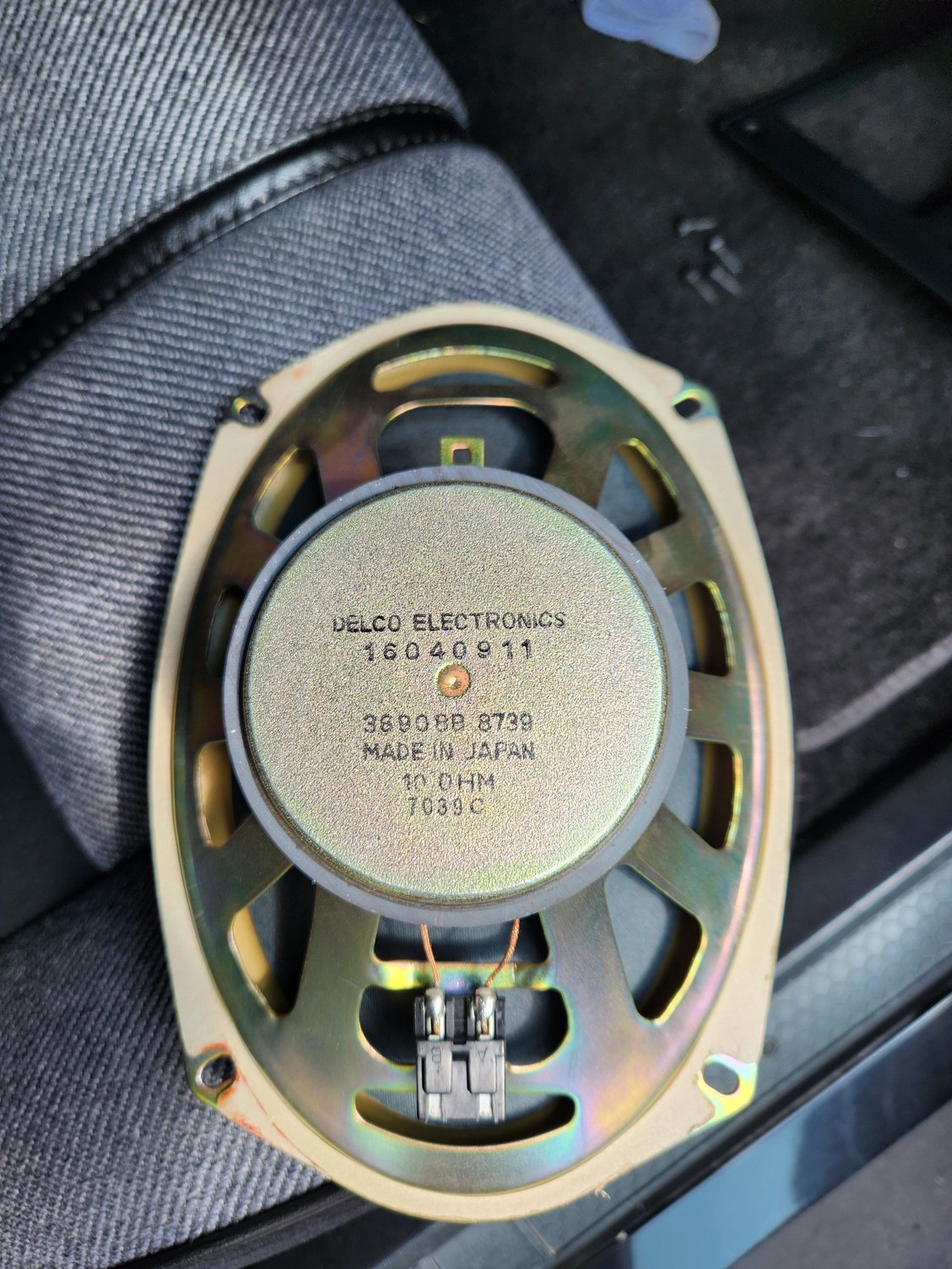

My OEM rear speakers were 10 ohms (see pic). I assume the front speakers are 10 ohms too, but I don't know that for sure.
I am replacing the rear speakers with Sony XS-690GS 6x9 speakers that are rated at 4 ohms.
My understanding is that the OEM HU has an amp for the left channel and a second amp for the right channel. So, if my front speakers are 10 ohms, I will have a 10 and a 4 ohm speaker on each channel, which should be fine...from everything i have read. If my front speakers have been replaced (which I doubt) with aftermarket 4 ohm speakers, I may have issues...or may not, depending on who you believe. YMMV.

fronts 10 ohm or 8 ohm and rears 4 ohms
