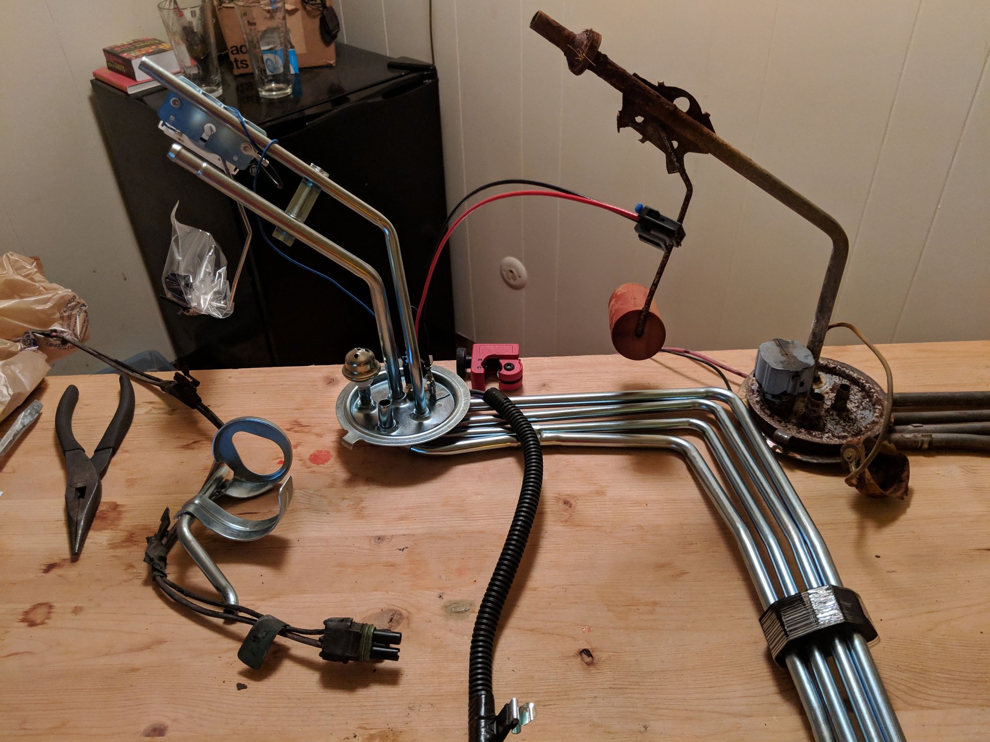

It's all but impossible to find a carb pickup/sender. The FI ones aren't deep enough without the in-tank pump and strainer/sock. If you don't have an in-tank pump, you need to extend the pickup. My tank looked like it was full of chocolate milk so I know the rotting from the inside out. I got a new after-market tank, and a FI sender (expecting an in-tank pump). Added some additional steel line and it works great for me with a stock quadrajet and mechanical pump.
Mechanical pumps are pretty simple if you have a carb especially a stock one. Most are the right pressure already. Just bolt on and go. This is if you have the cam lobe and pushrod (as well as a block that has the provisions for a mechanical pump).
The easiest (least modifications) would be to get a new tank, new FI sender, in-tank pump, and regulator. (and.. as I re-read, maybe new hard line all the way??) More parts, but little if any need to modify anything against it's will.
Kinda depends what you feel most comfortable with, and safe with given that messing with fuel isn't to be taken too lightly.
In the pics the old sender is on the right, new on the left. The one without the sock I cut off the pump mount, and the one with, I added in the extra eh.. 4-5 inches of steel tubing and the sock/strainer.

I ended up having to cut the bolt off of the panhard when I dropped my tank. Sawzall between the two parts made short work of it, easy enough to get a new bolt and bushing.
Only thing to know before getting it all put back together, is try and match the float level of the original unit. I didn't with mine and it reads about 1/4th tank low. (So full is 3/4 for me, etc.)
Also, not shown in my pics, I had to use the pigtail from the original sender as well. The new one expecting the in-tank pump had 3 or 4 leads, while my stock one had 2 I believe. Easy enough to figure out, one was ground one was to the float.
Just a few things you might run into.

Cool. I have the newer assembly for fuel injection, the float and sending unit hang off the return line so I don't have to mess with them. I'm just going to cap off the return since I'm not using the bypass regulator anymore and let it be the hangar for the float.
My strainer is different than yours, it's shaped more like a regular human sock with a brass ring that was press fit over a nylon nipple on the pump. I don't see any good way to attach it to the hard line I was planning to extend the pickup with. I think I'm going to grind an angle on the hard line and forget the sock. I'll have to find a new place to store my coins and bottle caps though

Yeah, mine was an FI sender. What I mean by the float/sender is hold your old one and the new one up. see that the floats rest at the same place. Apparently mine did not. And yes, I bought a separate strainer that had the right diameter hole to fit the supply line. If you have an inline filter before the pump outside of the tank you may not need the sock, otherwise I'd try to get one on that line. It'll save a lot of crap from getting into the pump and beyond.
