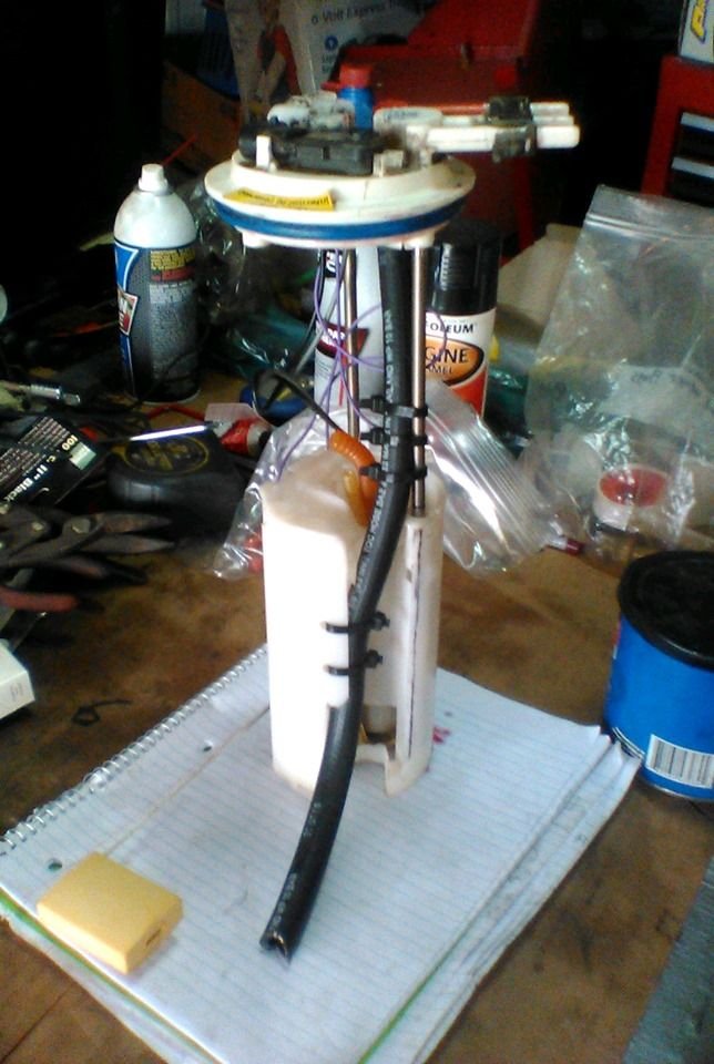

I have another holley carb from my 79 vette that I replaced with the original rebuilt quadrajet I am going to try to install it tomorrow.. I replaced the fuel pump in the tank since it had the access port already cut under the carpet... I will try to run it for a couple of months to check everything else in the car... if the engine or trans is not good I may go another route.. if everything is ok I will order the Holley EFI system

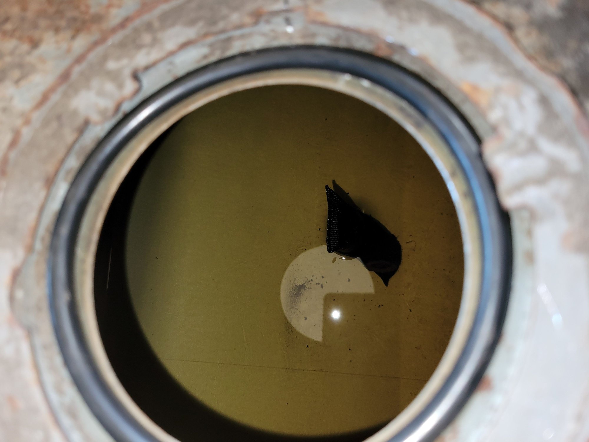

The fuel strainer from the old pump was flouting in the tank I was able to remove it, the tank looks good inside, I added 5 gallons of recreational fuel when I got the car... I guess it is ok to run it... Or do you guys think I should empty the tank and start with 100% fresh fuel? not sure how much it had before I added the ethanol free fuel...
