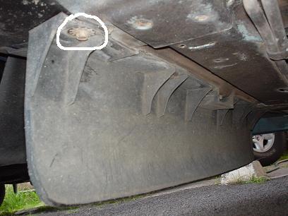

Do you have a AIR DAM under your car?? Without one results in cooling problems.

Look under the car and see if you have one. Major part of the cooling system at speeds above 45 mph when your fans should be off.

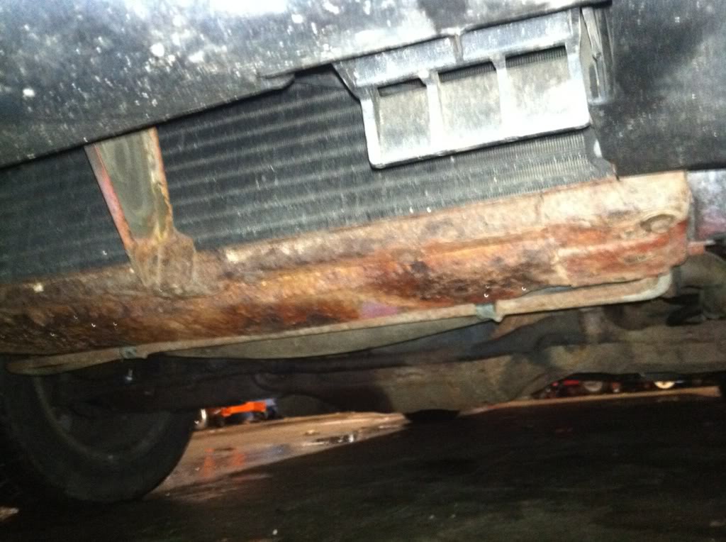

Re: Cooling problem? Or sensor?
I don't think it has one.
Well you found your overheating problem.

Third gen ranch has them for like $30 shipped. But MAN your radiator support is rusty O.O wow!!

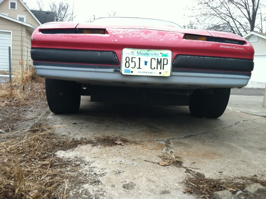

Hey guys just got the air dam on Wednesday.. What I guys think about it.

Old Jan 14, 2012 | 03:17 AM

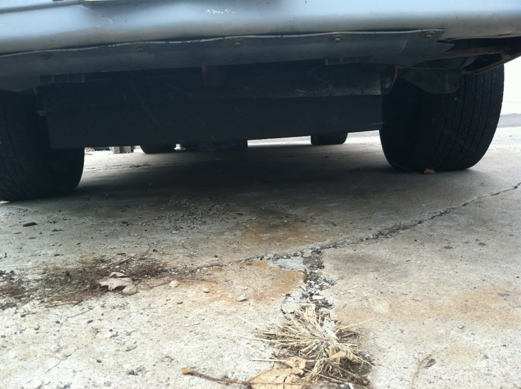

Is it big enough?
Old Jan 14, 2012 | 06:30 PM
Looks good, Let us know if it fixed your problem. After I put mine on it stopped over heating

Alright just making sure it's not to small..
And I wish I could tell you but it snowed the day I put it one (how ironic) and now I'm waiting for it to clear up.
I will let u guys know ASAP as soon as a drive again in the freeway.
