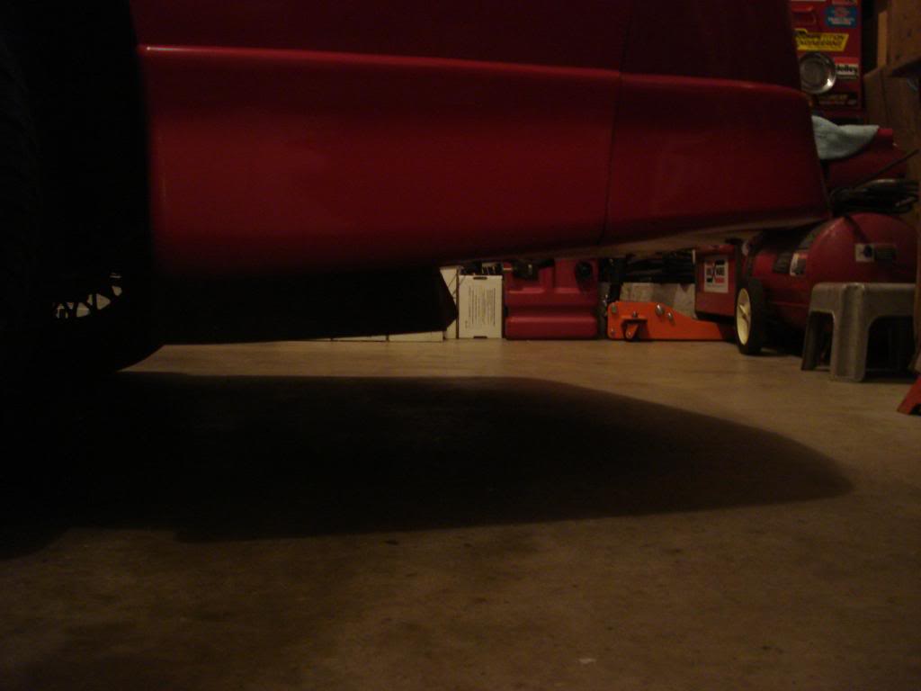

To my eye, the air dam should be leaning slightly forward at the bottom edge like a cow catcher on the front of a train. When I noticed it was bent not just straight down, but slightly rearward at the bottom edge, this is how I fixed it:
First, I stiffened the soft plastic by screwing a thin flat piece of wood on each of the back flat sides of the air dam. Then, I mechanic wired the air dam forward slightly to two existing body bolts that are sitting right there. You might call this a Mickey Mouse repair, but it was free and it's barely noticable. It's crashed into several driveway bumps and it's been good for over 2 years.

I've always thought it would be more efficient if it was angled more towards the front of the car as well. I think I'm going to try putting 2 or 3 bolts in the air dam and running wire from there to some other bolts, I'll let you guys know what the final product is.
