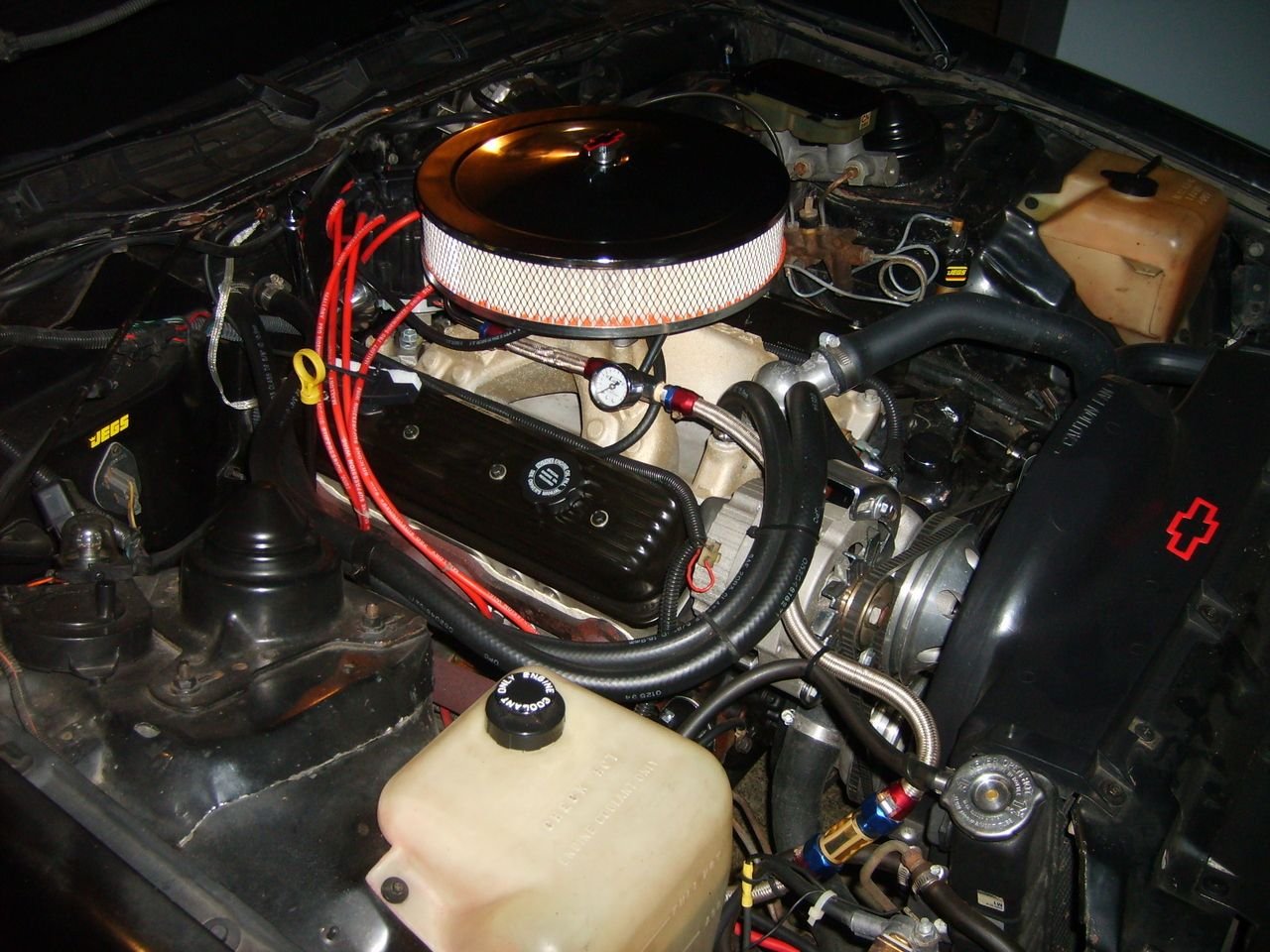

Here's a pic of where the reservoir goes and you can see how the hose is ran. Hope that helps.
