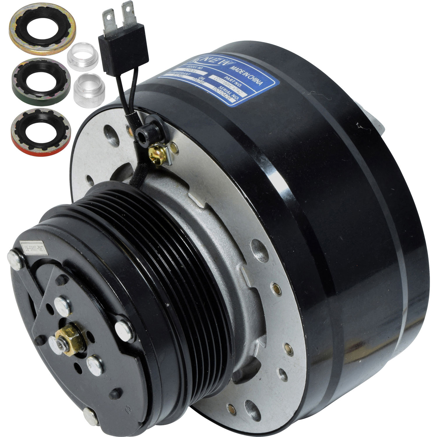

Aftermarket R4 Compressor from UAC - Scroll Design!
While looking for a new R4 Compressor, I found an aftermarket company making an R4 but in a Scroll design! No Pistons. I would think the Scroll type with less moving part would me more reliable. They are on eBay and Amazon.
Anyone have any experience with this?
Amazon Amazon
Amazon Amazon
The eBay ad says its a Scroll Type:
http://www.ebay.com/itm/351947764990?rmvSB=true
Thanks
Waid
Attached Thumbnails Aftermarket R4 Compressor from UAC - Scroll Design!-universal-air-conditioner-uac   Aftermarket R4 Compressor from UAC - Scroll Design!-universal-air-conditioner-co

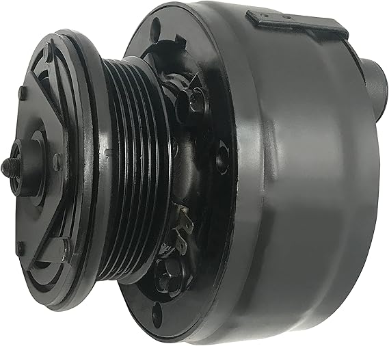

Hey Dave
This is the one I put in my 88 last year....New AC Delco, from Rock Auto
ACDELCO 1520227 {#01134351, 1134351, 88964869} GM Original Equipment; w/ Clutch

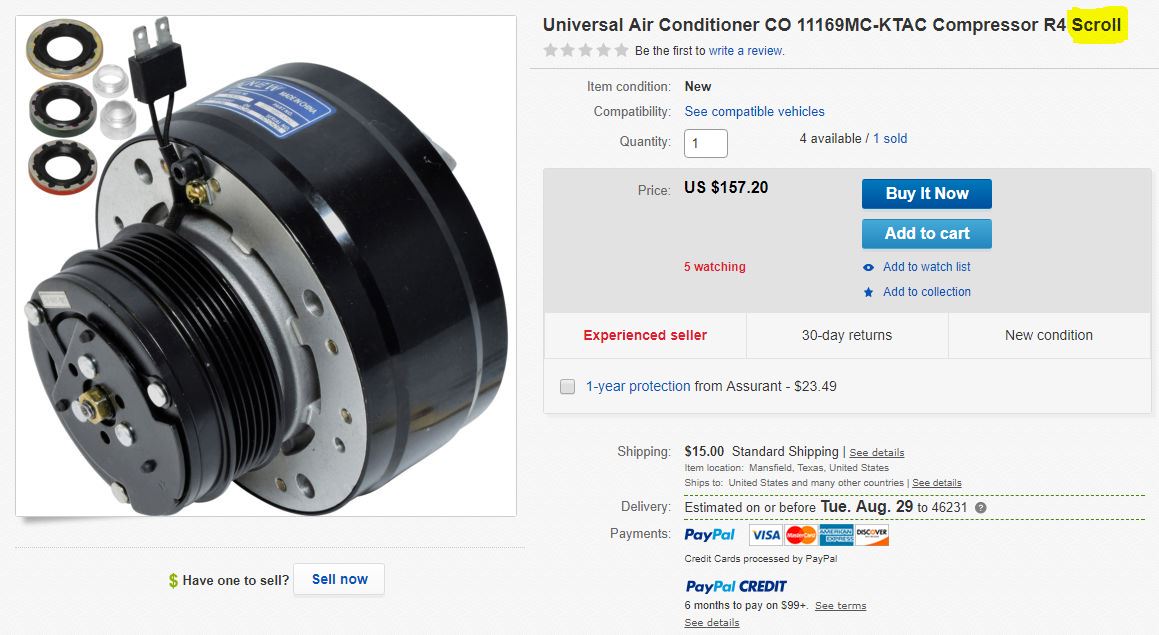

If you search for 11169MC-KTAC on eBay you find this:
http://www.ebay.com/itm/Universal-Ai...JZW~XW&vxp=mtr
This ad clearly states its a Scroll. If you look at the inner Aluminum Case, it is completely different. It does not have the 4 bolts that houses the front cover.
Waid
Attached Thumbnails Aftermarket R4 Compressor from UAC - Scroll Design!-scroll.jpg

OK, I see it. I only looked at the two Amazon links. Thanks.

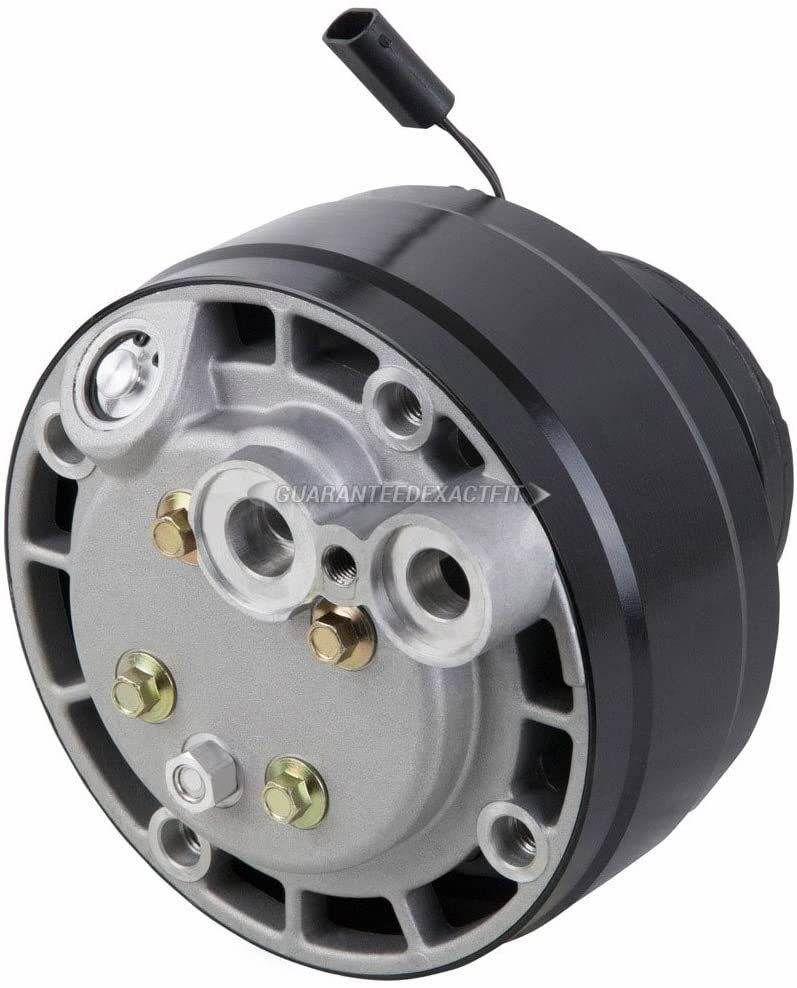

I do find it very interesting that this company went out of the way and decided to re-engineer the R4 instead of cloning it.
Here is the back picture of the compressor. It appears that it is a small scroll housed in same case. I am sure there are no large o-ring under the black steel case which has been leak issues with the original R4.
Waid
Attached Thumbnails Aftermarket R4 Compressor from UAC - Scroll Design!-51oskyx3itl.jpg

Are you in any way affiliated or associated with the folks making, selling, or advertising these compressors? Somewhat kidding, but it wouldn't be the first time someone created a shill acct to advertise a product on here.
It'd be interesting to know how they work compared to the R4. The R4 is the most troublesome part of thirdgen A/C systems, and the unique nature make it difficult to retrofit something better. These look to be something of a generic compressor modified to fit in the R4 hole. It's interesting but ultimately someone has to guinea pig and proclaim how well it works before the forum jumps on the bandwagon and hypes them to legendary must-have status. The price isn't too much to take a gamble.
I do wish the clutch pigtail was hard mounted like the OE. It'd have a better chance of going unnoticed that way. Some black paint and most people wouldn't know the difference...
Buy one and let us know how it works out.

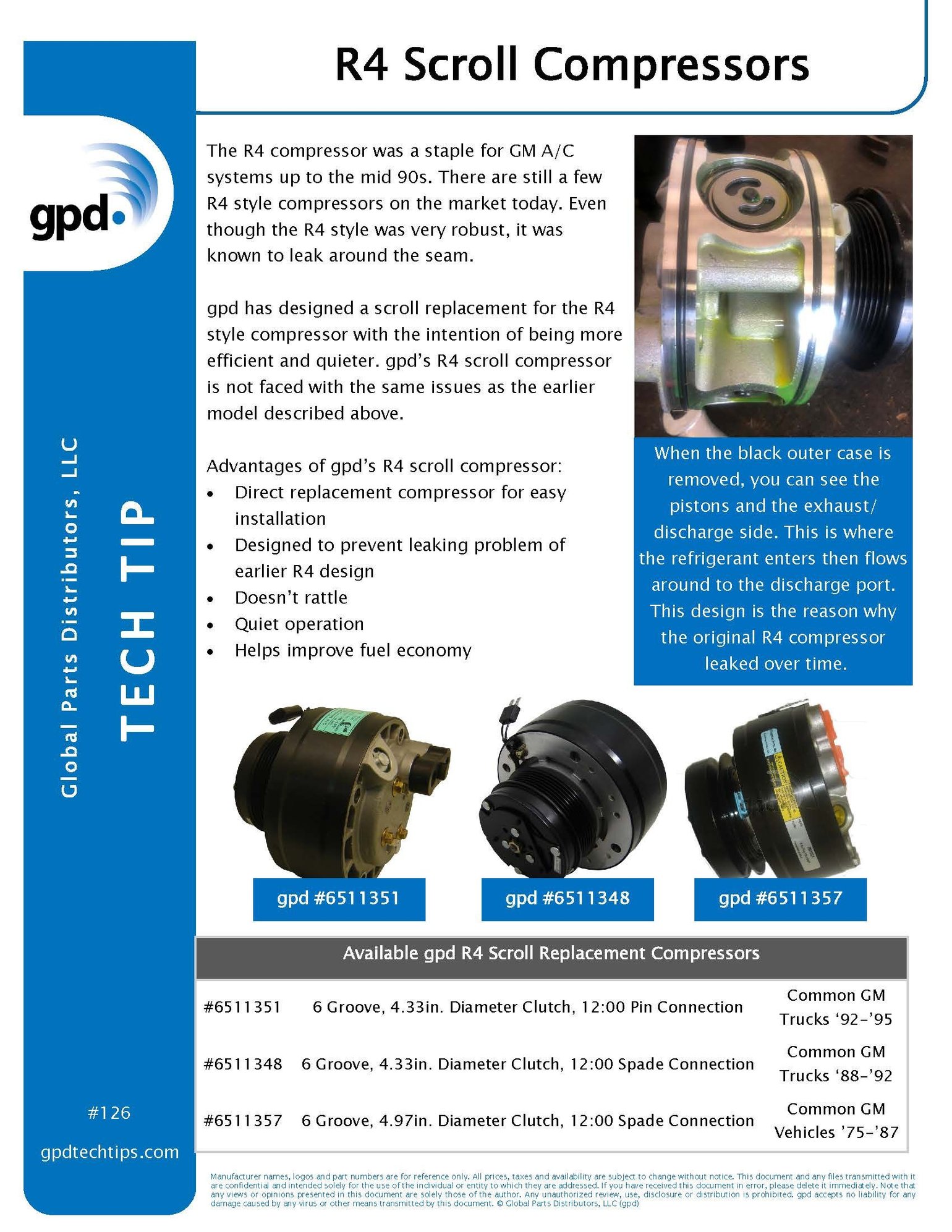

Not at all. Matter of fact, I found another company making alternative to typical Piston R4.
One is Universal Air Conditioner (UAC) and other is Global Parts Distributors (GDP). I assume they are competitors to each others. The one from GDP is available though RockAuto. UAC sells lots of stuff through Amazon and eBay.
https://uacparts.com/
http://www.globalpartsdist.com/catalog/
http://www.rockauto.com/en/moreinfo....582356&jsn=253

Re: Aftermarket R4 Compressor from UAC - Scroll Design!
Originally Posted by RJ IROC
To relate back to the OP, I still think the scroll type is going to suffer the same leaks the radial R4 does. You still have a shaft seal, and O ring seals between the body and outer shell (the outer shell still has to seal somehow). Those were leak points on the originals, and they're still (potential) leak points on these retrofits. You can rebuild a mechanically solid R4 for less than $30, and there isn't a lot of work involved.
Not True. The black steel band around the compressor is for looks only. There is no rubber seals like the old R4. Look at the back of the compressor and the ribs. They probably took an existing scroll compressor and packaged in old R4 size. See the attached two pictures.
Old Jul 28, 2021 | 10:23 AM
waid786's Avatar
Joined: Dec 2010
Posts: 45
Here is more info.
Although I doubt there is any kind of seal between the body and the outer shell in this design, I will agree that rebuilding a compressor is a good option. The issue however isn’t the difficulty or cost, it’s the tools required to separate the outer casing.
I looked into this quite a bit when I was weighing my options and the two methods I found were to either use a special tool that pulls the outer casing off by tightening bolts, or to use a hydraulic press combined with a second outer casing taken off of a sacrificial scrap compressor. I’m sure there is an easier way to remove the outer casing that I simply didn’t come across, however I will say that given the cost of tools for the process, a new compressor made a lot of sense. We’ll just have to wait and see how long it lasts, but based on my experience so far I expect it to be a long time.
