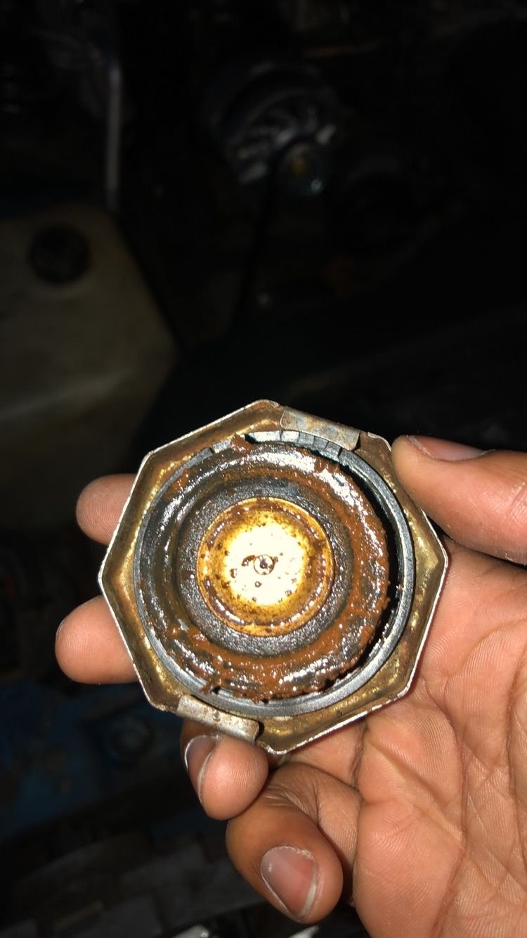

The previous owner of my car basically let it sit for awhile and didn’t really do much to it, I noticed I had all this brown gunk in my radiator and flushed it with at the mechanic with water and coolant but I don’t know think he flushed it thoroughly, should I flush the entire system and block or should i just replace the radiator?

Well, the radiator is aluminum and plastic, where do you suppose the rust originated from?

No idea... I’ve had the car almost 3 months and I’ve put a lot into it so far, this was the first issue I noticed when the mechanic popped off the cap and it threw up

Engine block rust, bars leak residue ! Or glycol mixed with dexcool

What I was getting at is that aluminum and plastic don't rust. Rubber hoses don't rust. So what does? Cast iron? Like the engine block? Yep, cast iron will rust. So you need to pull the water jacket plugs out of the block, flush all the garbage out, and go from there. Otherwise the garbage in the block is just going to mix with your new fresh anti-freeze and contaminate it.
