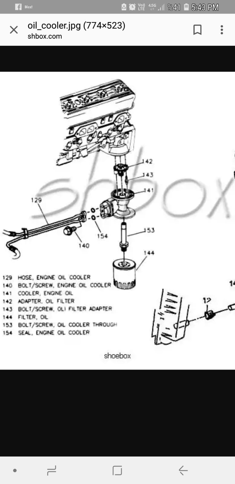

I need an oil cooler (see on the attached schematics part number 141 and the actual pictures below that one) for my 1991 Camaro Z28 5.7 L G92 sports package; it is not available anywhere in the market:
1) Please advise if you may have a decent one, that is, one from a car that has been periodically maintained in terms of antifreeze, allowing the part to maintain its proper functionality.
2) Further advise about the reliability and durability of this actual part if I were to clean it and reuse it.
3)Also please provide me w/ a GM part number, if possible, which may greatly facilitate my after-market search. Thank you in advance.

I would clean it and reuse it.

If all that's wrong with that oil warmer is that rust accumulation, you can clean that up easily enough with a good blast from the garden hose followed by baking soda.
Reliability will be no different than if you didn't clean it.
AFAIK GM no longer has that available; and aftermarket oil coolers are actual coolers, unlike that one, which is a warmer designed for more quickly getting the oil up to temp during cold startups.

Interesting... The schematics I attached it to my original post designate it as an engine oil cooler; I am confused. I was thinking about going w/ an after market cooler ( https://www.ebay.com/itm/7-Row-AN10-...d/282424056557 ) since I figured there is a potential problem where the corrosion inside -if severe and probably is, due to continued and lengthened use w/o anti-freeze- may lead to an actual break between the oil/water barrier and to a catastrophe. PS: I have a plug inlet on the oil pan that literally attaches to an electrical outlet for severe weather to warm the oil before the start-up

The "oil cooler" on these cars brings the oil up to hot-water temp. Which would ordinarily be around 200 - 210 in a stock cooling system. I suspect that in a street-driven daily-driver type application the il would rarely ever get that hot. Intended for police cars and similar fleet applications, where the users crank the car up and more or less immediately hammer the throttle; also popular on trucks, for the same reason. That's VERY hard on a cold engine since the oil is more like candle wax on a cold morning. The "cooler" helps get the oil flowing quicker. It's not AT ALL the same thing as an "oil cooler" on a race car, which is designed to shed as much heat as possible, on the assumptions that (a) the driver is going to warm up the car correctly (acoupla parade laps etc.) and (b) SO MUCH waste heat is going to be produced that the oil needs all the help it can get to keep from turning to something about as thick as acetone or whatever.
Not much sense in continuing to use it if you install an aftermarket one.
You don't really lose much by doing away with it altogether. People do it all the time because the lines (steel) rust through. I haven't ever seen anybody post on here about theirs exchanging oil & water though, so it's probably not much of a concern.

Oil gets hotter than coolant. That is indeed an oil cooler. But it also helps bring oil up to temp quicker because the coolant warms up faster than the oil. It serves both functions.
Cars that actually race need more oil cooling and often use an air heat exchanger. Those need to be tamed on the street though because there is too much cooling for normal driving. The solution is a temperature switch that mostly bypasses the cooler until oil is up to temp.

Boil it, flush it thoroughly, repaint, and you're good to go.

Yep, I agree. And if you do away with the cooler your oil filter install can get tricky. The water to oil cooling is better than you'd think, compared to air to oil. If the hoses are good I'd clean it and use it.
