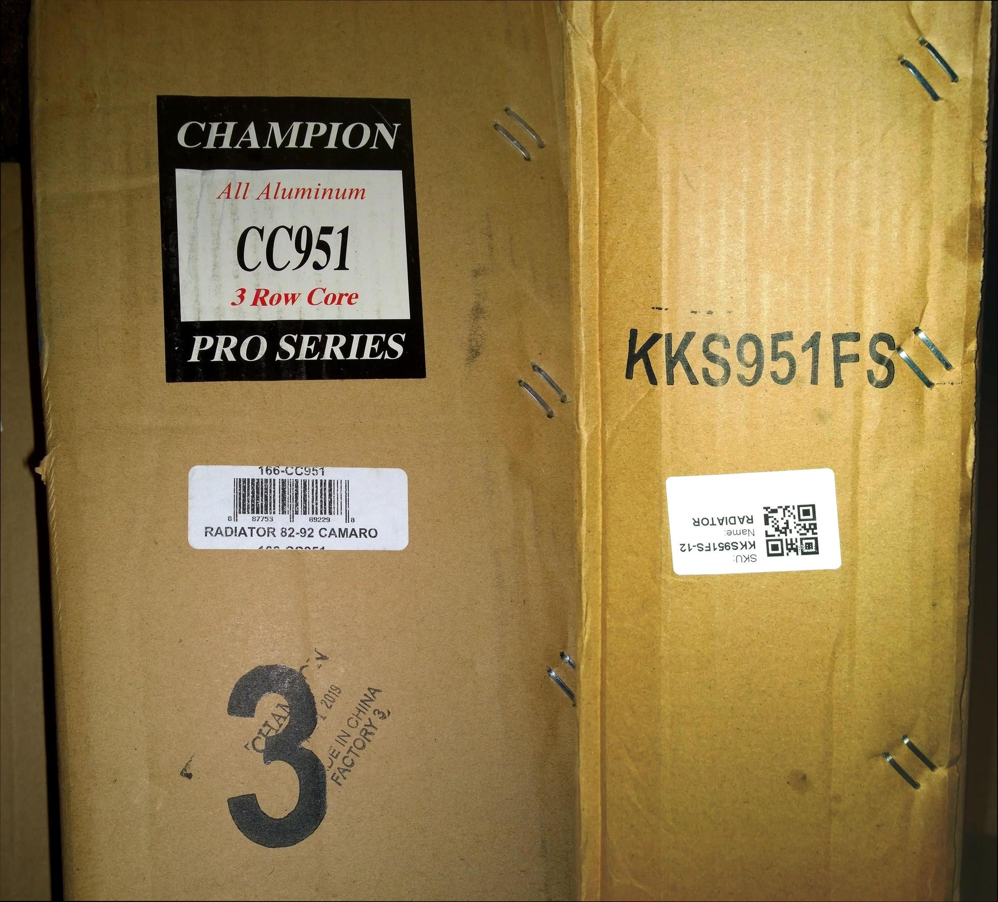

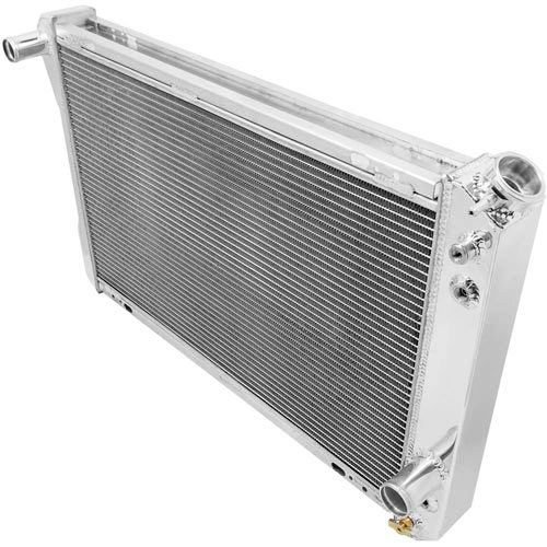

My son and I just bought the Champion 3-core aluminum radiator from JEGs. It will fit with some minor changes to the rubber isolators. But we don't want to use stock fans because a 383 long block is in the future. We're looking at options, like dual 12-inch fans and a shroud. I like duals because if one motor goes out, you still have some cooling. The fans will operate together rather than staged. Does anyone know of any brands that will fit? There are a lot of options out there, but the trick is finding one that will clear a larger radiator.

I have that exact radiator. It drops right in. Any fans that fit on factory radiator will fit on that.

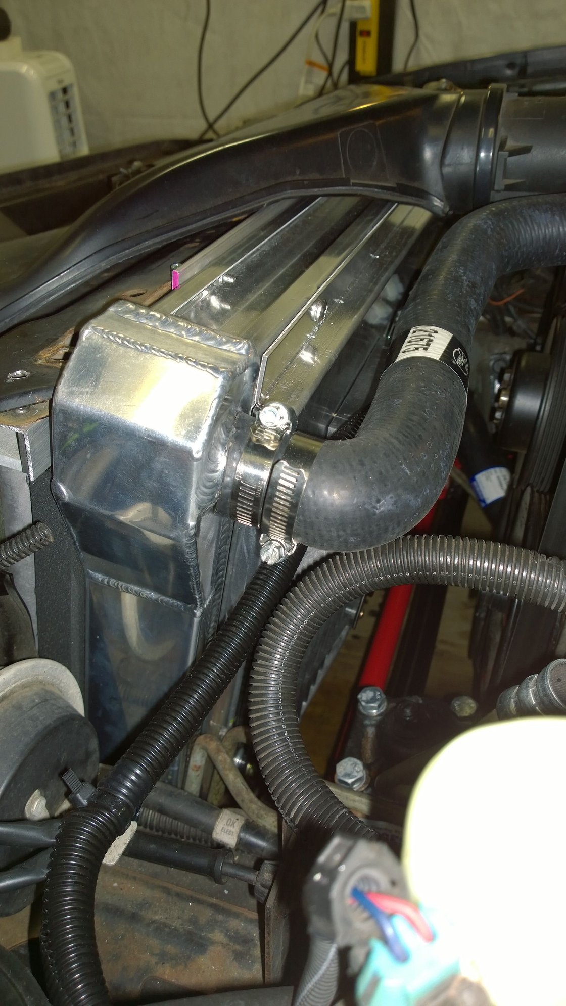

I went with a Champion 2 row radiator for my 406 sbc. I have a post about it here with photos:
https://www.thirdgen.org/forums/cool...tor-water.html
my setup is NA and I know you are boosted (I am a subscriber on your youtube channel). my setup works like a damn dream. I have no AC either. simply just the radiator with my stock OEM fans and NO shroud either. the holley sniper controls the fans (each on their own relay) and they come on at different temps. my engine will run between 179-185 deg for hours and hours.

thanks. correct, I am not boosted and not running AC, so there is a direct path from the front nose/grill openings to the radiator for fresh air too pas through the radiator while in motion. I also have a fully intact air damn in place. I run Evans coolant too. As for firebirds, like the OP has, they don't have the grill openings for air-flow at speed, so that presents another obstacle for him to deal with. LSX matt was just troubleshooting high coolant/engine temps in one of his threads.
For me, I had no idea/predictions on how my setup was going to work, but I knew I wanted a new radiator, evans, high volume water pump, 160 deg t stat, and to re-use my oem dual puller fans. If all that worked (which it does) I was going to be satisfied. If it did not, I was going to go down the route of adding a shroud for the fans, and whatever else was needed. Fortunately for my setup, everything worked and I have 2,300 miles on the engine, cooling system, everything since March 2020, including 5 days making passes at the dragstrip, 2 autocross events, and several multi-hour cruises. So it seems set.

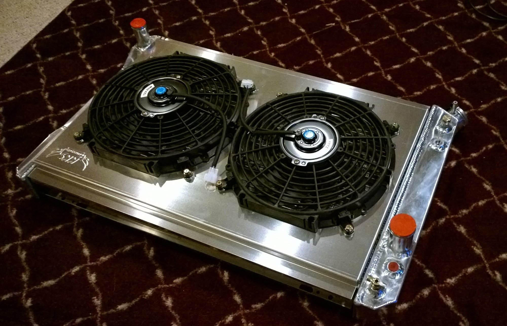

We bought the 951 fan and shroud combo shown below. It fits and works great. We're going to be taking the Iroc out for some extended driving and sitting in traffic to see how it works. The Champion radiator also has 951 in the part #, which is a giveaway. Of course, the delivery people (or someone) just HAD to drop it on one corner (bottom picture) but that was easy to straighten. When I bought the Tenhulzen alignment system with the aluminum toe/camber/caster plates, one edge was bent like this also.

small update: after a year of pretty heavy street, drag, autocross and general aggressive driving my radiator has done its job of cooling AWESOME. zero complaints performance wise. However it has developed a small pinhole leak and is leaking my Evans waterloss coolant out slowly. I contacted Champion and they stated that since I have a lifetime warranty on the radiator, I could pay to ship it back and then they will ship me a replacement. i asked them if I could wait until winter time when the car is completley off the road, and they said sure! So that is promising, will let you all know how it goes.

We're having a weird issue. Around town and idling in traffic, the fan & radiator combo works great, 25-30 degrees under the stock single-core and fans. But at freeway speeds, even in overdrive with the engine loafing along, the temperature climbs to 250. Normally, at Interstate speeds the temp goes down or stays the same. The fans are both pulling, so they're not fighting the wind. We had to mount this big guy differently, and I used 1-inch square foam rubber to seal the front edge against the A/C condenser, and I think that might be causing fan cavitation. The fluid levels are spot on, so that's not it. We're using Prestone 50/50, new of course. I'm wondering if we should have bought a louvered fan shroud, but there's not much free space for that much air flow through the louvers anyway.

Reinstalling the air dams took care of the highway speed temperature increase, and it even seems to help at low speeds, but the temps have been only in the low 70's so we won't know until summer.
