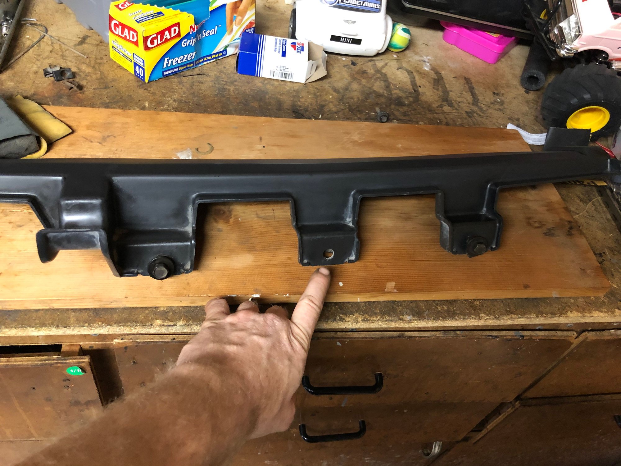

Bingo. The LG4 is stingy on power, 14-15 Hp is 10% of rated if I found the correct data. I do plan on adding a cam, and if a guy was to show up on test/tune night it’d be great to have a means to cool the engine “on demand”.
I bought 2 sets to find enough bits to cobble a complete dual cooling fan setup together - couldn’t find one single fan setup, but double fan setups line the ditches locally (Canadians are big on A/C). Or at least I think, I know I’m missing one rubber isolator, and I’m hoping the mechanical fan uses the same.
What went in the center location? There is an m6 folded nut, but nothing in place?

Nothing went there,....... I've cut that 'tab' off the upper shroud on just about every dual fan I've ever owned.

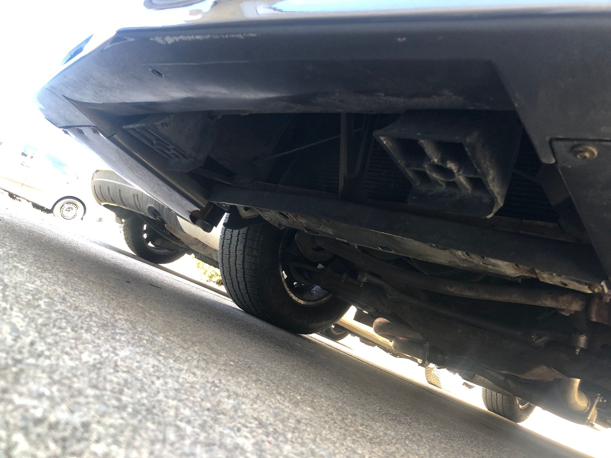

Well, that didn’t last long.
First trip over 50 mph resulted in the car running at about 3/4 of the gauge (with the mechanical fan it would run at half of the gauge). The coolant wasn’t boiling in the surge tank, so not an overheating situation.
I’m missing the air dam from the bottom of the bumper: the mount still appears to be in place?
Recommendations on where to buy?
