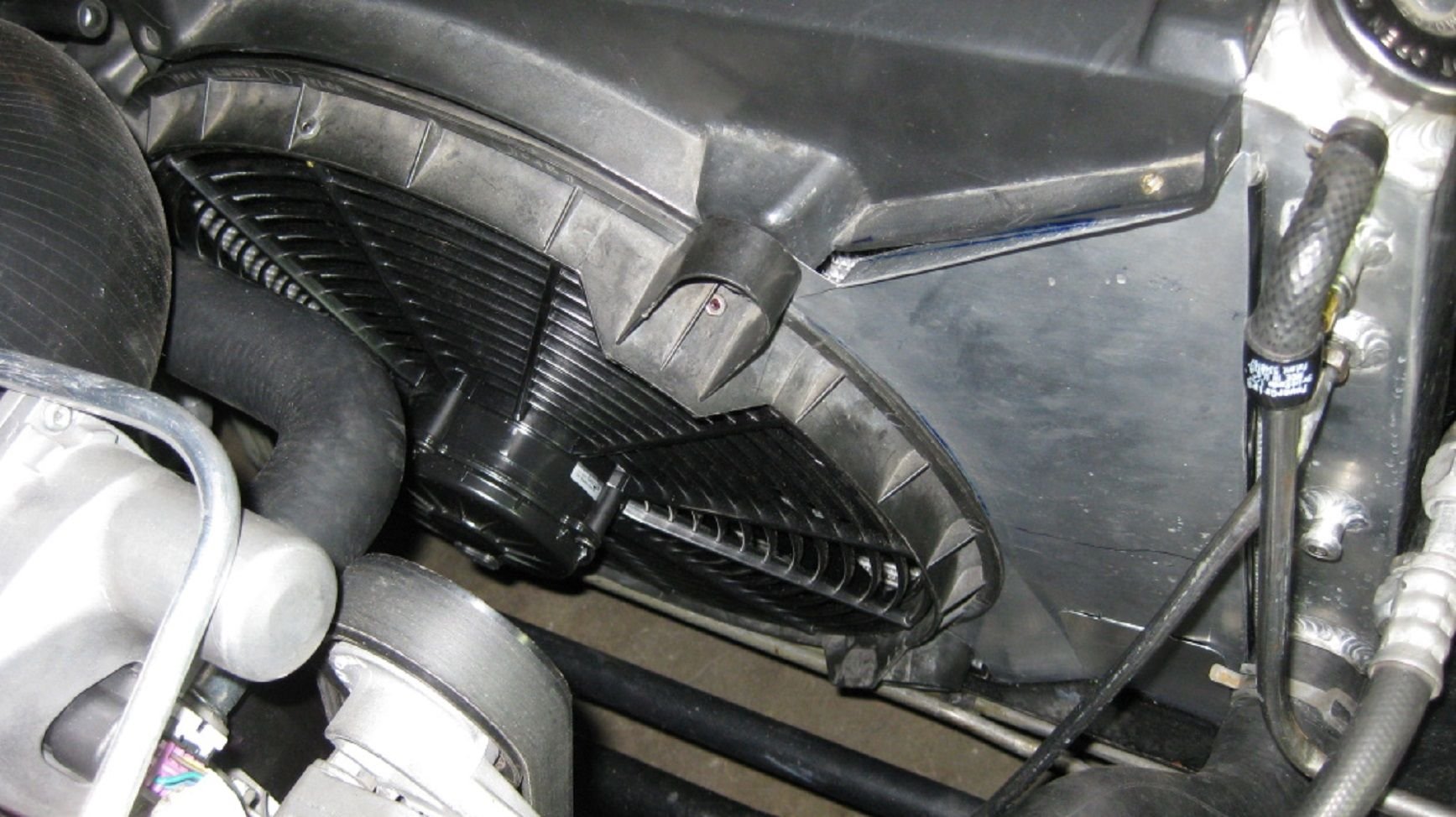

16" Spal fan w/ homemade shroud. CFM is a little over 2k, but spal rates their fans with a load, as opposed to most others.
