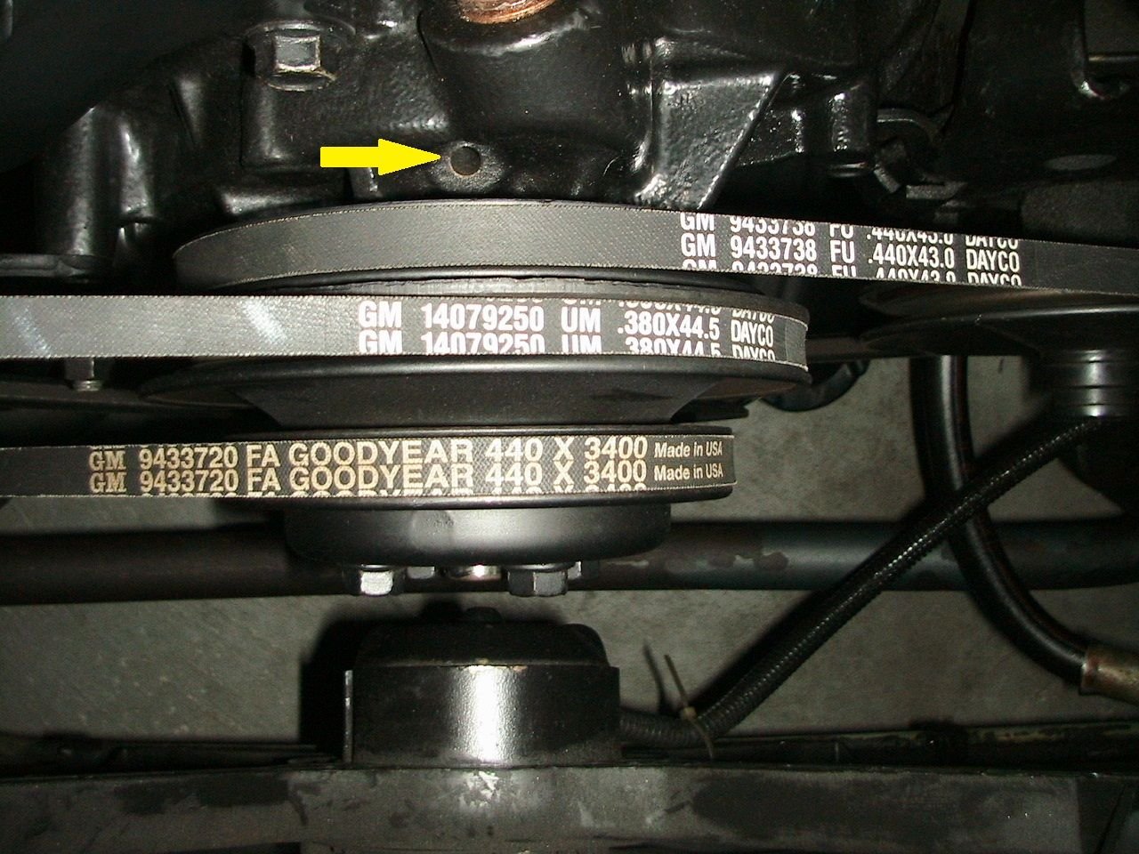

How about the "weep hole" on the water pump underside?

Where is the weep hole I want to check? I have cleaned everything off multiple times and don’t really notice anything dripping off the engine thankfully. It is always leaking off the cross members under the radiator.

Use a mirror to see the weep hole . It’s underside of water pump.

The weep hole is inside the pulley. Probably can't be directly observed.
Get up under the car and look at the rear/bottom of the lower rad hose. If you see evidence of coolant running down there, it needs a water pump.

Some Pumps Have 2 One On Top One On The Bottom

Thanks for the info and pictures, I will check it out when I get home tonight.
