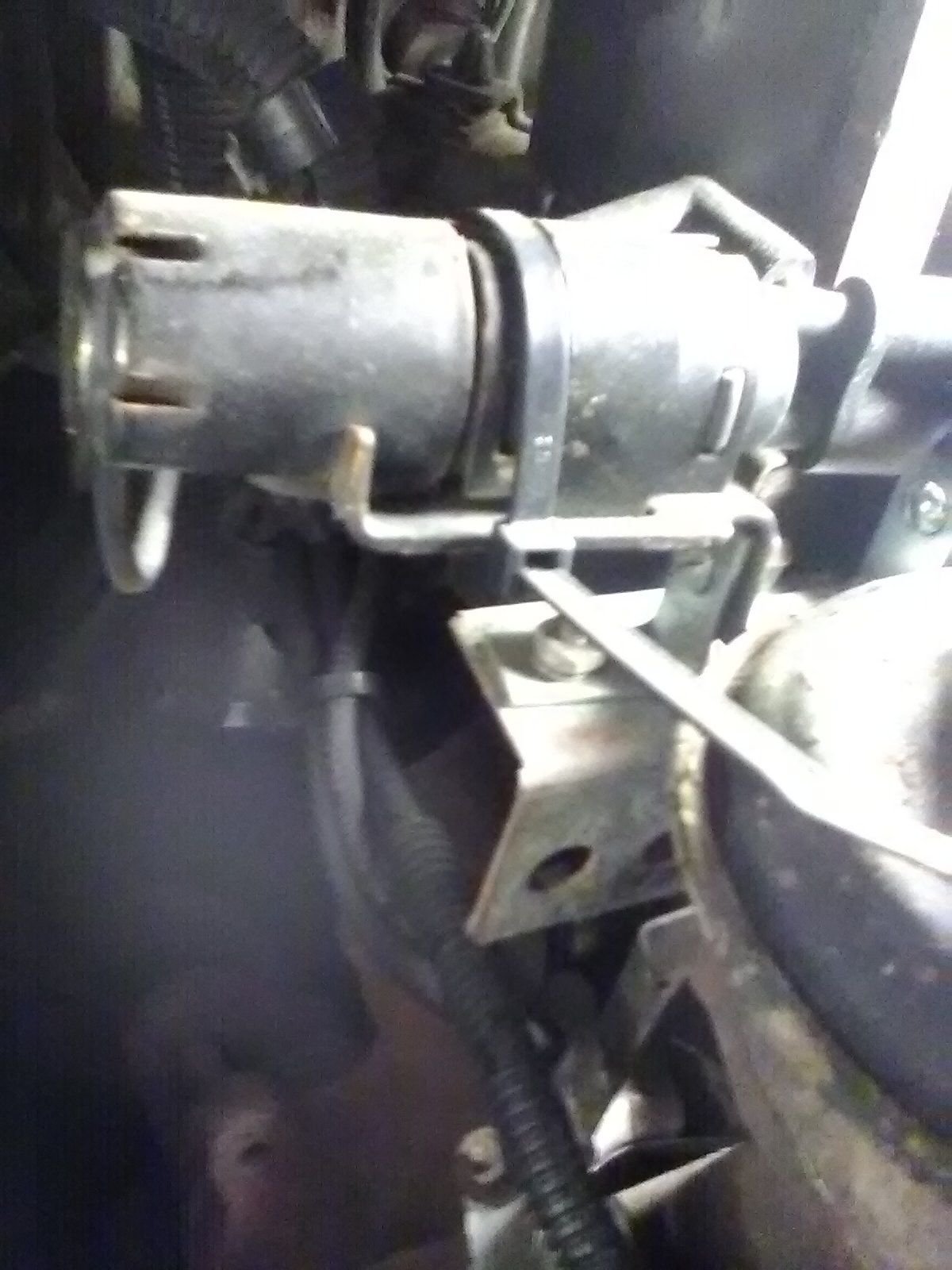

I have a similar problem. I changed the cap and rotor and separated a vacuum line. Now I cant get any airflow through the interior vents. I attached a pic. The pic is of a 3-way line connector where one of the connections is broken. Is it just a 3-way connection or does it do something else? If so what do you call it? I have a early 80s Haynes manual, but don't seem to find a applicable vacuum diagram. (The car is a '87 V-6 EFI) Can I replace the connector or should I try to rig a repair? Appreciate any tips.

That part is called a three-way vacuum check valve. Dorman still makes them.

It's a check valve with 2 ports on one side of it. You can accomplish the same thing with an ordinary 2-port valve and a T. The end with 1 port goes to the intake manifold; the 2 ports on the other side together go to the cruise control and the HVAC controls.
In any case, you can find one hanging on a card in the Help! (Dorman) aisle of your local corner parts store. Sometimes they have them by the PCV valves (in the filter section) also.

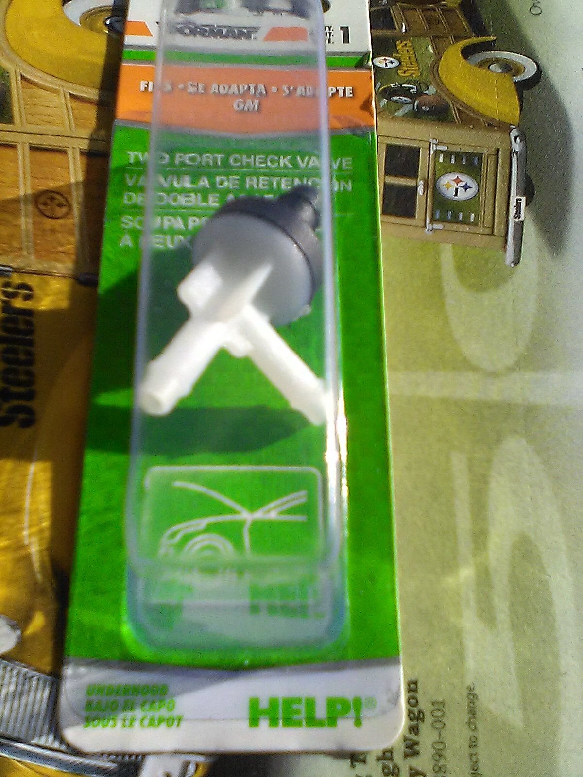

Thanks for the feedback guys. I found a Dorman 3 way check valve at my neighborhood chain auto parts store today (see pic). Good thing, the original was so brittle the hose barbs came out in pieces. I'm happy to say it worked and I now have airflow thru the dash vents.
I've attached another pic of what I presume is a vacuum solenoid? Its about the size and shape of a roll of quarters with vac lines connected (and also brittle) . Any suggestions for a part number or replacement? Thanks again

What is the part number for the Dorman three way check valved, that worked ? There are several choices.

Dorman Two Port Check Valve part#: 47150
