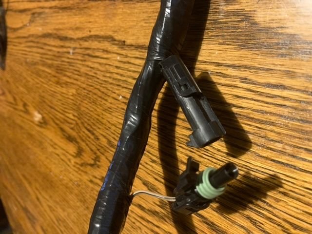

What is this connector?
91 z28 tpi. Tan/black stripe wire going to each half.
Upshift indicator with manual transmission
Manifold air temp sensor? Makes no sense. Approx 3 feet from bulkhead pass thru connector

I believe that is the EST bypass connector.

That’s a good idea. However, I know the basics and the general function but that is way different from seeing actual pictures of the actual components used. Auto manufacturers are know to switch parts in mid year, suppliers in mid year, etc. Type in MAP sensor connector in google and get pics of parts that kind of look what you have but it’s a different color or not quite the same shape. Did the OP use a Genuine GM part or some cheap alternative? So you are not sure so you come to the experts at TGO for some help. Snark and sarcasm are never helpful. I’m an older guy and I love to help guys on their projects. I make sure they do the work or most of it but I will gladly guide them. I looked all over for a definition of a EST bypass and what it does. Still looking. Dare I ask what it is or should I go “buy a book” at this early stage of just cleaning and sorting out a wiring harness? I’m nowhere near ready to put this on the car but I’ve got all the hardware sorted out and together, now it’s time to get the part of the project that scares most people away from these swaps, the electrical.

you will be well served by getting a real service manual, you are right changes do happen year to year and i ended up buying the real service manual for each year... mostly the same but confident in knowing what is going on. you can get them from HELM or find them in other locations
your EST bypass will allow you to set the base timing, ie 6 to 10 deg typically... opening that connector basically disconnects the ECM from the advance equation ... the service manual will explain this and you will be able to see with confidence the schematic and understand what is going on
