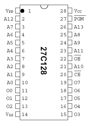

? You got some sort of piggyback adapter?
a prom 27c128 has 14 legs per side.

That's what was meant, it has 14 on the bottom & 14 on the top so 28 pin
