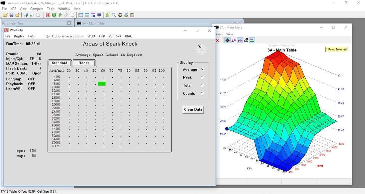

I installed the ‘89 ESC and that has cleared up the false knock.
So, yes... you need the matching ESC for whatever knock sensor you are using. The 82 ESC will report false knock if you use an 85 - 89 knock sensor.
Here’s what the table is shaping up to look like. It’s running great now- but still have some work to do with the VE for AFRs during decel and coast.

If you are getting a lot of counts currently then reduce SA in those areas. As long as they are "true" knock counts. Then start on your VE tables with the WB. Once those are in line can use the WB to help get your PE in line. Once fueling is "close" you can revisit your SA and slowly bring in more until you start getting counts again. Reduce SA by a couple points in the areas you get knock counts for a safety against bad fuel. Then do some final minor adjustments to the VE/PE tables as the changes in SA will affect the fueling.
This is the basic method. If you had a dyno or was doing back to back runs at a strip you could get more detailed on how high and when to reduce SA. Also, check your plugs from time to time. They give very accurate signs of what is actually going on with your burn and knocking. Sensors can malfunction but your plugs almost never lie...
