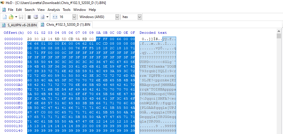

Okay 25 views and no clue...Here's my guess:
I think this is the 0x00A start address of bin the
This is where the last non 00 bit code is:
Is this the proper section of the bin calibration I should cut and copy to the new S_AJUP v6 bin?
Your highlighted area is correct. But perhaps "copy and paste" as opposed to "cut and copy".

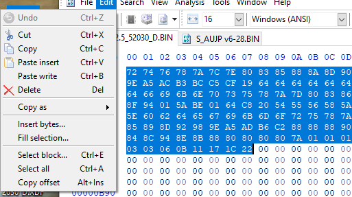

In HxD editor the only options in the "edit" tab drop down are: Cut (Ctrl+X) and Copy (Ctrl+C). The paste option (Ctrl+V) is not active.

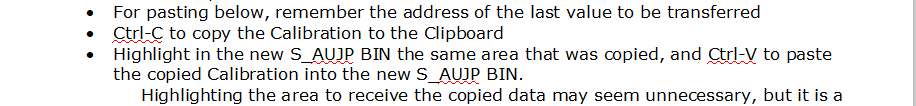

What am I missing? Do we need to edit page 25 in the " Must Read Me First (v-6-2a).docx

I was referring to HxD editor program when the edit tab drops down only (Ctrl+X for cut and Ctrl+C for copy) are active: see screed shot

I see and understand the screen shot, but have no idea. I do not support HxD - merely recommended its use. Does it copy? Does it paste? I see no mention of that -- just that ctrl-v is grayed out. Wish I could help but can't. If all else fails, might try another editor.

No problem with conversion now that you verified that the screen shot of the highlighted areas are correct. Just wanted to point out possible confusion for some noobs when using HxD.
I just figured out that both Bin areas needed to be highlighted in order to have the Ctrl+C AND the Ctrl+V active in the edit drop down.
