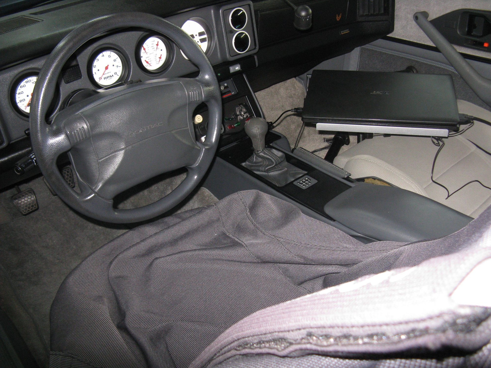

Interesting on the laptop holder... I did something similar. Built a box with the same contour as the seat. Inside the box, yep, an A/C power inverter to allow the laptop to run indefinitely. Also have the WB O2 gauge mounted on it as well. It's an old picture since now I don't have the ECM hanging down anymore. Just one USB cable going to the USB port I mounted.

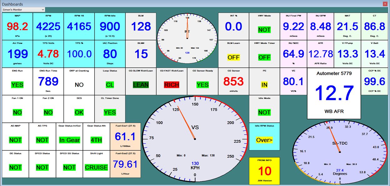

WB is good if you're planning to start tuning for significant modifications. You need to see the actual AFR from the exhaust to know how the engine is responding to modifications. The NB sensor in the ECM is only used by the ECM to trim fueling in closed loop operation that's non-WOT, non-Open-Loop (like cold start), accelerator enrichment (like the accelrator pump on a carb).
During these non-closed-loop operating conditions, fuel is dumped in blindly by the ECM based on pre-programmed parameters in the ECM. It does not look at the O2 sensor to correct any lean or rich conditions. So once you start changing those particular parameters, other than "seat of the pants feel" you have no way to verify what you're actually doing to the fuel air mixture. You can look at the NB voltage output, but it's not accurate once you get significantly far away from 14.7:1.
I run an AEM WB O2 setup. Tunerpro (using the S_AUJP ADX and XDF files) can be configured to see the WB O2 output and report it out to you.
The Ostrich and hte WB O2 are easily the two most valuable tuning tools you can buy.
I run Autometer 5779 because it matched the rest of my dash set-up. I use Tunerpro with S_AUJP version 6 modified for my application. The Autometer 5779 can be hooked to the 7730 ECM for datalogging (using S_AUJP). The sensor is installed just before the catalytic converter. Here's a screenshot while I was tuning WOT from 1800 to 6000 rpm. I am getting the AFR around 12.5 to 12.8 before I get to the dyno session. I was flattening the AFR curve across the rpm range. That is just an example of what an AFR gauge can do. Very helpful for cold start and open loop tuning.
