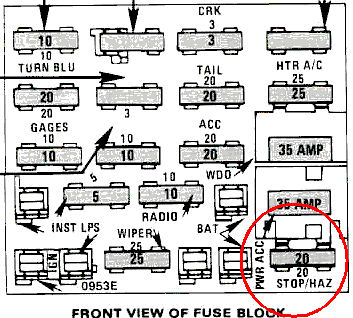

The brake lights are powerd by the 'stop haz' fuse, a seperate circuit from the park lamps.

The fuse panel on the underside of the dash. Close to where your left knee would be. Should be a cover over it and you'll need to be a contortionist be able to actually read the fuse panel.

thanks for the pic...adn actaully circling it..
i didnt think you meant the actuall fuse block...i thought it was an independent fus elsewhere...
thanks again

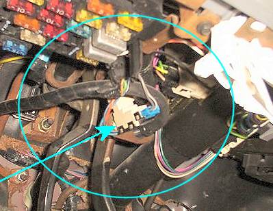

try checking the brake switch, i had some problems with mine a while back

the brake switch?
located?

i do believe its by the brake pedel . kinds up in the dash

yup, take the panal above the peddels down, and follow the brake peddel up till you see a switch (should have 4 wires) thats it, you found it

so its like a fan switch?..
ill check it thanks.
Fan switch is on the engine.
This should help...

thanks for pic..
ill check it out.
and yea i know not under hodd, but meant it was that "type" of switch" relay type.
