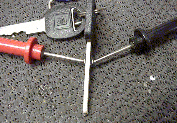

It is probably a broken wire inside the steering column that goes to the lock cylinder. USe a multimeter to measure the resistance value of the pellet, then put the key in the lock cylinder and disconnect the wire harness coming from the steering column to a two wire (black/white & purple /yellow)connector. Again measure the resistance value the wire connector at the steering column. If the value is different, your problem is either a broken wire, bad contacts in the lock cylinder or worn contacts on the key. If the value is the same, your problem is elsewhere in the circuit.

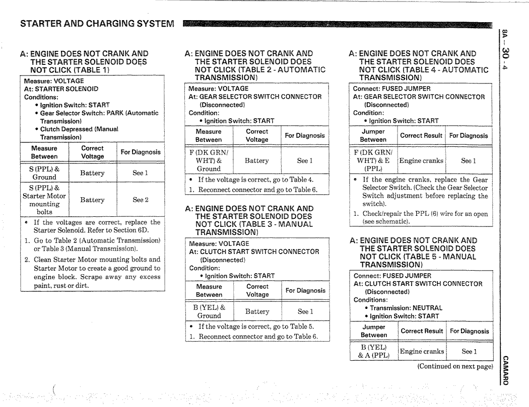

I got your PM a little bit ago an I seem to remember you had another post recently but, I couldn't find it. I have some schematics that I will post here for you to browse over. In the meantime, e-mail me with the specifics of your problem.

schematics
Here are the schematics I mentioned in my last post.

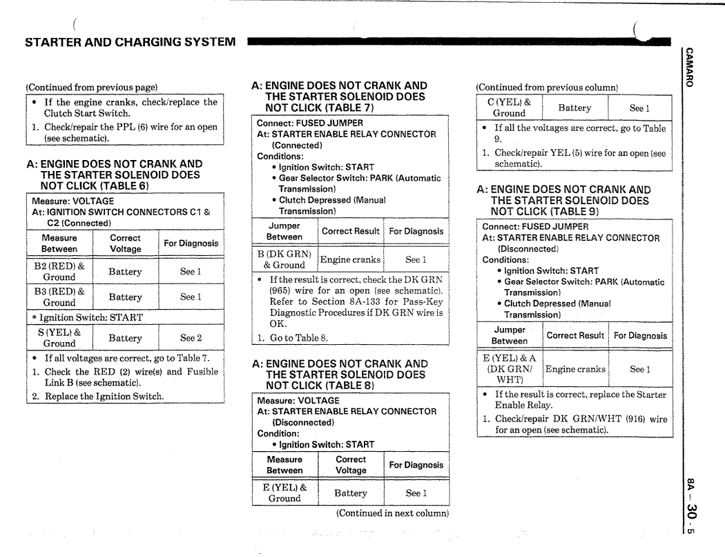

page 2

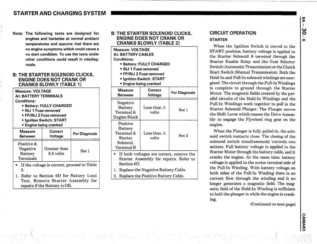

page 3

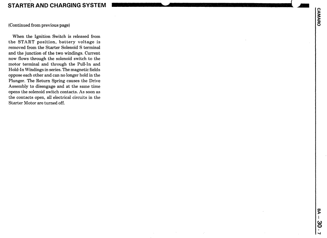

page 4

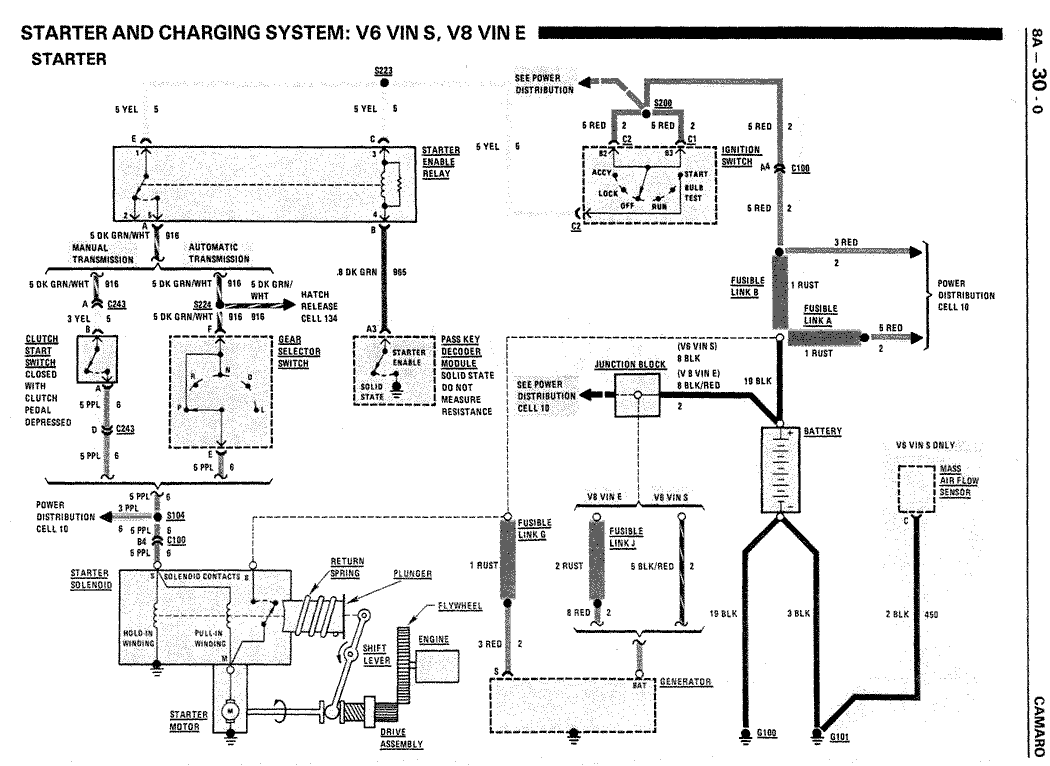

page 5
