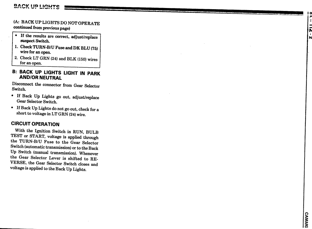

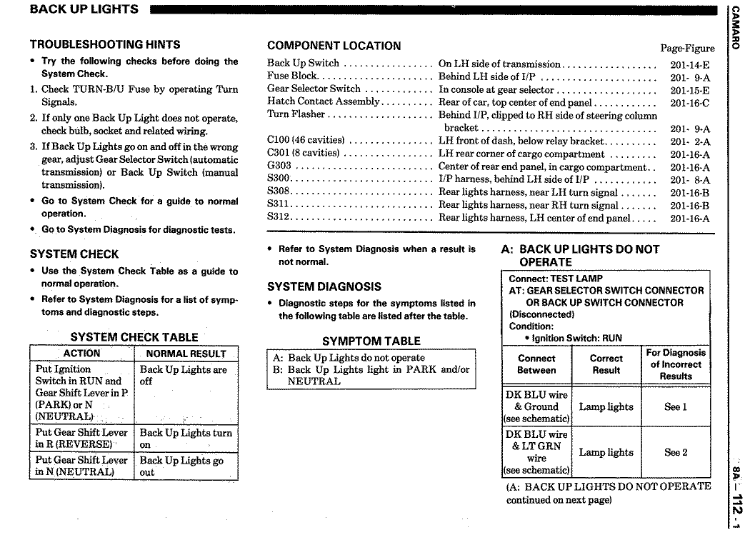

Here you go gentlemen, hope this helps. BTW, please note these schematics & trouble charts are from a 1988 camaro service manual.
Attached Thumbnails Turn b/u fuse-bu1.gif

page 2
Attached Thumbnails Turn b/u fuse-bu2.gif

page 3
Attached Thumbnails Turn b/u fuse-bu3.gif
