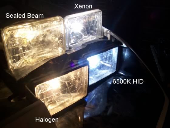

You need the housings to convert the sealed beams to replaceable H4 bulbs and an HID conversion kit for H4 or 9003 bulbs. I've always liked this pic I took:
Some companies make halo housings too:
