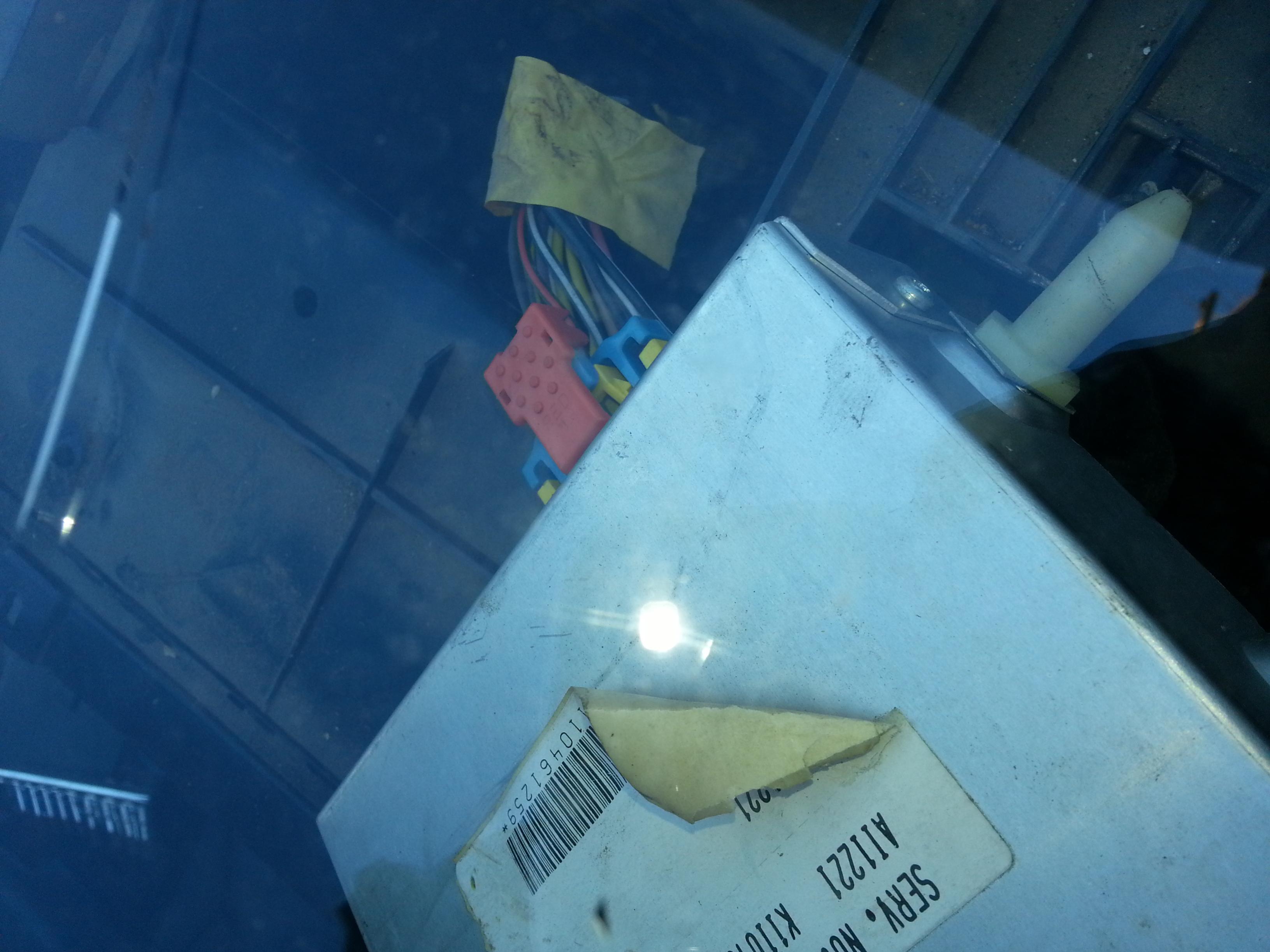

is this my vats module
I'm lost as to what's what

Your 2nd post, pic on the left.

The on where u can just see the connector behind the air duct

Re: is this my vats module
yea that's it. I just ripped mine out yesterday and wired in a bypass module.
