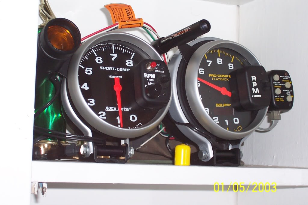

every thing in this pic is now been replaced with Auto Meter ProComp play back Tach. and liquid Filled procomp Gauges.. For under $200..even had them make me a 1 off pro comp liquid filled NOS Guage.. (that was the only thing that cost a few bucks $180)
