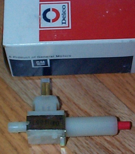

I think I have all the underhood components and under dash components..... but for the life of me I cannot find photos showing where everything should go. I also have seen postings several times that say the under dash harness should be there - but as you all know there is a ton crammed in our dashes. If I don't need the under dash harness, that's great... but I cannot see, let alone find where the connector from the servo harness connect above the column - way too much there. It would be great if someone has a pic.
If I do need to install the under dash harness, can anyone label a pic of where all the connectors would go? and if there are any items that would need to be installed that I might not know about (transmission related?) that would be great too.
One more thing.... would the cruise module mount under the ecm? or next to it? or on the heat/ac duct?

If those photos are supposed to show all the components you've gathered up, you're missing the vacuum diaphragm and throttle cable.

I have the servo, cable and clip too. Looking for notes on the connectors.. That's why I posted the photos. Service manual has nothing. Trying to match connectors to wiring diagrams is.... Well a PITA

You have the vacuum release switch for the CC, but you also need to change the brake pedal light switch to one from a CC car.

Take a look at the brake switch mounted to your car right now. if it has a 3-pin brake switch plug at the top then go with the harness marked 87,...... if it has a 2 wire brake switch plug then go with the harness marked 86.

Again - to be sure; double check the plug currently plugged into you existing brake switch !

I started looking into these things after posting here yesterday,.... I inspected the brake switch plug and cruise power connections of several various Dash harnesses to get a clear picture of what cruise harness is 'correct' for as many ThirdGen variations as possible.
