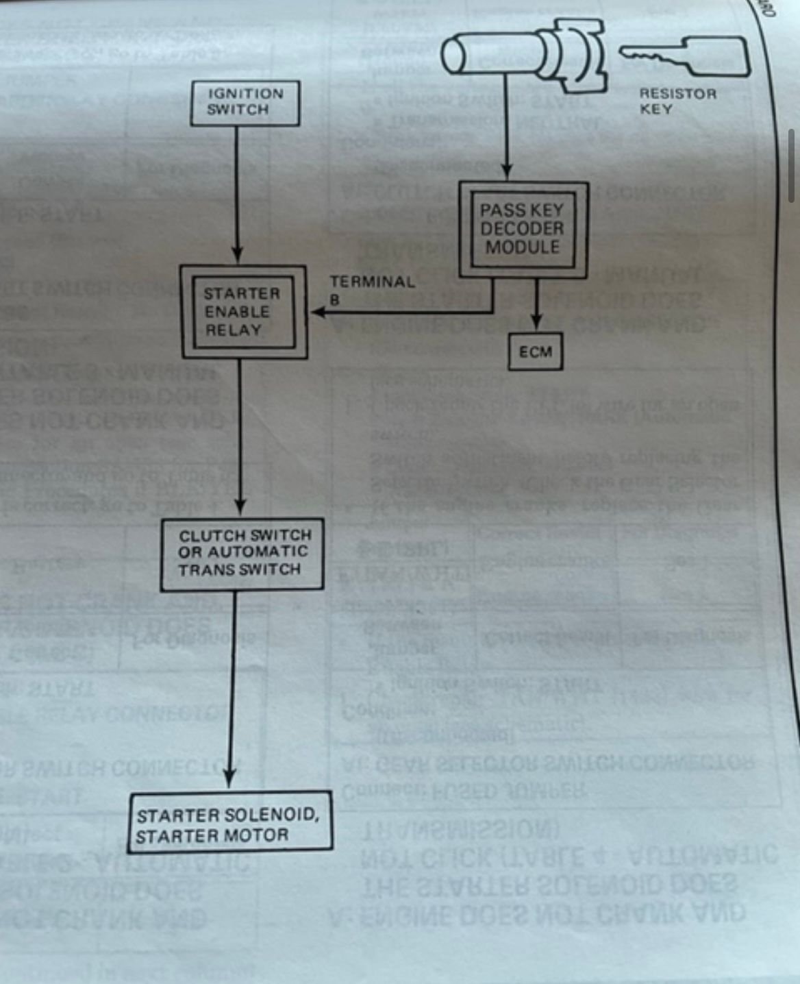

Originally Posted by Derrickd1
I have a 1990 Camaro RS 305 TBI , I am having a no crank No start issue, I have replaced battery, alternator, starter, ignition switch block, starter relay, bypassed VAT with resistors and checked all fuses, and still got nothing?
Is this an Auto or Manual trans car?
When you say Starter relay your referring to the Starter Enable relay I'm assuming? Years ago before I bypassed this relay I had an issue with the relay clicking but not actually closing, I pulled the cover off and the relay was moving but not closing/staying closed with the key/ignition on. You have power going in and coming out of the relay?
Have you checked for 12 vdc at the starter? Purple wire you should have 12 vdc with the ignition on and everything else terminated at the starter should be a constant 12 vdc

Automatic and I installed a new starter enable relay, only thing I bypassed was the Vats with resistors, I will check VDC on starter enable relay purple wire and I am getting 12 VDC at starter

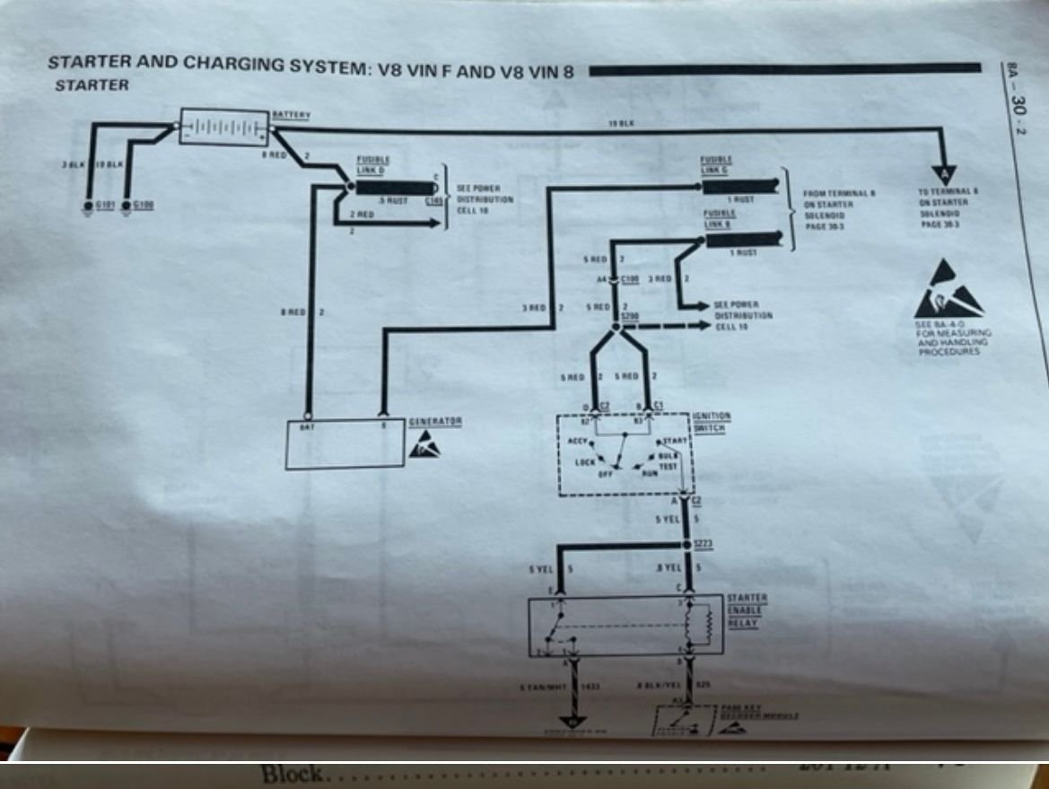

I only have on slot A tan wire , B blk/w yellow stripe, and C yellow wire D no wire, E Yellow wire

I am getting no VDC anywhere with switch on at the Starter Relay, but I was able to start it using a jumper wire from Slot A to an empty Fuse slot in Fuse panel with key in run position?

Would I need to run a 12 V wire from fuse box to Blk and yellow wire to have 12v at starter enable relay?

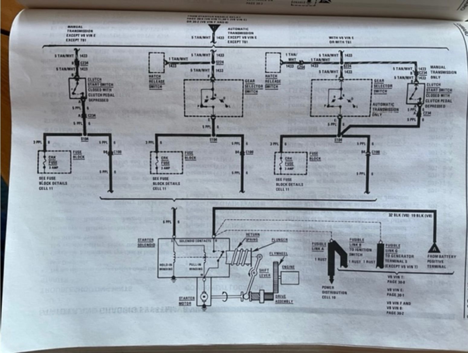

Can you get to your Fusible links at the starter? If you’re not getting any voltage to the starter enable relay voltage at the ignition switch can be suspect or the ignition switch isn’t adjusted properly, the ignition switch is being fed power from the starter solenoid through the fusible links. Check the two red wires at the ignition switch for 12 vdc.
I can get to the 2 fusible links at starter, if that is the problem will I need to replace fusible links?
If there’s no continuity on either side of the fusible link they’ll need to be replaced

if no power while trying to crank at enable relay large gauge wires start at ignition switch.
