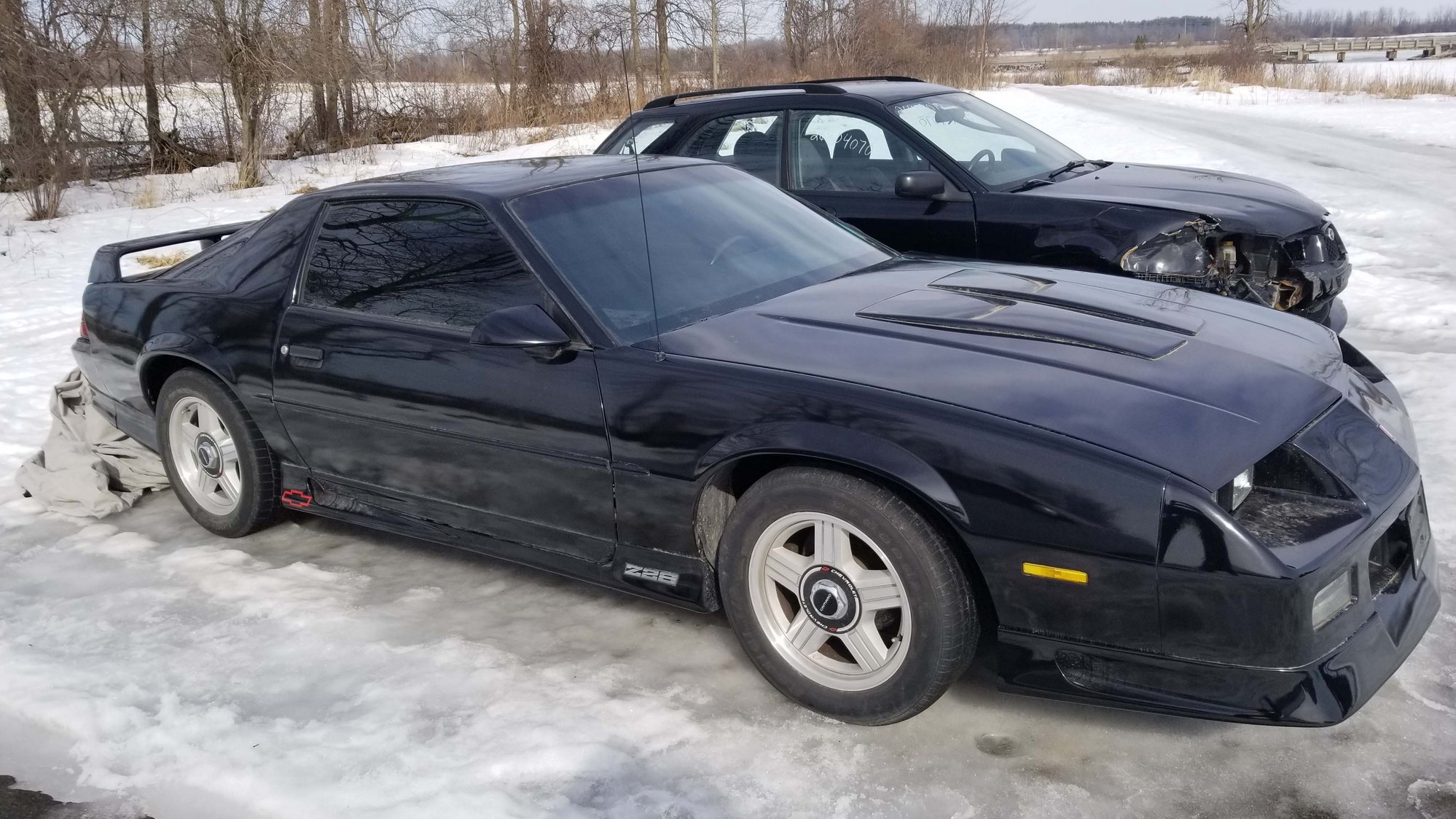

Hi,
I recently purchased a 1992 Camaro Z28, pretty sweet ride. I drove it home and parked it and went out to start it the other day. I was able to crank over the motor but it wouldn't fire. I had a look and I see that the car has a SCS Fail-Safe aftermarket security system, and I can't find out anything about it. There is a small switch on the foot panel for On / Valet Service etc. I switched it to Valet and the car ran for 15 minutes and quit. Then it wouldn't start again, just cranks and cranks. The security LED doesn't flash and it makes no chirp sounds so I think the aftermarket system is dead or close to dead and is messing up the electronics. How in heck do I trouble shoot something like this?
Am I better to try and cut the system out and return just to pass-key security? In reading over the user manual it seems like this alarm system ties into a whole bunch of stuff on the car.
Any ideas? Thanks!
