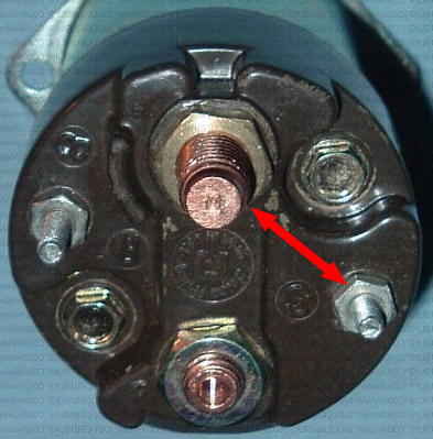

Red (hot) to Yellow will engage the starter (and she turns over and sounds healthy which makes me excited)

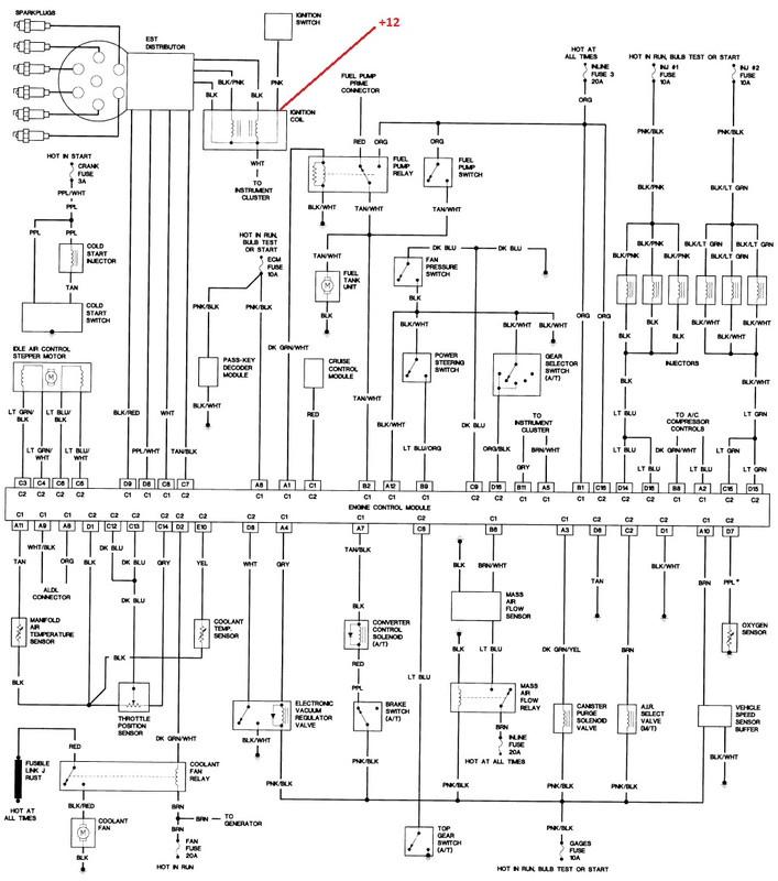

Red (hot) to ????? will excite the ignition and let the plugs fire off?
Red (hot) to ????? will run the fuel pump?

Trouble is you need to jump several wires that the ignition switch connects. People don't hotwire thirdgens, they break the column to force the rack the ignition lock turns.

I think this will work (it used to work in the old days) but it won't stay running. After sitting for 15 years, I doubt it'll run in it's current condition even if you had the key.
1. Plug in all the stuff you previously unplugged.
2. Remove the air ducting from the throttle body.
3. Run a jumper jumper wire from the positive battery terminal to where the pink wire plugs into the coil. You're feeding 12v to the coil primary winding, by-passing the ignition switch.
4. Make sure the transmission is in Park/Neutral.
5. Reach down to the starter and connect a remote starter switch or jumper the terminals with a screwdriver. This will crank the engine over.
6. While the engine cranks, have a helper shoot some starter fluid into the throttle body. If it's going to run, it should start and run as long as the shot of starting fluid lasts.

It's a fuel injected car. Without powering the computer, it's not going to run. That's why I suggested putting it back together and just turning the ignition lock like every tow yard and would-be car thief.

The fuel pump is going to be trashed. So if there's even a chance you will need to rig up a fuel can with a drop-in pump. The fuel tank isn't going to be any kind of good and the pump will be rotten. I've been through this twice with cars that have sat for 10+ years and in both cases they REQUIRED a replacement tank, pump, pickup, etc.
