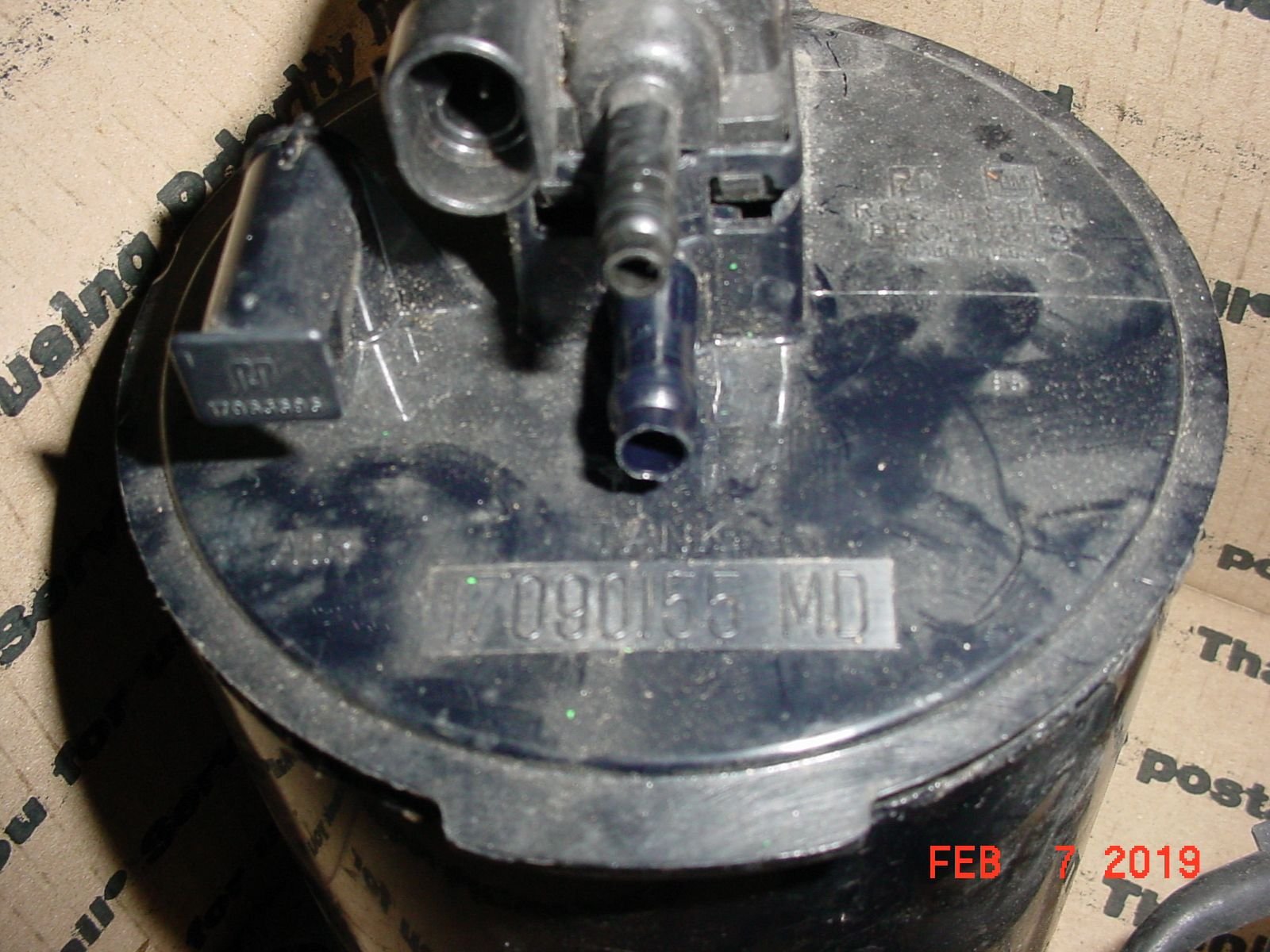

Old Feb 7, 2019 | 11:08 PM
6998poncho's Avatar
Posts: 62
From: Santa Maria, Calif.
Car: 1998 Firebird Formula M6
Engine: LS6 installation finished 8-17-2011
Axle/Gears: Stock 3.42 Ratio
Re: 1990-92 TPI Canister Purge Solenoid
Like this one?
Old Feb 8, 2019 | 07:58 AM
rt66er's Avatar
Joined: May 2012
Posts: 443
Likes: 117
From: Arcadia, OK
Car: 1990 Pontiac Firebird Formula
Engine: L31 350 TPI
Transmission: Tremec TKX
Axle/Gears: 3.23 Posi
Originally Posted by 6998poncho
Like this one?
Yeah, do me a favor and blow into the top port on the solenoid. Is it restricted or can you blow through it?
Old Feb 8, 2019 | 08:50 AM
6998poncho's Avatar
Posts: 62
This one came out of a car that probably had less than 20K on it before it became salvage and I stored it. And I used a can of spray air on my first test and it seems to me this is a closed port until it's electrically activated. It seems closed to me as is.
Old Feb 8, 2019 | 05:10 PM
rt66er's Avatar
Joined: May 2012
Posts: 443
Likes: 117
From: Arcadia, OK
Engine: L31 350 TPI
Never mind, I don't need one after all. I was getting a false positive reading on my DVO meter. My electronic tech friend explained how it happens. The solenoid I have appears to be okay after all. Still doesn't explain my factory service manual showing a NO solenoid.
Sorry for the trouble.
