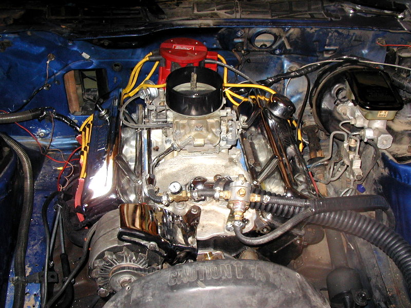

the bracket I use bolted to the waterpump and the intake mnifold.It held fine for the year I drove it on the street befor I swapped in the 406.Here is the typ Of btacket I used . I used it on the 406 as well.

Ibelieve it cost around $20. The hardest wires to find are in the loom coming from the drivers side...there is a Fat pink wire along with a smaller tan brown wire these go to your distibutor (Positive and tach). You need the alterator wire, the starter wires, I had to lenghthen them some. Dont forget the ground strap at the back of the motor from the firewall. If you are coming from fuel injected you will need a fuel pressure regulator, Like the malory you see in the picture.Chances are your fuel pump wont run beyond prime....some do .some dont. If it doesnt you will have to rewire it up.
