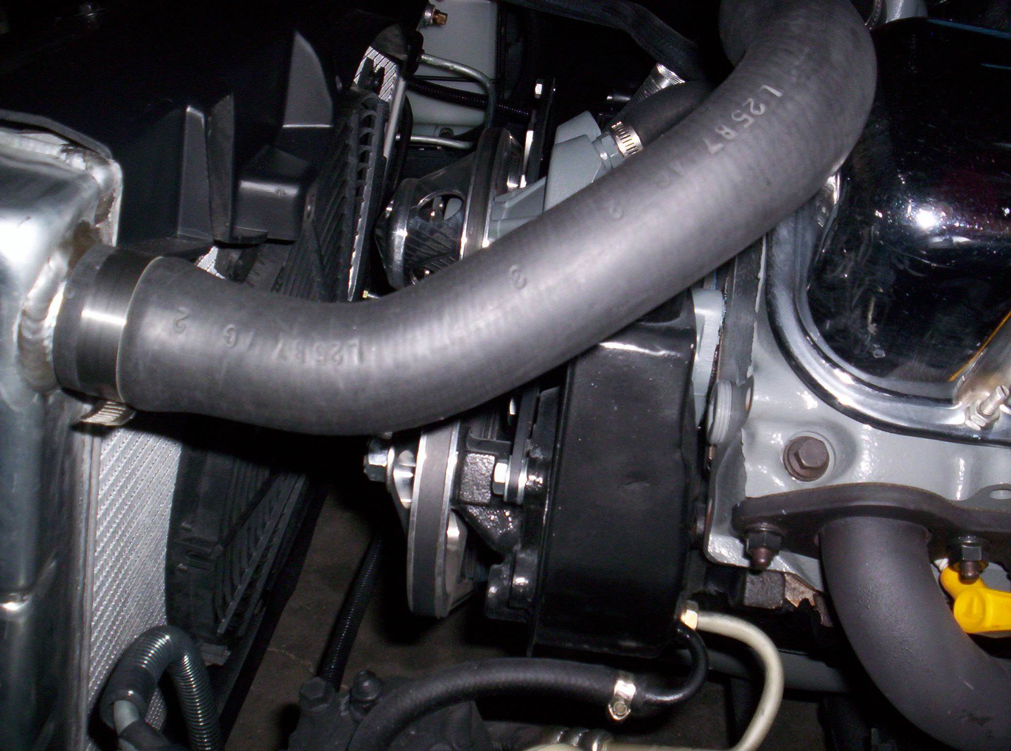

Ok, I've had quite a few PMs on the accessory brackets. I used the Alan Grove mid mount alternator bracket (I thought the mid-mount looked cleaner) and I used the Alan Grove PS bracket for long water pump.
In order to clear the steering box, the PS bracket had to be slightly modified. I drilled an extra upper hole and pivoted the bracked up (see 1st picture). This gave plenty of clearance for the pump pulley (see 2nd pic).
The pulleys are all Billet Specialties (big block long water pump).
Attachment 160147
Attachment 160148
Exactly what I was looking for!!!..Thanks a ton!

Glad to help. The rear of the bracket is just like the front. When I drilled the new hole, I clamped the two pieces together in a vice and drilled them stacked together to ensure alignment front to back.
