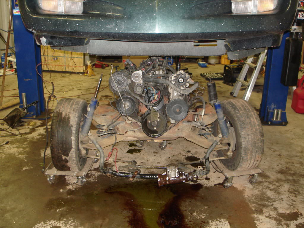

Unplug the ECM, and C100, disconnect the trans lines, disconnect the coolant lines, remove the radiator hoses, unbolt upper strut nuts, disconnect the front brake lines, remove Y-pipe, unbolt crossmember and K-member
Lift the body off the whole front suspension. Took me about an hour. No reason it should take more than two
Going back in was simple too, just reverse order. Use the front wheels to roll the assembly around. I had access to a lift, but a cherry picker can be used in the same fashion
