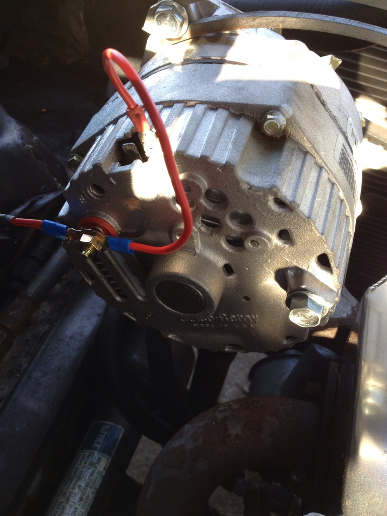

i just got this alternator, will it work?
the correct way to hook it up?

yes that is a 10si it will work, looks like its clocked ok that the terminals will be out of the way. Large post to the battery, number 2 to the fan relay there should be a brown wire originally going to the alternator. number 1 would go to the mil lamp through a resister if you chose to hook that up. Number 2 is a switched power to excite the alternator. If you want a true 1 wire you can install a low tun on exciter.

Well I'm doing it as minimal as possible. The car has no wires left in it . So basically power to battery. Someone told me to jump the 2 post to the power post?
Here is the new one. It looks like its charging!
