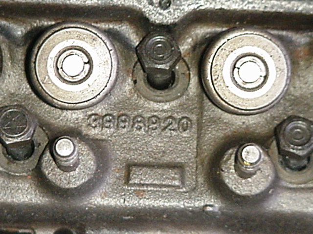

3888920 is the casting # they have been all redone ported valves screw in studs guides cut for big cam i have 1.6 roller rockers comp roller cam is 224 dur 502 int 510 exh lift

I'm not coming up with anything on that number. Could they be 3998920? Sometimes hard to tell the difference between 3, 8, 9 in those cast-in numbers.
For example:
From: https://www.thirdgen.org/forums/tech...251-heads.html
I'm afraid I would put them squarely in the 90% class. Especially if they are 76cc chambers.
They will have soft exhaust valves and seats unless they have been upgraded (expensive). Not good with today's unleaded gasoline.
You may get along okay with them, but I certainly wouldn't put any money in them (which is appears is too late in your case).
For example:
they are 3998920

I don't have specifics on those heads, but truck heads typically don't benefit from lift over .45". So, your valves will move through that last .05" of travel without any increase in flow.
What are you going to use for an intake manifold? Your stock TBI won't bolt on without modification to the center two bolt holes on each side. And, it wouldn't support a Hot Cam very well at all. An '86-earlier style carb intake will bolt up, though. You can use a TBI to carb adapter if you stick with TBI.
