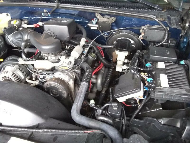

ive got a vortec truck engine too
just pulled out of this truck,look how god level clean this baby is.truck now has a 383,that was the only reason the motor was pulled.

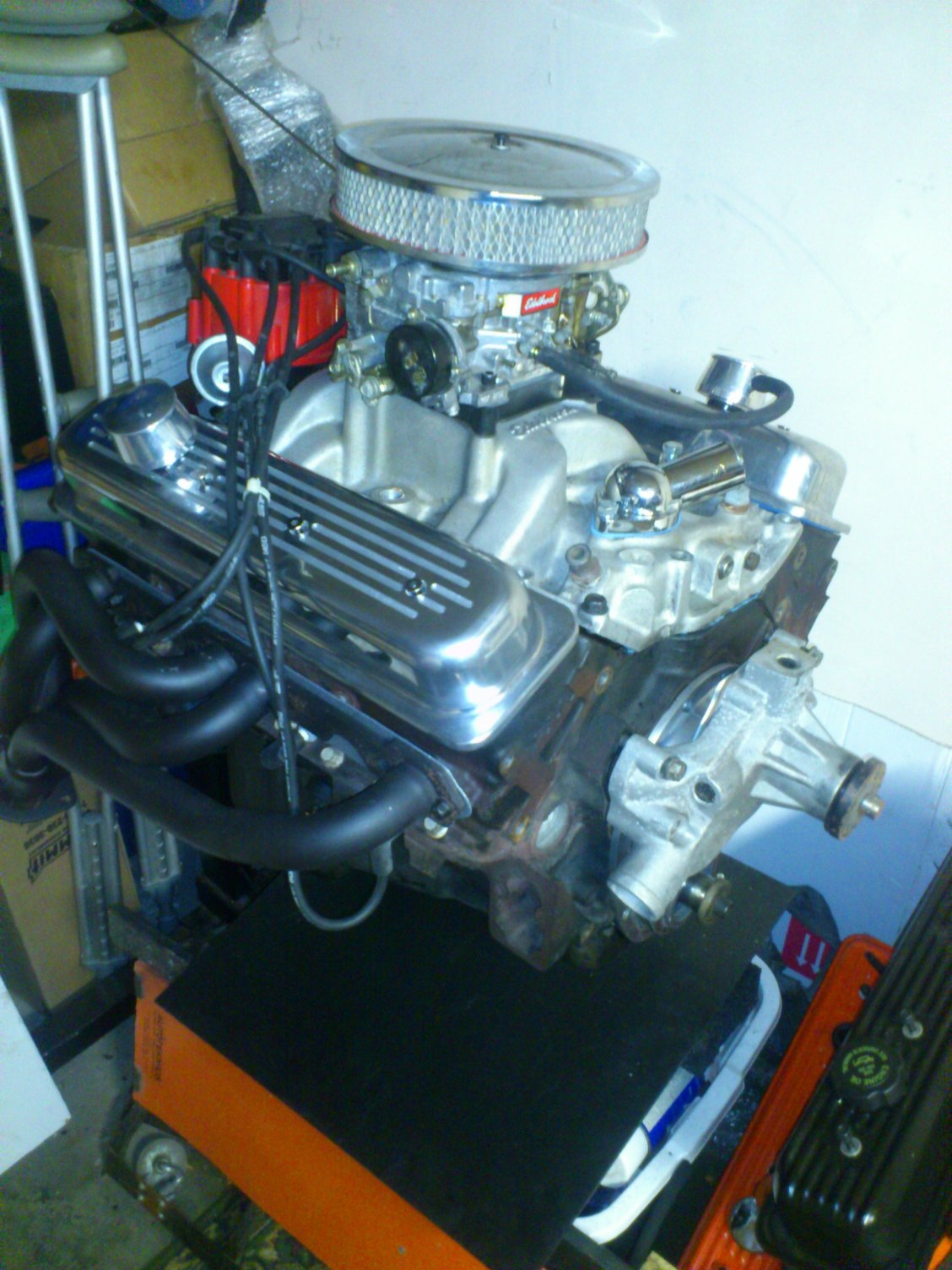

here it is on the stand,im waiting to pick up some comp cams retainers so i can put my new cam and beehive ls6 springs in.it will be virtually identical to the sp350/357 horse crate engine with the cam i have.(i pity my poor t5-might have to go automatic if i cant find a good t56-tko under $3000)i have a nice holley ultra 650 double pumper-mech secondary,not using this edlebrock carb junk.this is the cam i picked up.perfect for a set of beehive ls springs.
  • Camshaft Type (P/N 12677151): Hydraulic roller
  • Camshaft Lift (in.): 0.473” intake / 0.473” exhaust
  • Camshaft Duration (@.050 in.): 215° intake / 223° exhaust
also just scored a set of ceramic coated hooker headers(mid length)they are on my L98 right now but im putting them on this engine.
everything ive got so far has been used(other than the flywheel),the cam was pulled out of a crate engine because the old fella said it
was to lumpy(perfect for me,thanks)i dont know how anyone can buy everything new,my family would starve and we would be homeless,lol.

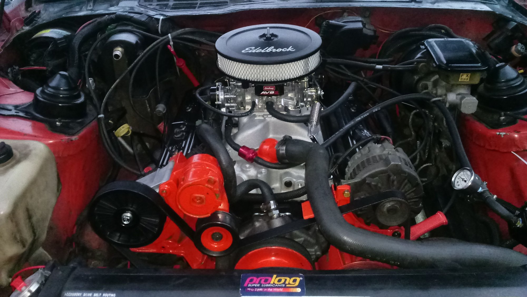

headers and exhaust make a difference too. I went with Dyno Don's, large primaries down into a 3: exhaust. Most headers are too restrictive on a 350.
My L31 is stock too for now. I do have an air carb gap intake on top.
I bought an 83 Z28, red with t-tops from Arizona. No rust! I live in New England and most are rust buckets...
I need to swap my flexplate out to lineup and will be good to go. cracked into it tonight, placing an Amazon order to get the flywheel for this week, 2 day prime shipping baby!
