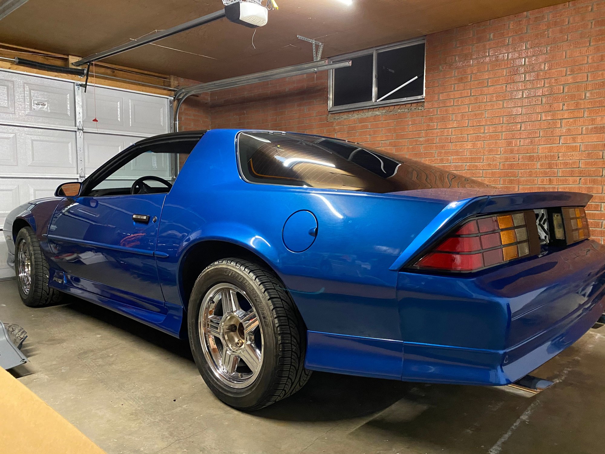

Hello everyone,
Im looking for some suggestions of what route to go with my new project. I just picked up a 92 RS that will eventually be my daughters first car, she will be able to drive in 30 months. It was originally equipped with a L03, 700R4, front disk, rear drum, and a open 2.73 read end. The PO swapped the L03 for a carbed 350 from an older vette which he said never really ran right. I did get the original L03 With all the accessories as part of the deal which is said to have 113k+- miles and was running when removed.
I’ve always been a gear head but over the years have only don’t basic maintenance to fix them when they break. I am looking forward to getting more in depth with this project by building a motor, upgrading trans, swapping rear and, etc.
I have plenty of money but would like to keep it budget hot rod oriented because when I was 16 I didn’t have a bunch of money to fix up my first Camaro and at any time it could meet its demise with a new driver behind the wheel. I plan on doing a long tube headed exhaust system, beefing up the 700R4, upgrading brakes, suspension, rear end, etc.
The car needs to be able to pass emission sniffer test so the carb has to go. I also need to have a working A/C (currently does not have one installed). My plan is to do some basic research and diagnostic of the motor that is in it now. Then determine if I will be keeping that short/long block and just changing the intake or getting rid of the 350 that’s in it and the spare L03 and starting from scratch with a new build. I don’t want a vortec head motor. What would you do in this scenario? I’m looking for suggestions.

I literally just got the car home so I need to trouble shoot to figure out what’s wrong with it. To my knowledge the emissions test locally is a sniffer and visual inspection that there is a cat but I will double check that. Another possibility is registering it outside of my county because the rest of the state does not have emissions testing. Might have to jump through some paperwork hoops for this but that might be easier than the mechanical hoops. I guess going vortec would be fine if it’s the easiest route. And the TBI stuff looks like it is still there.

I checked a bit and I believe for 1996 and older emissions test in my county there is only a sniffer and visual that there is a cat.
The air cleaner that’s on the motor right now doesn’t fit under the stock hood. The hood stops on the front are turned all the way up and there is a gap between the hood and the nose. Is there a specific intake/air cleaner combo that will clear the stock hood?
