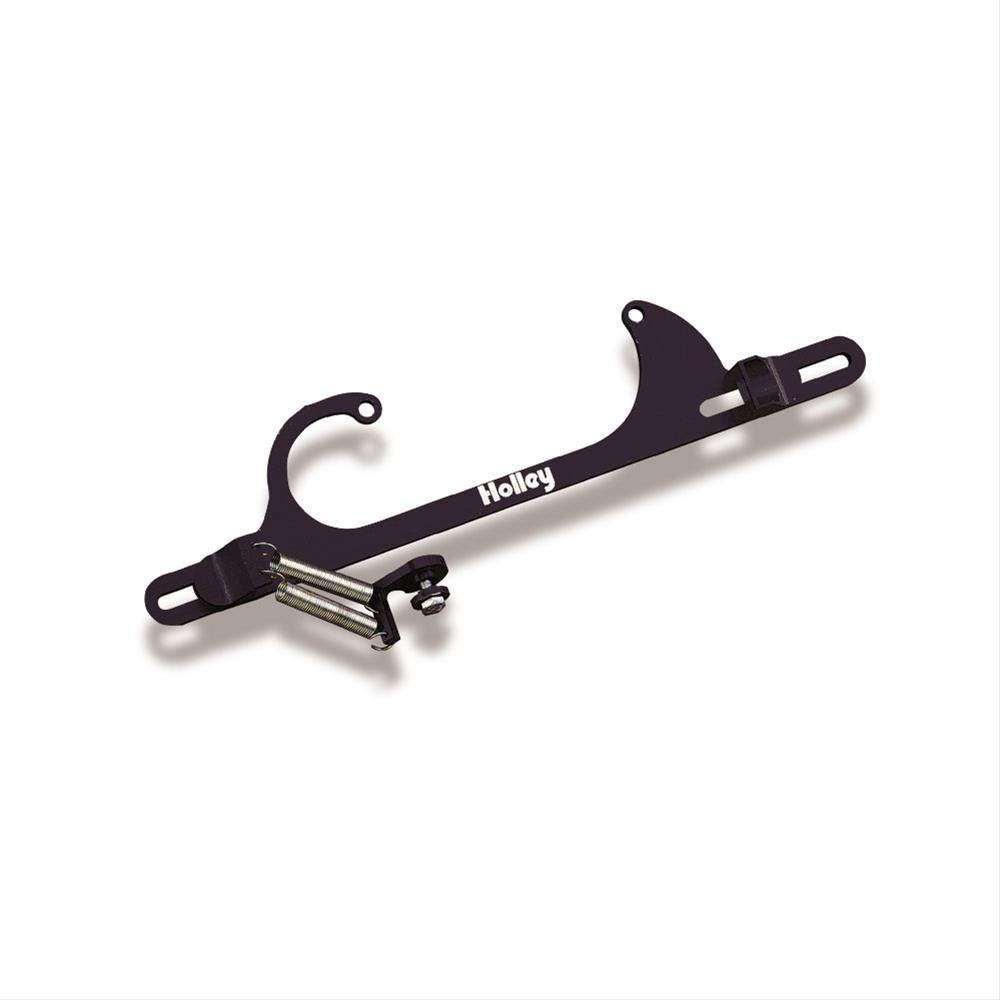

I do not believe that there is an aftermarket bracket that is for all 3 Cables (Throttle Pedal, Cruise-Control, and Throttle-Valve/ Transmission).
I personally used a Summit-Racing branded version of this bracket in the image below:
Along with an attachment for TV-Cable type Automatic Over-Drive Transmissions (THM700-R4 and THM200-4R):
