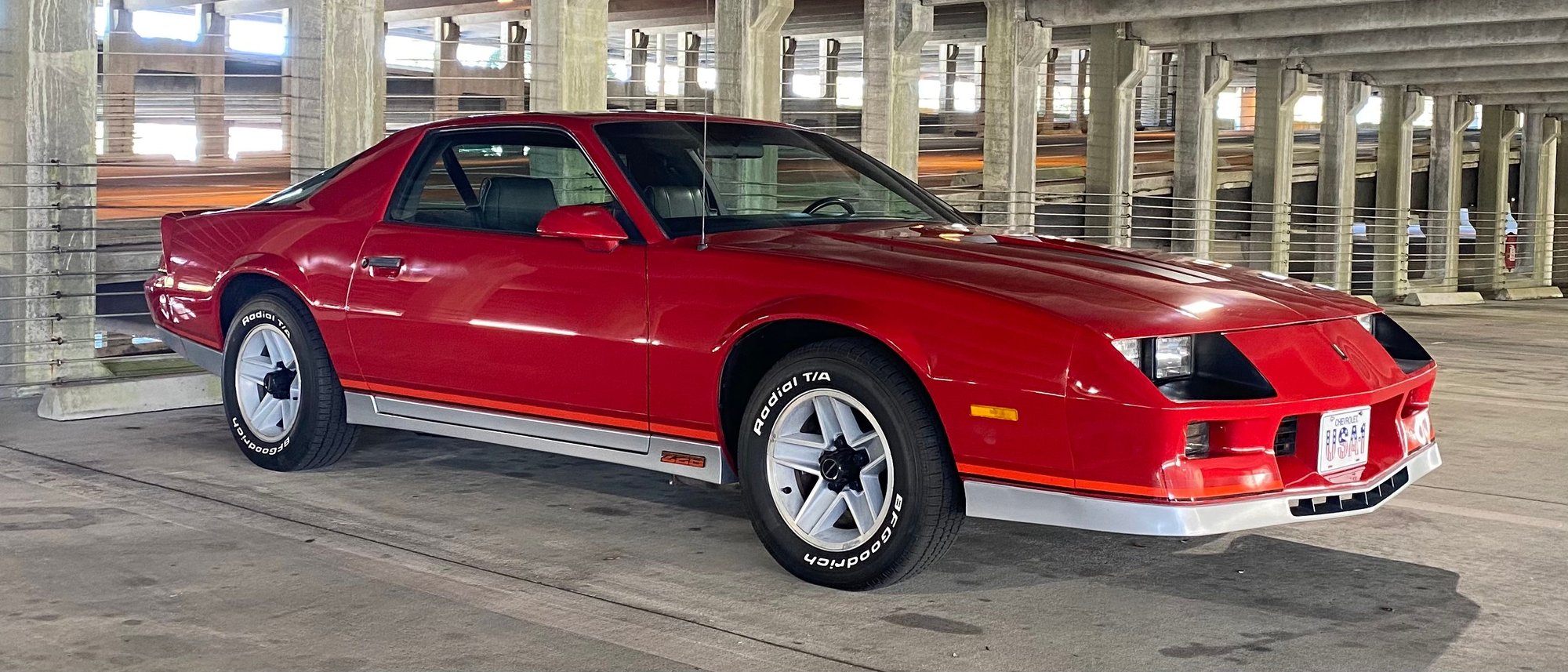

Looks good. It's not 83 feet long though...

Looks like a pretty darn nice car in the picture.
It's as if the picture was taken in October 1983. My '84 never looked as good.
pic was taken just a couple weeks ago. She is in almost showroom new condition. 44k on her, matching numbers all stock.
